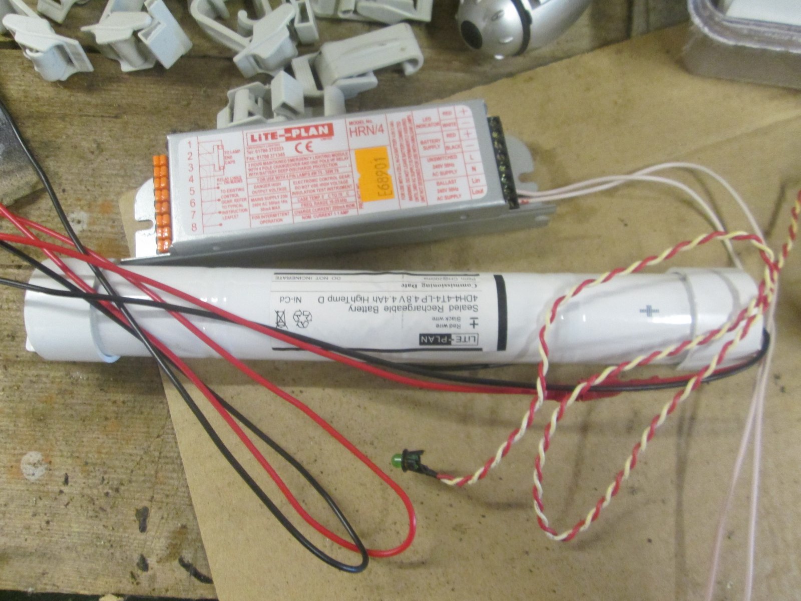

    I`ve acquired two more lights but these are those emergency back up lights. They have four wires, (brown, blue, green/yellow and black) a tridonic.atco pc 1/58 t8 pro digital ballast, a lite plan HRN/4 emergency module and a battery.
    My question to any electrickery experts is, can I remove the battery and emergency module and rewire it to just use the ballast like on a normal light? Can I then wire them into the existing lights or should I have them on a separate switch?

  5. Simple answer - yes (in theory) you could, but no you shouldn't. They are designed to charge off the mains and run off the battery in the event of an electrical failure. Why not just get some more cheap fluorescents if you want more light ? Hardly seems worth the bother...

    I had a chat with one of the shift sparkies this morning, funnily enough, his nickname is Timmy Two Wires.

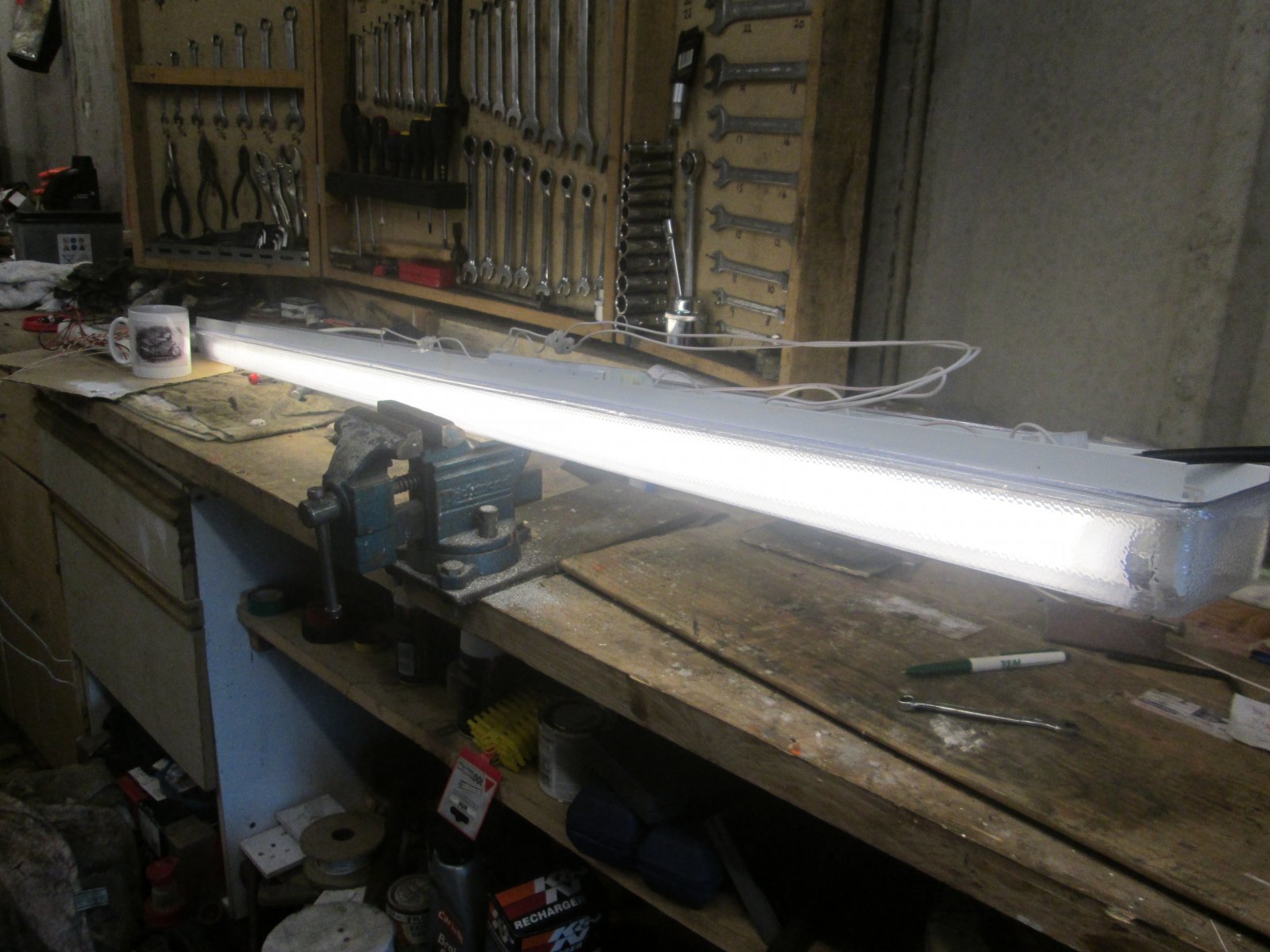

    He said what I wanted to do was the best way, remove the battery and emergency module then a little bit of rewiring and jobs a good `un. He said a quick bodge would be to cut the battery wires then put the black and brown wires to power and it would work, but bodging is bad.
    I bench tested the light and it now works.
    The bits I removed might be worth putting on ebay, get a bit of petrol money maybe.
