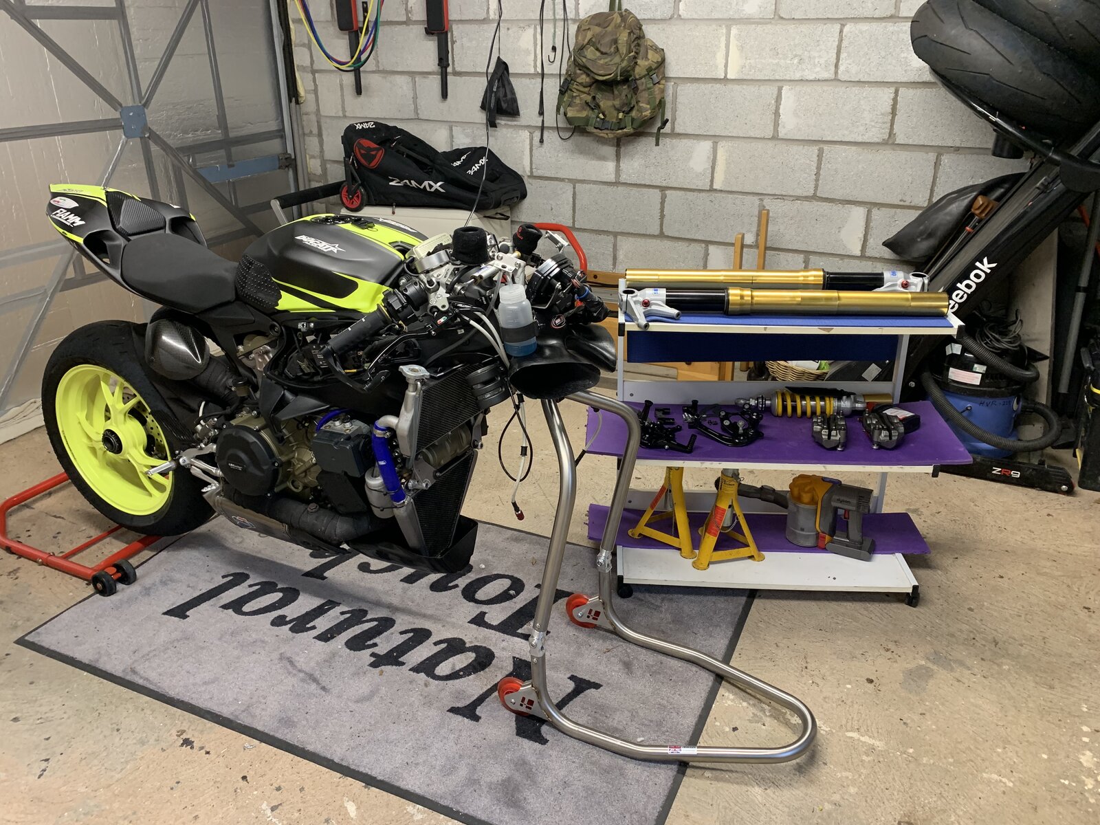

  17. And there off… I wonder how expensive I can make what could be a simple Andreani revalve! A4B349A8-A5B1-4568-BB36-1F979090D989.jpeg
