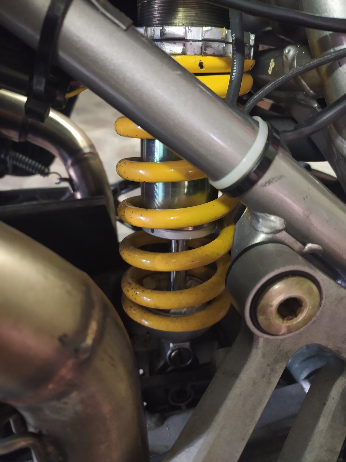

  1. I need to adjust the rear shcok and forks on my monster 620, there is not enough preload (I'm 95kg)

    On the rear it’s the usual ring spanner. Depending which shock you may have both comp and rebound or a one screw amends both.

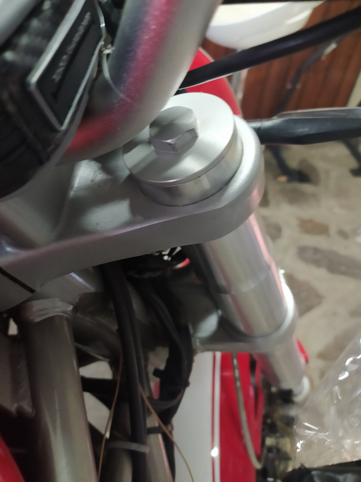

  10. Not all the Monster 620's got adjustable forks. No preload, or damping. Rear shock has preload and possibly a single adjustment for damping. Get a picture up of the fork tops if you're unsure

  12. So single adjustable rear and no adjustable front. You need to mess with the inside to do the grant, it’s easy enough even I can do it on those!!
    If you ramp the preload rear up it may stop it, Seles. How soft the spring is.
    You can do yourself but it’s just harder. Looks like you may have quite a lot on the rear anyway, but you want the collar to go down. Just add say 5mm down, which is quite a bit, then go ride it and see what it’s like if you do it on your own
    I’d strongly recommend changing the spring tbh to a heavier one. It’s a diy job but you need some kind of spring compressor to put back together. And make sure you don’t lose an eye when taking the collar off it you do ;)

  16. As Bradders has already said.. the forks are non adjustable, so you're stuck with them other than chaning springs and maybe thicker fork oil. Decreasing the air gap will firm them up towards the end of their travel a bit as well.
    The shock is the single damping adjuster with preload. The damping will affect things as you hit a bump, screw it in to firm things up a bit. The preload wants winding up so you get about 30mm sag with you sat on it. Get some help and lift teh rear of the bike. Measure from the axle to a fixed point on the seat unit. Then sit on it, bounce a few times and them take the same measurement. Wind the spring in or out to get your sag.

    the rear shock preload was at 168 cm, the manual calls for 157, so i increased the preload to around that. and i'm gonna go on a test drive in the evening.
    i'm guessing that was my issue? the shock compressing too far down causing the pipes to touch the ground, so by increasing preload it should be stiffer and not hit as low if i'm right?

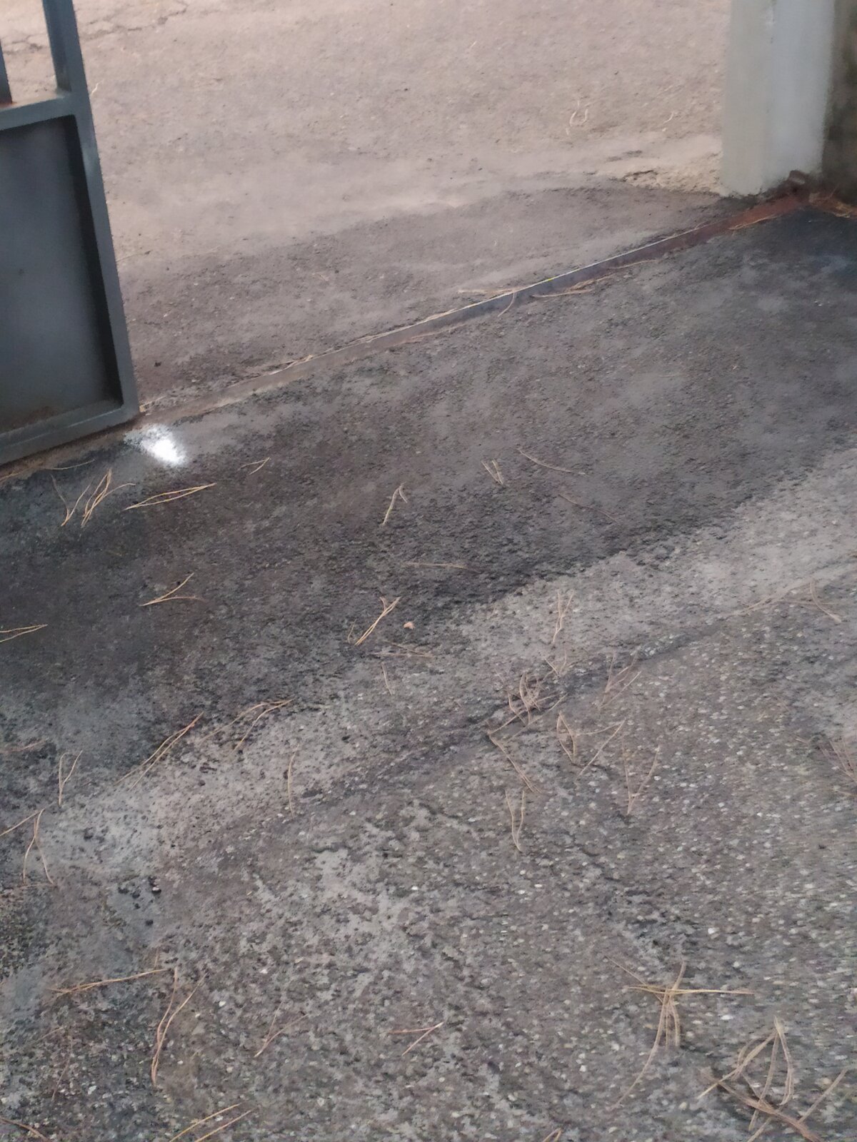

  19. Here is a bump that I always hit the pipes with. It's not harsh because I'm going at like 5km/h when I hit it, but I can clearly something hitting
    And yep, after turning the preload 2 turns, the issue persists, should I try preloading even more?

  20. That could easily be because the middle of the bump is high the side the wheels are on is low.
    Does it wallow badly when cracking on with bumpy roads?
