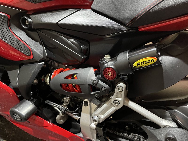

  1. Had my 959 for a few months now, not long after getting the bike went to see Paul at Racelab in Bournemouth to have the suspension set, he did a great job with the stock setup, but being 120kgs (I'm 6'5") even at max pre load on the standard springs we couldn't get the sag anywhere close to where it ideally should be.
    Picked up a K-Tech shock last week which was a doddle to fit, have just had a Matris BPF 959 upgrade kit delivered so the forks need to come off. I'm taking them down to Racelab again for a service and to have the new pistons & springs etc fitted.

    Rear spring is a 90, fronts are 11n/mm, which I think is just under 1.1 in kg's.
  11. I'm sure a 90 spring on the rear is for someone tiny. I'd look into that.
  12. Standard for the K tech shock is 80…

  17. This is the guide I use - you are 264.5 lbs - assume that’s geared up? If so then you are at the very top of the weight range - you do have the standard 959 progressive linkage so you might get away with a 95 if you prefer a softer ride but for track I would say 100 would be better. I would say the same with your fork springs - they are stiffer than standard but maybe not stiff enough for your weight on for track. Under hard braking on track I could get close to bottoming out those springs and I’m nowhere near as heavy.

    Spring rates he reckons for the Matris fork kit and K-tech shock on the 959 (and my weight) are good. Be a couple of weeks before its serviced and all back together :)
