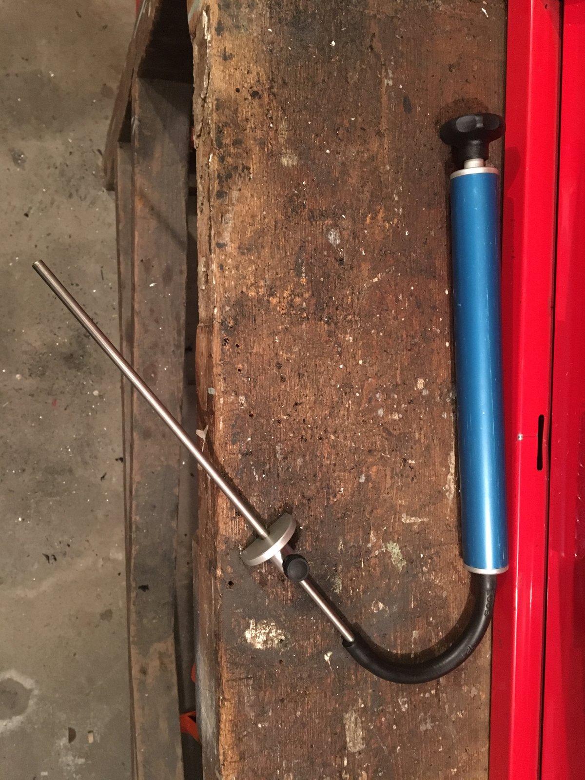

  2. Hold on a sec... I’ll go and grab my tool!
  3. The main tube is about 20mm ID and the small tube is about 4mm ID
  4. It’s a Ktec one

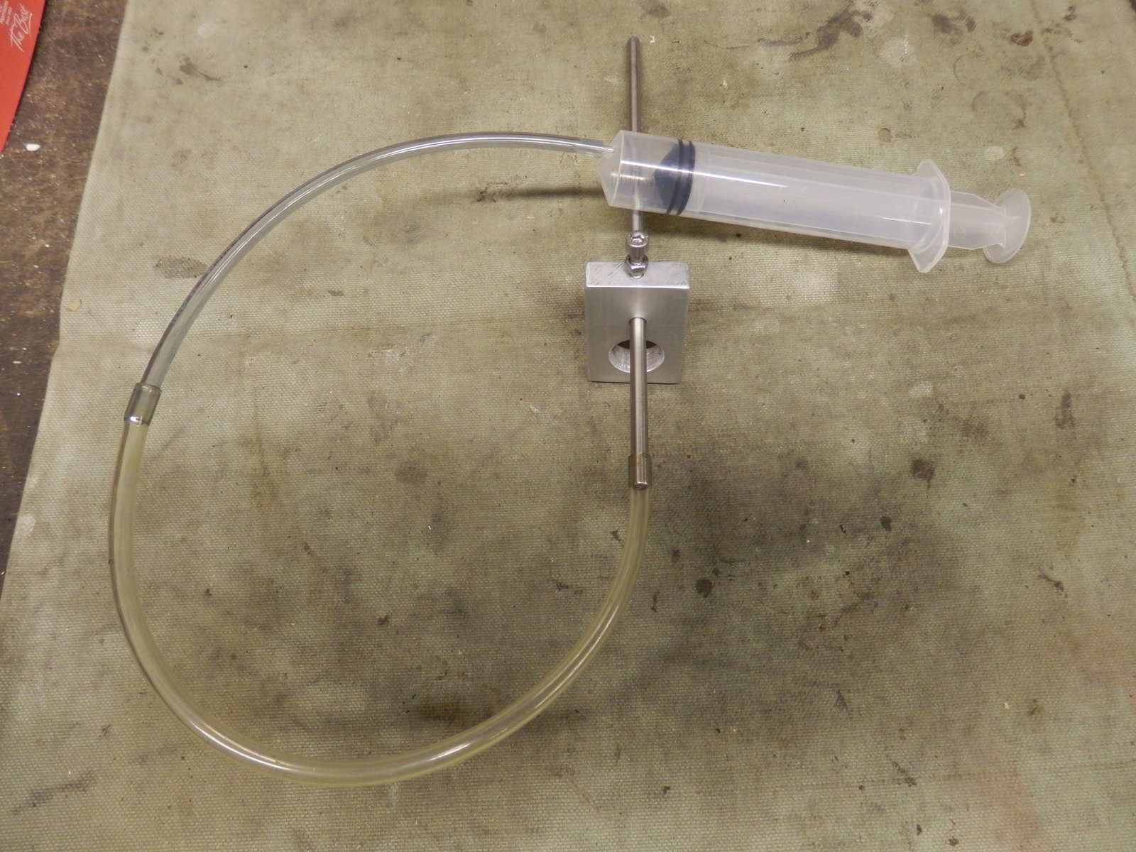

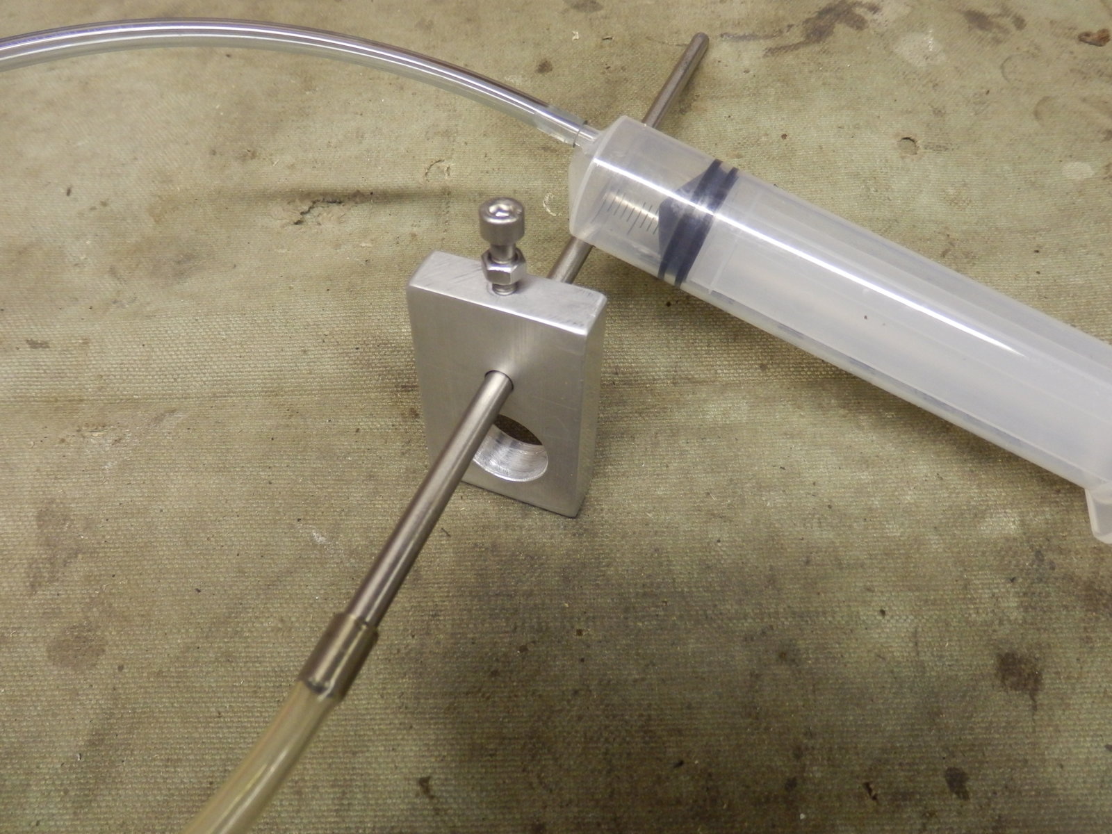

  6. Finally got some time in the garage today, one of the things I did was knock up this tool from scrap I had laying around.
    Nasher
