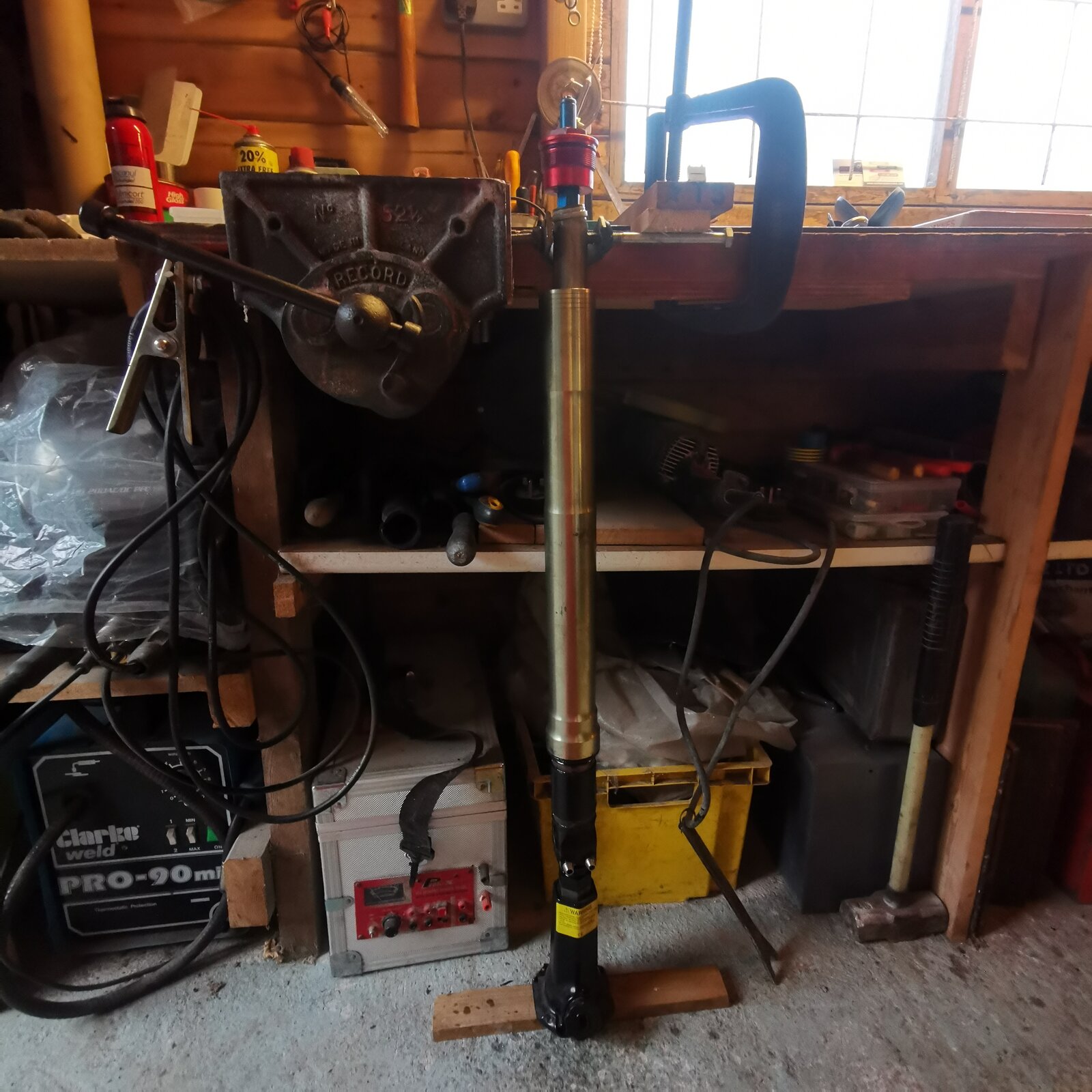

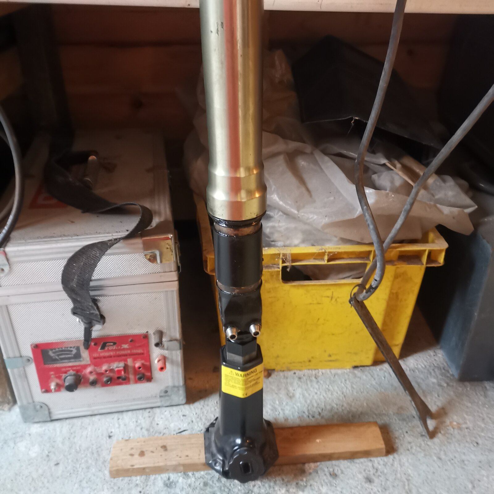

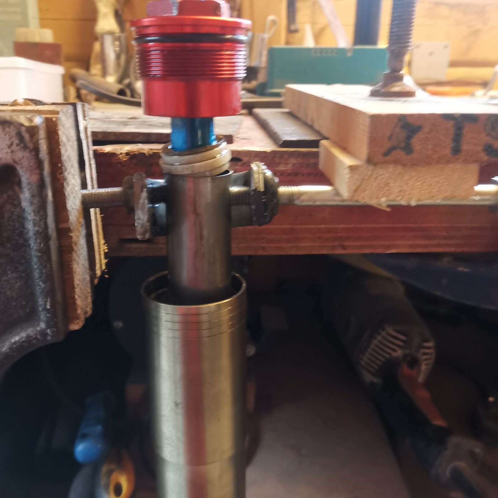

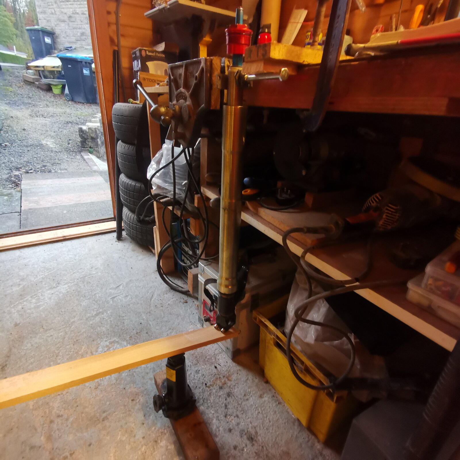

  5. Whipped the forks out this afternoon, made a simple spring compressor, then looked at ways of single handed disassembly, easyest way was to hold the spring compressor in the vice fastened to the fork tube and lift the bottom of the fork, I tried two methods to lift, first was with a jack but the easyest was a short length of wood as a leaver pivoted on the bottle jack, this made it very easy to compress the spring and still have two hands to undo the top nut.

  6. It looks like you’ve removed the bottom of the forks as well, ie the bit the stanchion is fixed in and to which the brake callipers bolt; have you? If so how? TIA
  7. No I Havnt Paul, just the way they were when i took the picture, the calliper mountings must be to the rear out of sight.
    Steve
    Just looked again and they can be seen in the last picture.
  8. I’ve just never seen black ones and then the heads on the pinch bolts are unusual as well, that combined with viewing the pic on a phone is my excuse:blush:
  9. Both forks now stripped down, really easy with the leverage method, no need to slide the split washer in to hold the spring tension, just hold the pressure with one foot and you have both hands free to remove the top cap, no sign of wear in the bushes whatsoever so I am inclined to just fit the seals.

  11. No one's noticed I managed to get the bin's in the pictures.

  13. I did and you've a couple of shagged out tyres sitting there as well.
  14. Face palm is one of my favorates.
    The face palm was for me leaving the wife in the shed with her foot on the lever, yes the tires are knackered, just saving the rims really.
