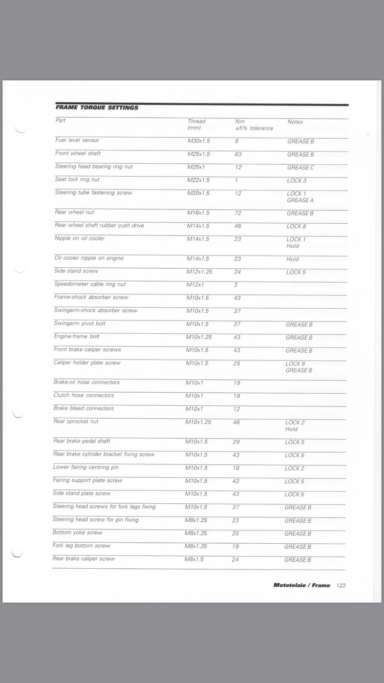

  1. 1000SS, - can someone oblige with the bolt torques of the top clamp, lower clamp & axle pinch-bolts please.?
    I'm not sure how many other models share the same fork, 43mm Showa.

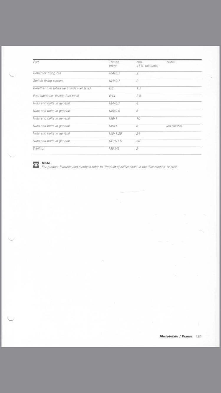

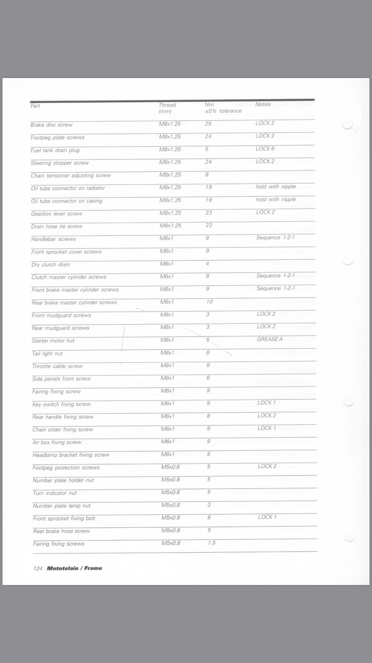

  2. If nothing particular for the 1000 comes up, here are all the frame torques for the 2002 900SSie. I would assume they are the samme. Overall same 43mm Showa forks, little different internals, but I would not think it affect the “ouside” torque values.
    B737FC33-3929-487A-B9FE-F2CB6280B9CD.png 7E23F9BA-5701-4CC5-86ED-4A7E82B822D4.png B7820D0A-26E2-46C8-A7A0-4151F9B3CE90.png
  3. Thanks Salkin, that'll do fine.:upyeah:
