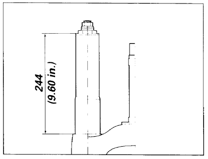

    How far out should they stick and where is the measurement taken, the second part is not as stupid as it seems. The top yoke slopes.
    A pic or two would be real helpful
  2. This pic from the manual might help you.
    244mm measured from the top of the bottom yoke to the top of the fork tubes.
