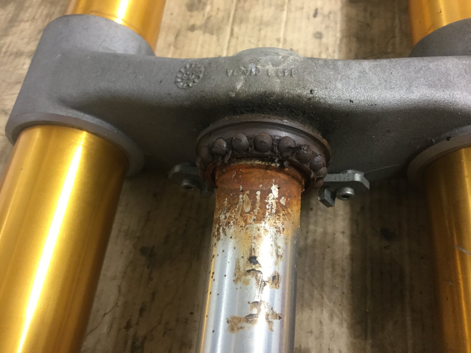

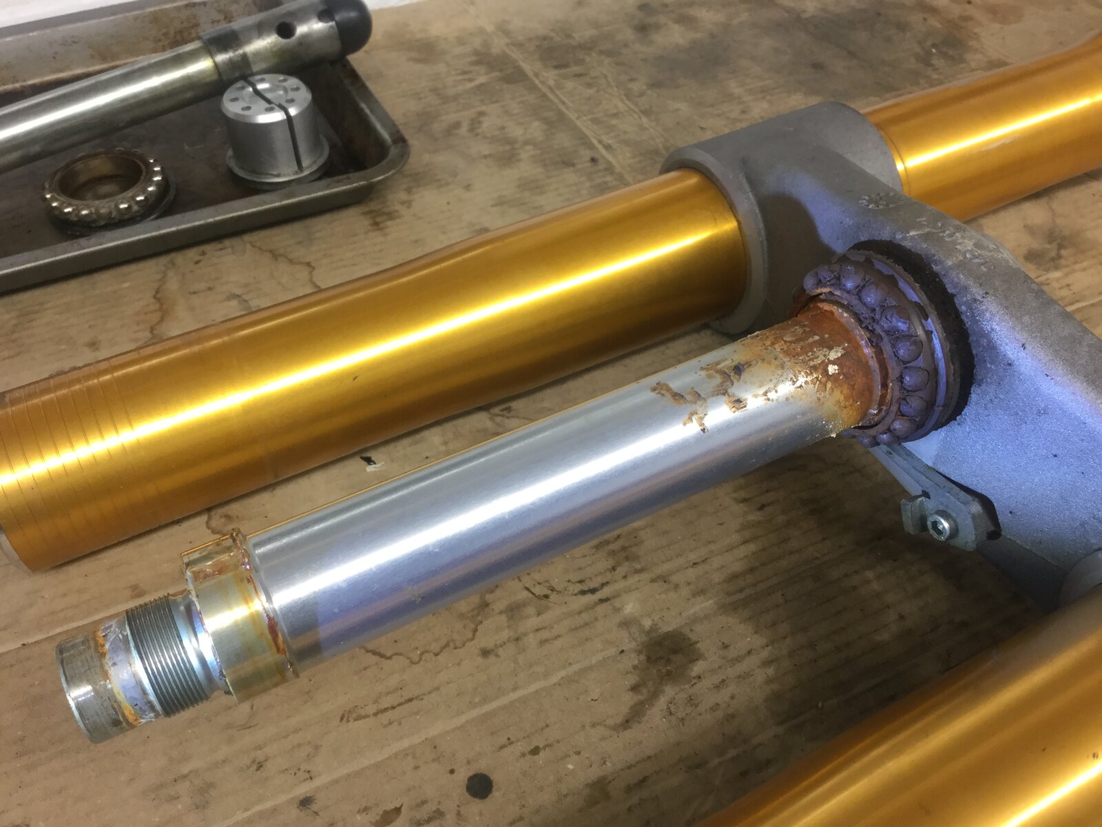

  1. Took the forks out of the 749R I bought last summer to check and grease the steering head...fuck me, what a disgusting mess!
    The bike is overall gleaming with a shed load of history and lots of nice bits and bobs on it but bloody hell, I doubt these have EVER been stripped and re-greased!
    I am shocked...never seen such shitty bearings on any bikes I’ve owned.
    I will get some new bearings and just hope the races clean up and aren’t pitted.

  2. Could you feel it/anything?
  3. Bloody hell.. what made you remove them?
    Did you feel any backward/ forward movement ?

    I took them out as that’s what I always do in the winter with a newly purchased bike. Never seen anything like these though!

  7. Pretty dry, probably originals?
  8. Yow - not good. Good job you checked.
  9. Wow what a mess, just shows even viewing a bike close up does not reveal everything about its condition, servicing etc, makes buying a bike by looking at pictures, talking at length to the owner building trust, hearing the full history of the bike from new then taking to sell parting with no money until it’s sold, not such a risk, just saying...hope you can sort that out cheap enough and no pitting.
  10. getting that bottom one off is a bitch!
  11. Never done it but looks like a bastard to get off. Let’s hope it will clean up and new bearings will sort it.

  15. If your good with a Dremel you could cut a slot/v cut in it, i have done it many times like this with my 350 lc's etc, worth a look at first.

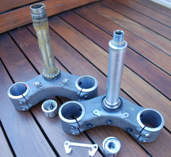

  19. Just out of curiosity Ricky are those steering stop plates original?
  20. Std 999 on left 749R on right...its because you can alter the trail on 749R yolks
