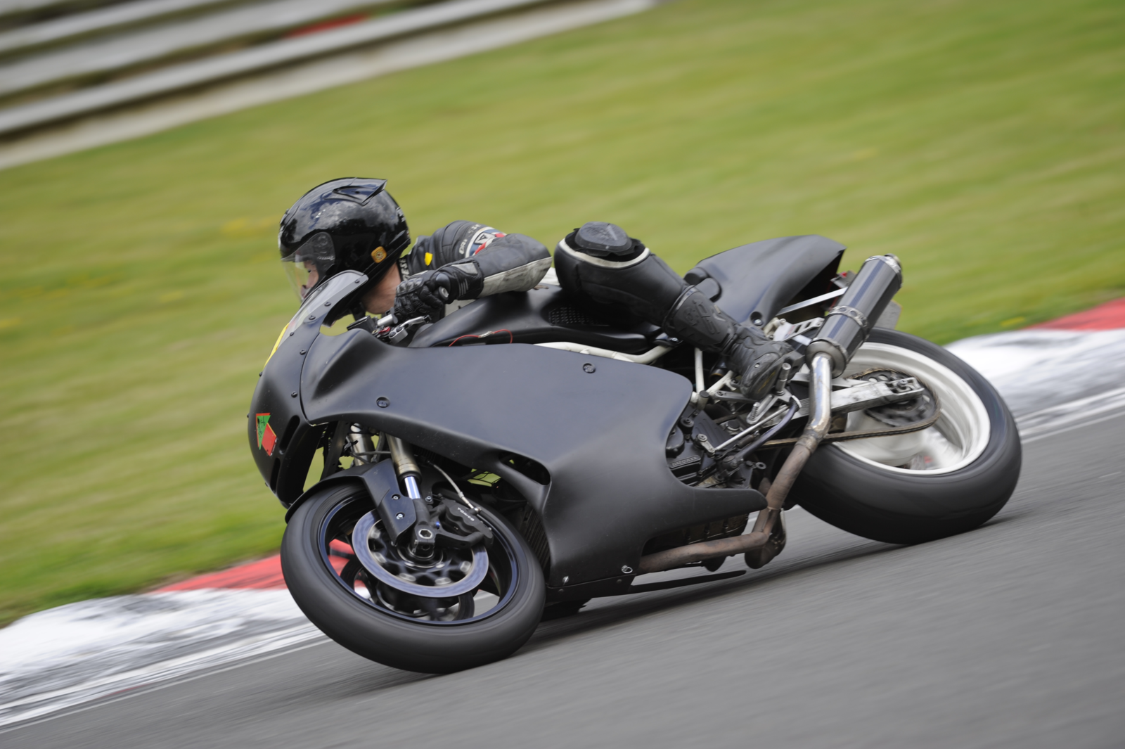

  10. I did a complete front end swap on my carb 900 ss. After looking at the Suzuki cartridge swap for the SS adjustable Showas (some details on the internet and Performance Bikes, just needs one hole enlarged from 10mm to 12mm in the forks to fit apparently), I ended just buying a complete GSXR 600/750 K6 front end and it was a simple fit.
    Best of all it was a significant improvement not just in suspension function and feel, but with the benefits of lighter wheels and great radial brakes. Bit of a win!
    This front end will actually be for sale in a month as I am duplicating my 848 front end on the SS to make track days easier. So let me know if you, or anyone is interested.
    Here's a photo of the forks in action at Brands :)
