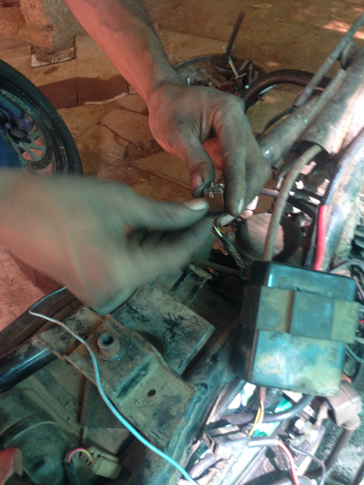

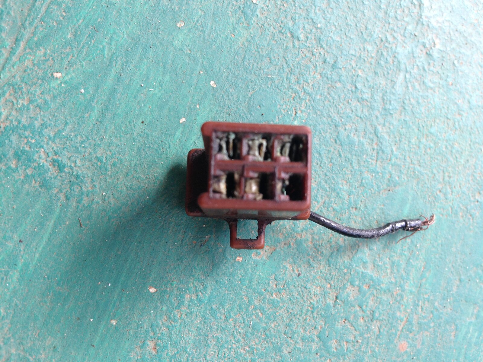

    Anyway, I was just passing through a small village not far from the start of where I enter the jungle when the bike sputtered to a halt. A few basic checks, I had a full tank of fuel, enough for 400 miles, but no spark. I suspected the CDI unit being the culprit as a month ago when I arrived in India to pick up my bike it wouldn't start, it turned out the particularly heavy monsoon had played havoc with corroded pins in the connection to the CDI unit, and once that was sorted and a few wires chewed by rats sheltering from the heavy rains repaired, the bike ran perfectly.

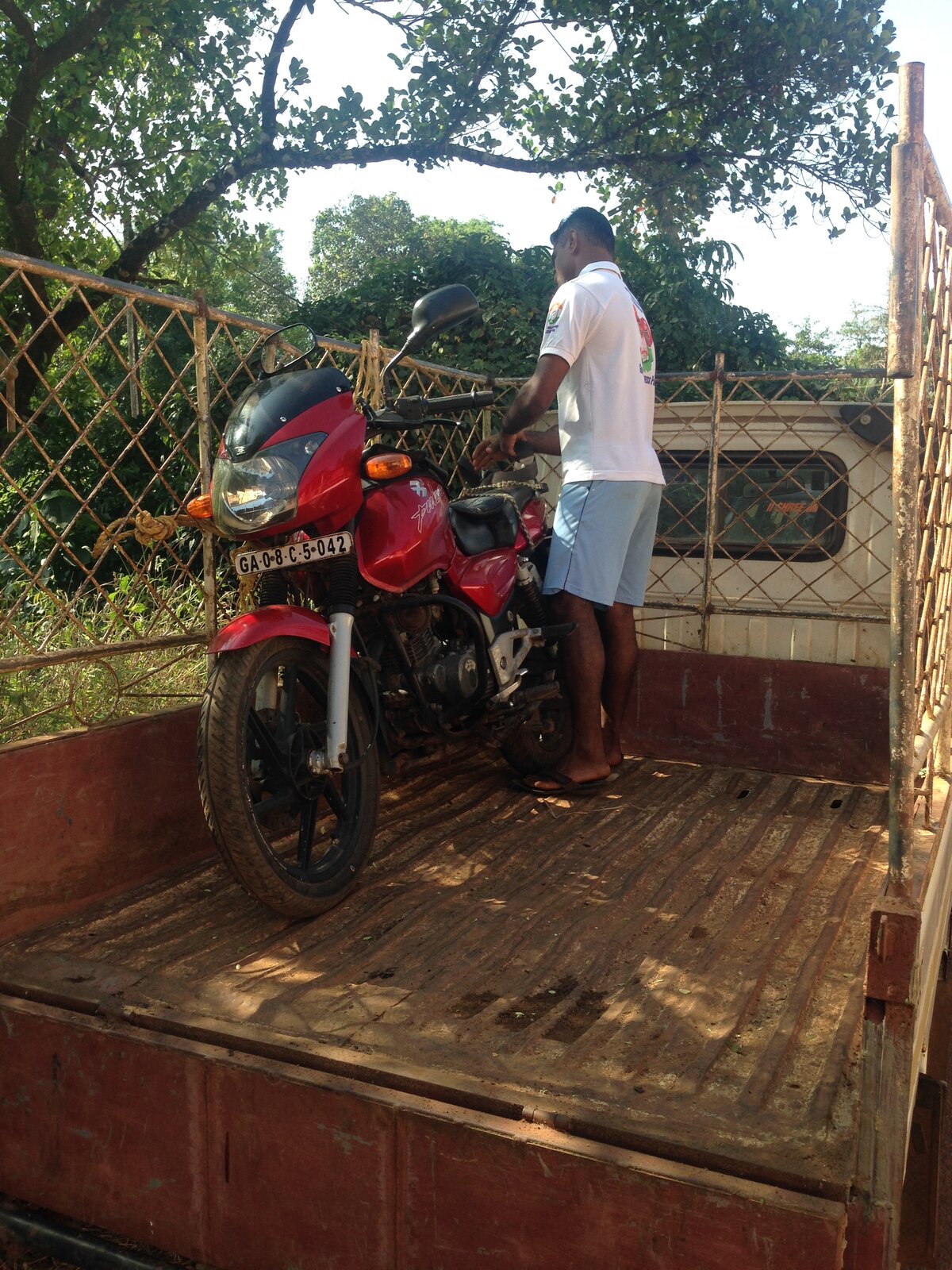

    I asked a group of guys hanging around- no work on Sunday, if they knew where I might hire a truck to get me home, within minutes I had guys running around on scooters trying to get hold of the owner of a truck, he was located and he offered to take me to a mechanic a few klms up the road. We lifted the bike in the back of the truck and set off. We arrived at the mechanics shack but he wasn't there, a quick phone call on the young drivers phone and the mechanic who was at a festival was summoned to sort my bike. 30 mins later the mechanic arrived, performed the same basic checks I had carried out and confirmed my diagnosis. once the tank was removed giving access to the CDI unit he showed me a broken pin in the wiring harnesses connection block. Superbly resourceful, he stripped a few strands of wire from a gash length and formed a pin which he then connected into the loom, 10 mins later the bike was back together and I was ready to leave.
    The mechanic asked for Rs150 ( about £1.60) I gave him Rs 200, then I had a predicament paying the truck driver who had been so very helpful- I only had a Rs2000 note, and no other change, so I offered it to him, but he declined as it was too much money. We agreed to go back to the village where he would get change for the note which he did. He would only accept Rs700 from me and was adamant that he wouldn't take any more.

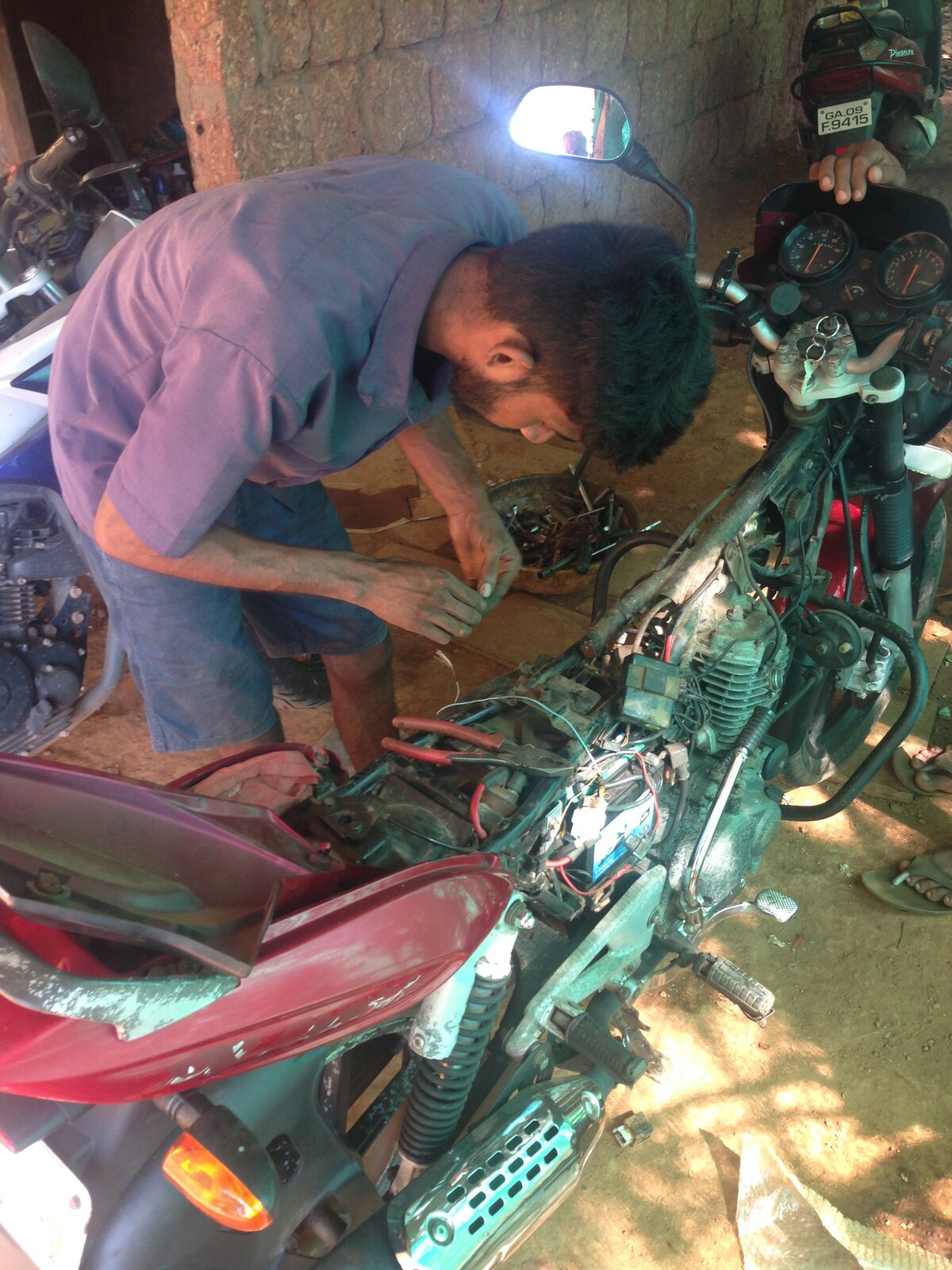

  9. 0a94e51e-a21b-491a-aac9-0e229aa51b1a.jpg IMG_1222.JPG Dropped into see my local mechanic yesterday to sort out the temp repair to my CDI unit's connection plug which had caused my recent breakdown.
    Still removing my helmet and gloves whilst he already had removed my tank bag and nearly had the tank off, he quickly decided to cut a good connection block from an old loom,handily hanging up on the wall of the workshop, and in less than 15 mins cut out the old connection block and neatly spliced in the new one, all done expertly and super fast. Got to love these guys for there 'can do attitude' If anything is humanly possible they will jump straight in and have a go . I went to pay the owner who is always smiling and keen to help me out- the bill :Rs100 ( that's about £1.10p )

    Photos of the corroded connection block, and of Monkey Island
