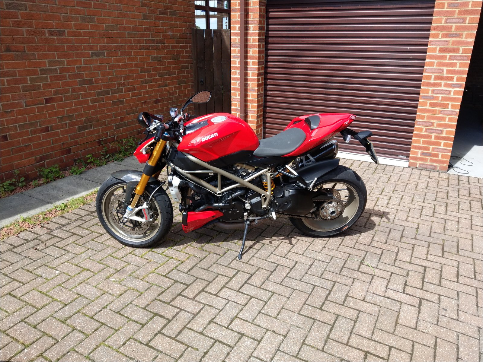

  1. Hello everyone, I'm a noob to Ducati bikes so be gentle with me.
    I bought my 1098 SFS in August and just cleaned it up to be honest, it needs a belt change and so not wanting to start the thing up and risk a nightmare it's sat in my garage since then.
    I bought this from my late brother in law Steve who purchased it new from Ducati Manchester.
    He lived in Blackpool with his wife and my best guess is he took the bike out for one last ride a few years ago and fully intended to wash it but never got the chance and so a few years later the bike frame has suffered and needs to be refinshied.
    I dont want to get into a Paint over Powder debate as I know what I am going to do.
    I guess my question is has anyone done this before ? Looking at the manual this requires a total strip of everything but looking at the bike I may be able to get this done without taking everything apart.
    Will i need any special tools for the frame removal beyond the obvious Stem tool and socket for the wheels etc....
    There's no or very little fuel in the tank so it still looks great and the bike has done only 1200 yes 1200 miles.........
    I know what this bike meant to Steve and so this journey is going to be one I will enjoy.
    I will document and take pictures of everything I can and I hope you guys will enjoy the journey
    I'm gathering my bits together and will make a start next week

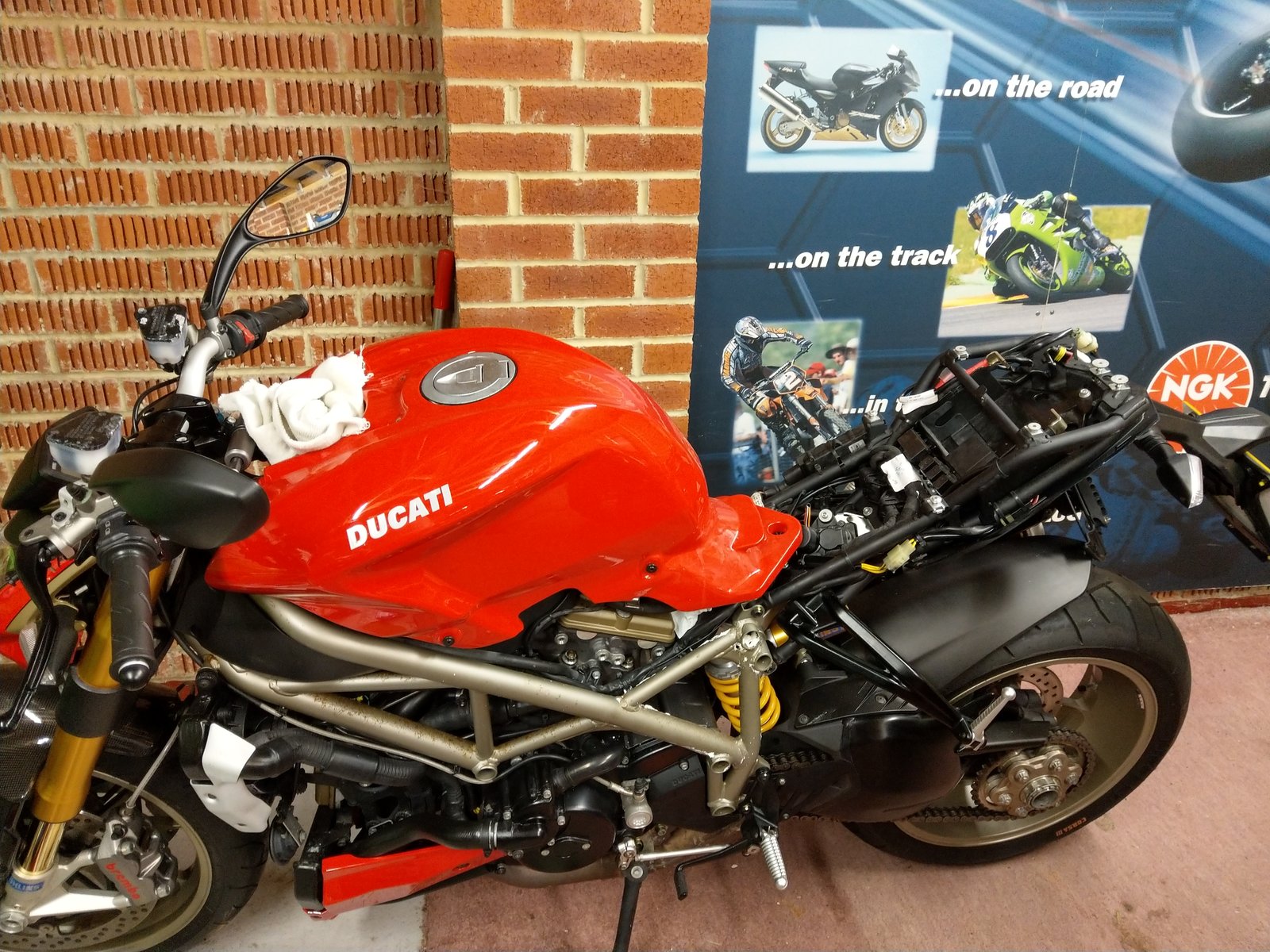

    Here she is in the Flesh
    Wish me luck

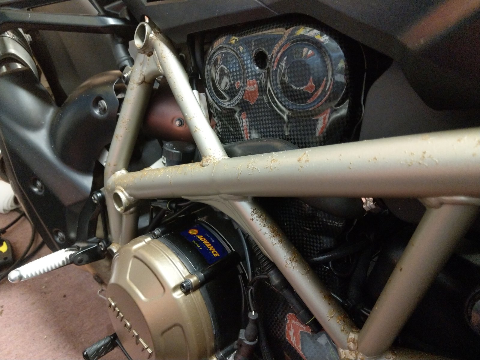

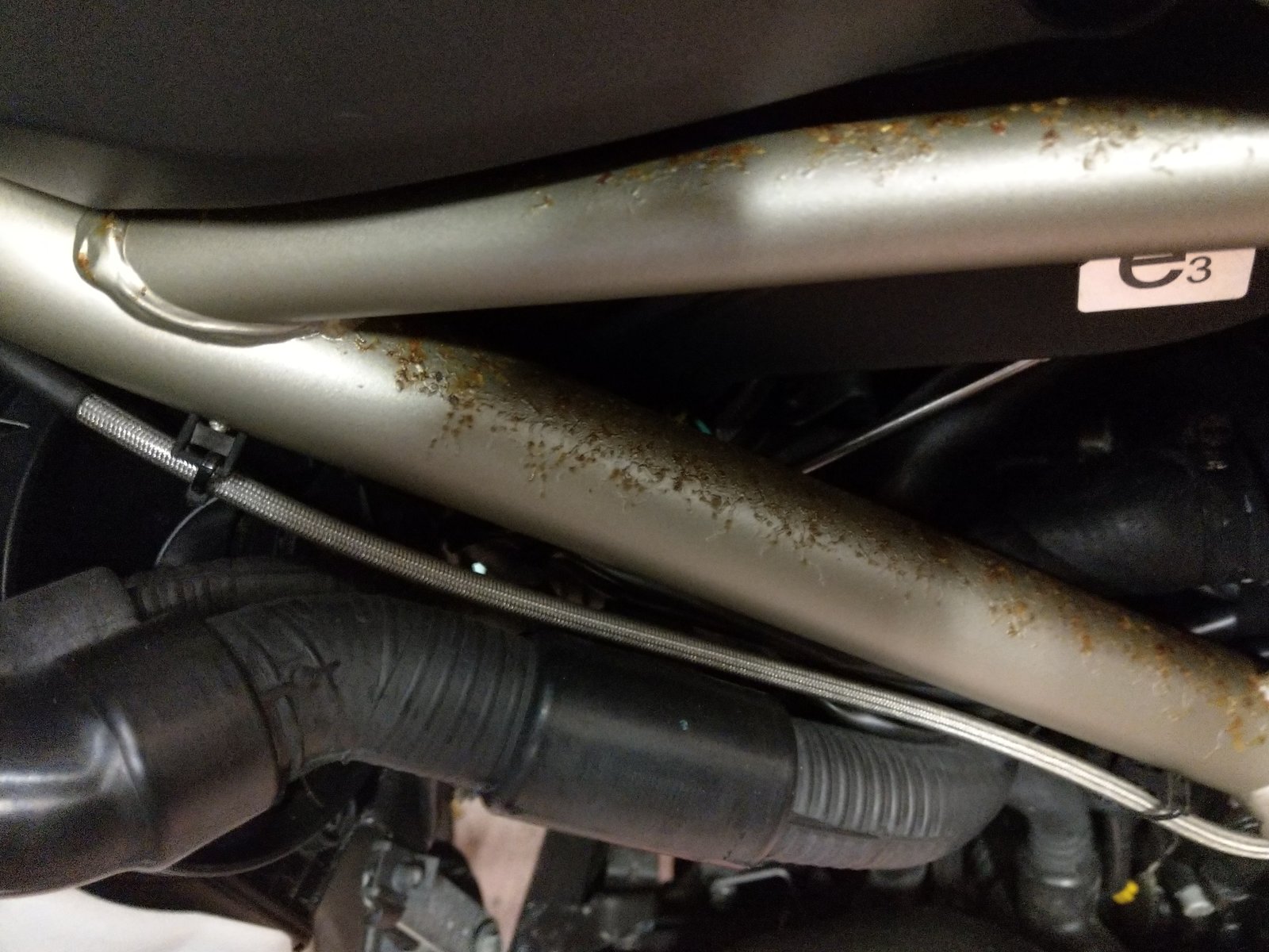

  11. Ok here are a few pictures of the frame.
    Initially I thought I may get away with dexox gel and then touch in the marks but it's to far gone for that.
    Not to mention the deox didn't touch it.

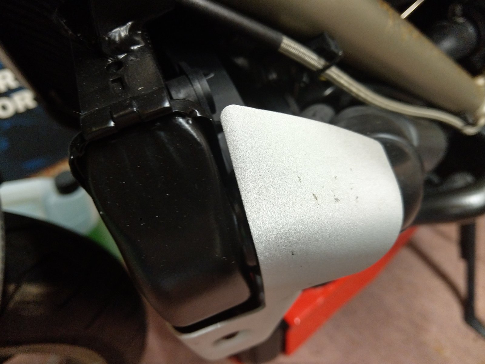

    There's some light oxidation on the alloy bits so any suggestions on how to refinish the bars and the radiator covers would be good

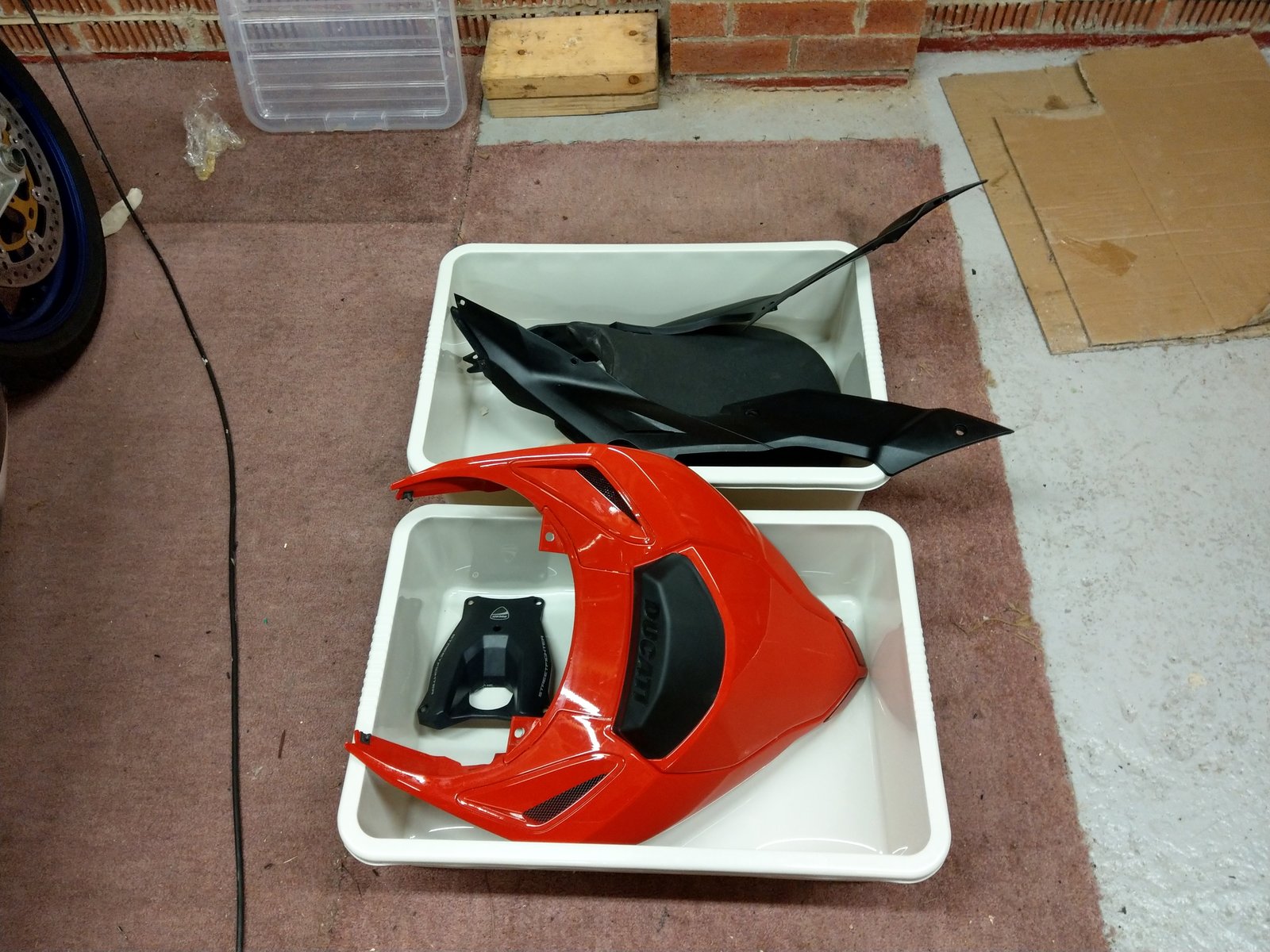

  14. I have started the process of this strip down and I'm a little stuck......
    I have got the rear and side plastics off fairly easy and now have a couple of boxes of expensive plastic
    The bike is looking a tad second hand

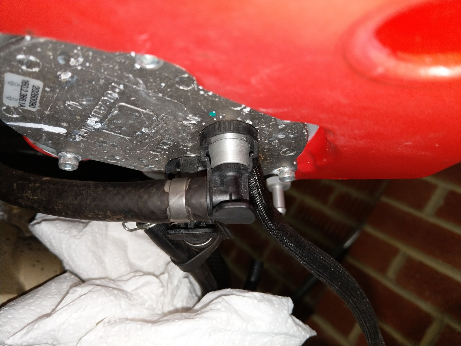

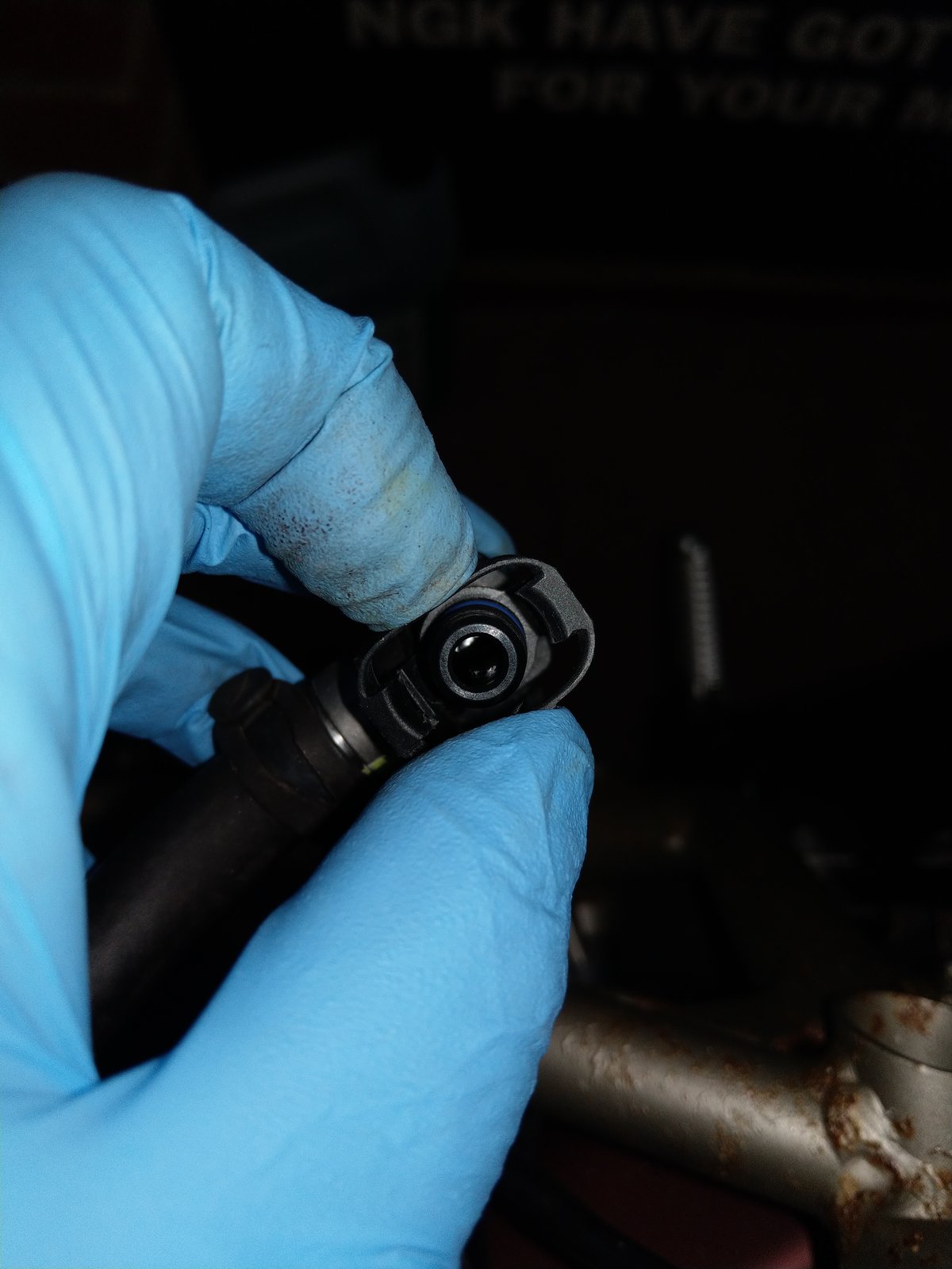

    The problem I am having is taking off the fuel lines.
    I am guessing you guys will be able to help and I don't want to go in ham fisted and cause a lot of grief for myself so how do these fuel line snap off.
    I have looked on youtube but nothing jumps out at me....
    I hope to get the tank and the other bits of body work off and get it on the lift.

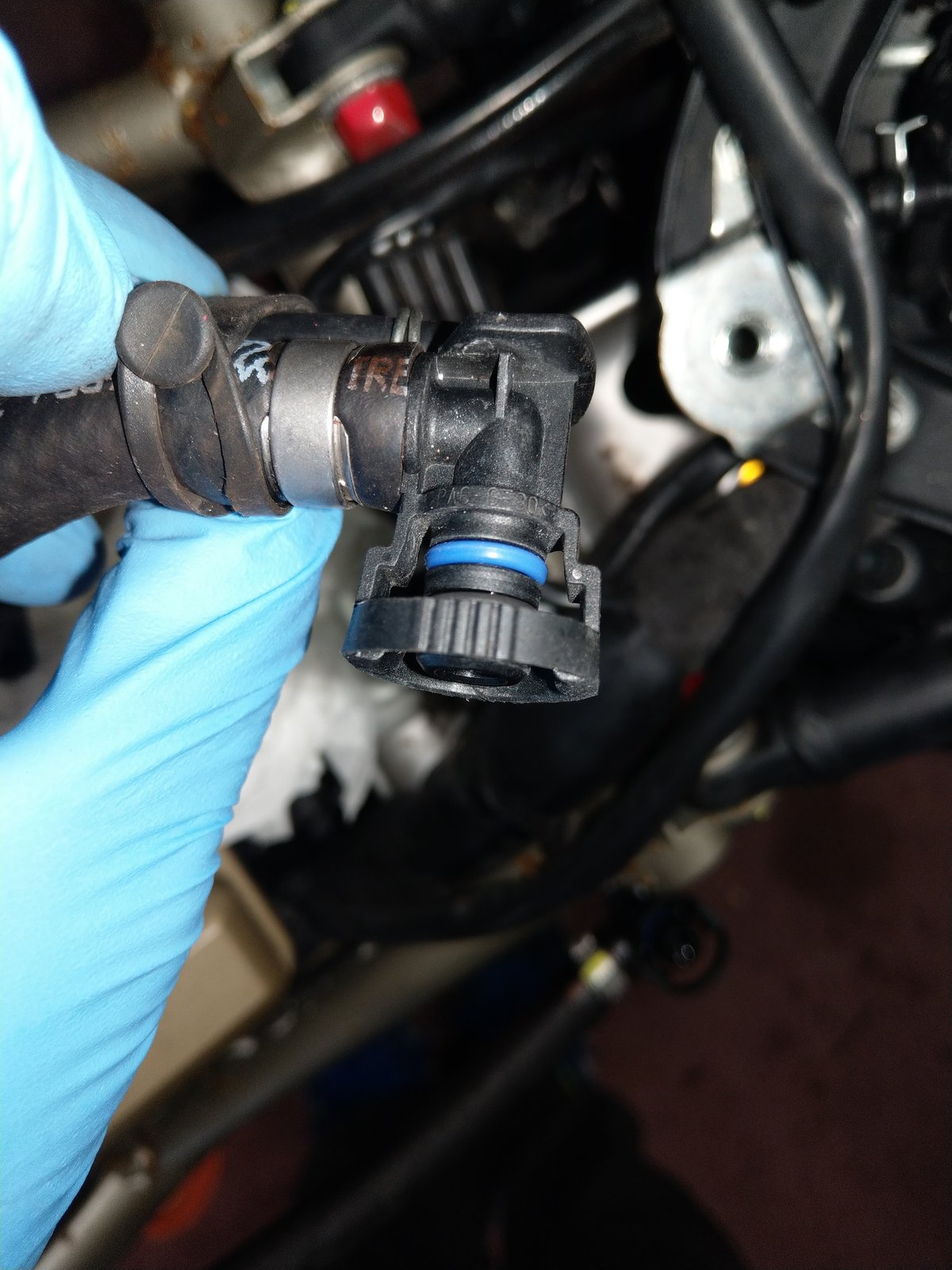

  16. press the ridgid parts in and pull.
  17. Yep, push the collar inwards and pull down (I think it's where the 3 lines are in the pic, could be the opposite side though, you'll find out when you do it).
    Careful not to nip the 'O' rings when refitting it, you can't buy them seperately for these fittings iirc. :thinkingface:

  18. as said, you need to squeeze each side of the connector together toward the centre of the connector (where the vertical lines are moulded into plastic shown clearly in your undertank picture) with thumb and fore finger, in a very similar way used to remove some anti-tamper bottle lids. They can be stubborn if not removed for some time and you can check how stiff they are by carefully swivelling the whole black plastic connector first. If it's reluctant to even be swivelled then ideally you can work some rubber grease into the joint which will make things much easier. As you said, there doesn't seem to be much available in video form, and even in the one I found he doesn't make much reference to the removal method (about 4 mins onward) - I usually carefully swivel a little while squeezing together and pulling down/away from tank.
    https://www.youtube.com/watch?time_continue=17&v=rhyBS-dxRmU
    #18 Chris, Oct 9, 2018
  19. Gents thanks for this I will give it a go tomorrow and see how I get on. The picture when zoomed does give a far better view than my eyes do in real time

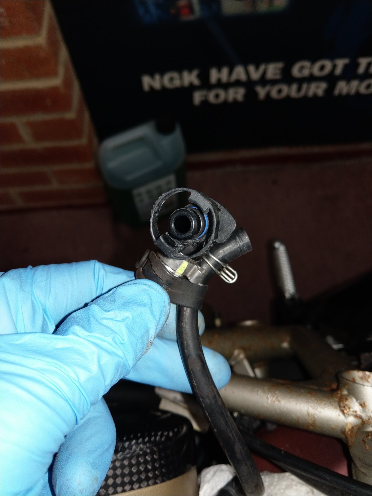

  20. OK thank you one and all for the replies, Its actually easy once you know how so just in case somebody in the future looks for this its simple.
    You need to squeeze the plastic retainer in the same way you would take the lid off a bottle of bleach. Squeeze in the areas where the vertical lines in the picture are present.
    You can see how the holder deflects when you give it a wee squeeze.
    As I say... Easy when you know how

    Any ideas how they can be removed without destroying them or is it just a single use. In the above picture you can get a good idea of the surface corrosion
