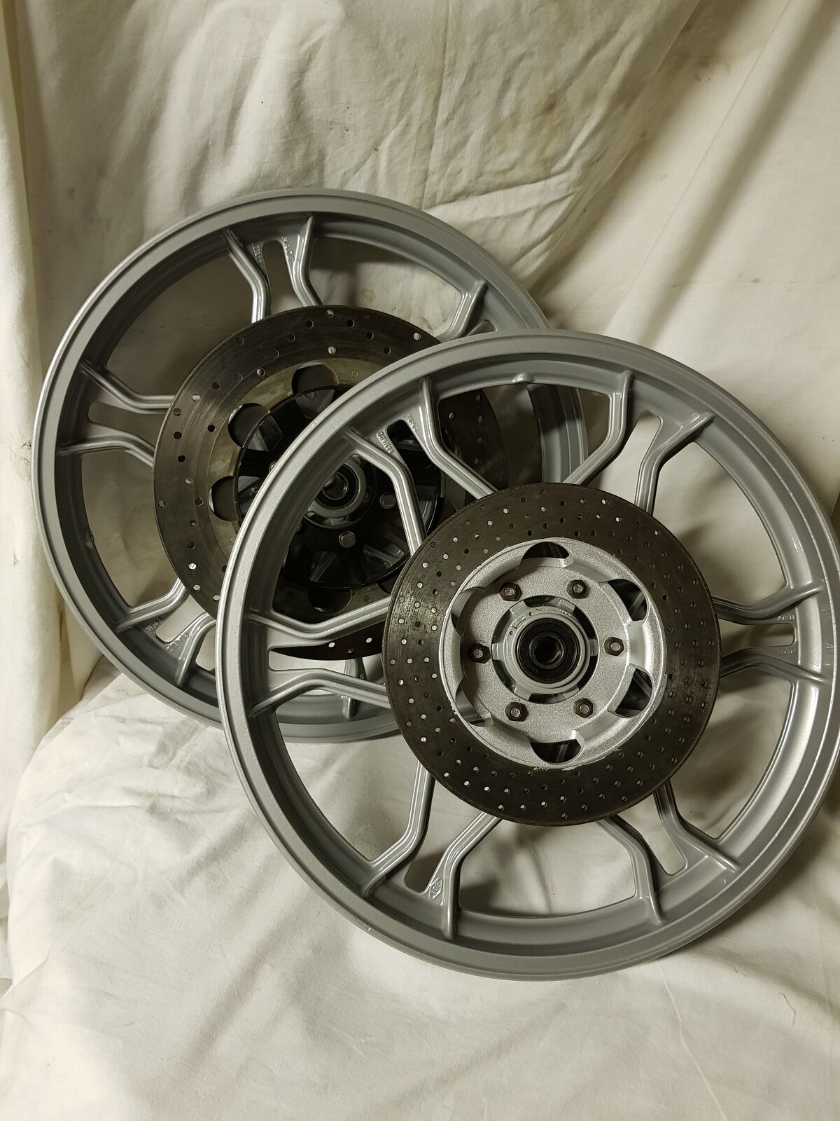

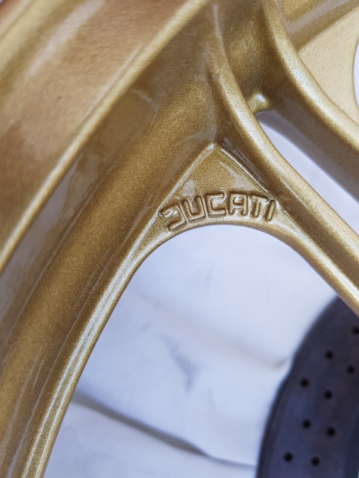

  14. Here is a photo of a powdercoated wheel. The fine detail looks pretty well displayed, to my eye. The layer is thin but tough, and bears little resemblance to concrete.
  15. Wow that looks good. Who did the work for you?
  16. Steve Turner of TPCS, near Devizes in Wiltshire. This wheel is aluminium alloy, but Steve also specialises in magnesium alloy. I recently got him to do a pair of Guzzi wheels - to strip, crack test, powder coat silver, fit new wheel bearings (supplied by me), and dispatch back to me - and it cost a grand total of £182. I thought this was reasonable, considering the quality of the work.
    http://tpcs-magnesium-refurbs.co.uk/
