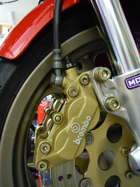

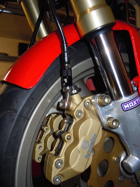

  1. After just over twenty six years I thought it was about time I replaced the original front brake hoses on my '94 750SS. I wanted to use quick release, or dry-break, fittings on the calipers just because it makes it very easy to disconnect the calipers without the need to re-bleed them when they are re-fitted.
    Here's the before,
    And the after,
  2. Good job, is that a production kit or custom?
  3. I bought all the parts, seperately from Torques in Swansea. I've used them for a while now, all the oil hoses & fuel hoses on my bobber were made using self-assembled hose & fittings from them. Swaged fittings would be a little neater, but that means getting one end swaged on, then measuring the pipe with the other end fitting in place, cutting the pipe to length, then sending it all back to Goodridge with a drawing showing the orientation of the end fittings to each other. It's never been an issue to do it that way & Goodridge have always been very helpful to me in the past, as I'm sure HEL would be too. It's just simpler/easier for me to make them up myself in my garage, on the bike.
    I just had to machine the banjo bolts down 1.5mm in length as the titanium quick release banjo bodies on the male halfs are a little narrower than the normal stainless steel type banjos. That allowed me to tighten the bolts up fully in the calipers & stop them bottoming out before they clamped down on the copper washers & sealed.

  4. Nice work, looks good
  5. Its all in the detail, looks great. Notice the Maxton sticker as well. This must be one very sorted 750.
