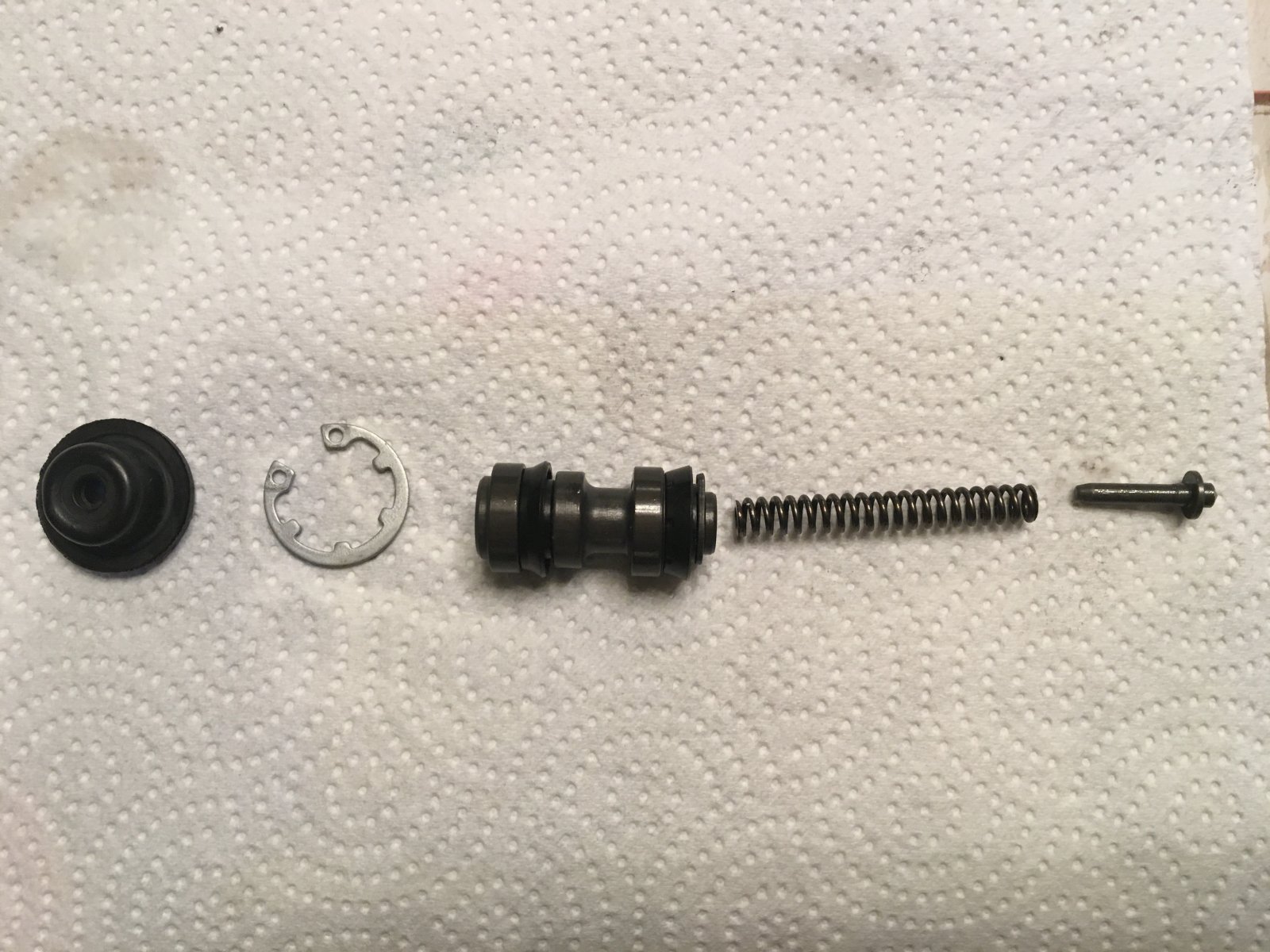

  1. The bike is a 2015 Multi 1200 with Brembo M50 brakes.
    Can anyone confirm that the order of the parts and the orientation of the last part on the right is correct?
    The plan was to follow the reverse of how it was on disassembly. However, the piston would not easily come out and when it did, everything shot everywhere !
  2. Looks right to me.
  3. Thank you, Paul !
  4. Having looked into the same part on my wife’s M796 very recently, I would double check this as I recall the spring being the last part coming out, the little pin thing being directly inserted in the piston itself. IMG_0651.jpeg
  5. Its right
  6. Thank you !
