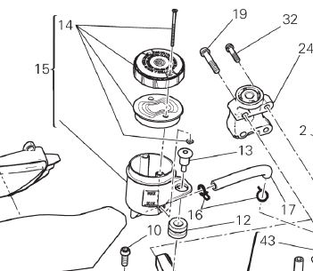

  1. I know some people have had these replaced by Ducati, do they replace just the cap and seal or is the whole lot inc. reservoir replaced??
  2. top seal and cap. common problem

  6. I fitted an aftermarket alloy cap as i previously read about the oem plastic caps flexing but that is also now leaking. So i was planning on buying a new oem cap and seal as presumeably they have modified it?
    Thinking about it now i might just take the cap and seal off, give them and the resovoir a really good clean and run a fine smear of silicone sealer around the reservoirs lip and re-assemble it all.
  7. I cleaned and refitted the seal and cap so many times that I lost the account now. The spilled fluid (because when you are on the road, there is no much you can do when starts leaking, just swearing) already caused some paint damage on the right switch. Last time was in March this year, it seems ok for the past 3 months. Big secret is not only cleaning very well but not tightening the cap screws at all. They just make the cap seat on the seal. Tight them up and will leak. Looking for aftermarket one.

  10. The plastic cap can easily distort if over tightened. Clean the cap and rubber as dry as posssible. Twist the screwdriver with the shaft and not the handle. Just a little snug
