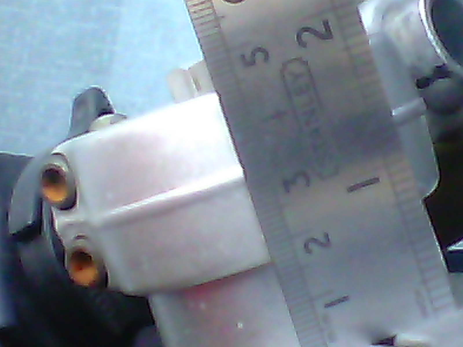

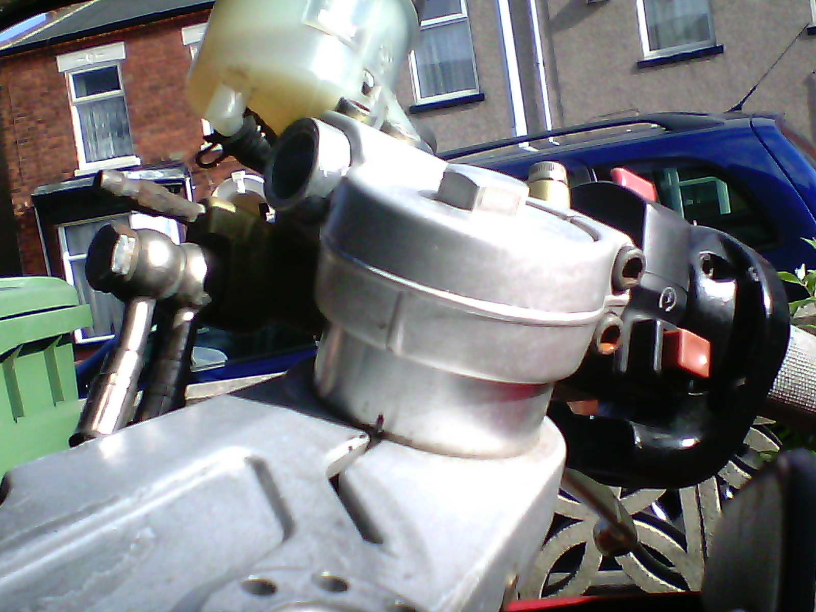

  3. had a quick look in the Haynes manual and all it states is to measure the fork height before you remove the forks then replace as was
    but I think this has been asked before
    anyway have a couple of pics from the manual gives an idea
    and one from my bike

  5. Sorry to be so late Patrick -busy day,mine measure 44cms from the yoke to the flat on the leg not the hex on top,hope this is of help.
