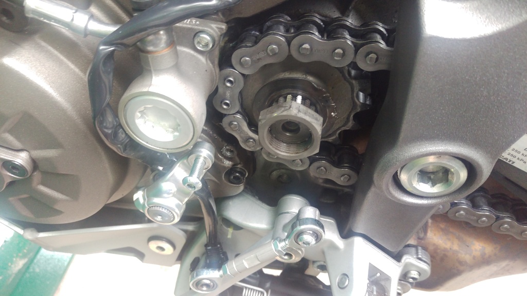

  11. Just finished mine.
    I used a big bar wrench and oddly I found that a 1 1/4 socket was a perfect fit (the 32mm had a tiny bit of play)
    Came of OK with bike in gear and daughter holding the back break.
    Removed one of the bolts from the gear foot leaver an let it dangle
    Undid the rear pinch bolts and slackened of the chain (clockwise for undo).
    Undid and removed the clutch slave ( left the bar in).
    Then you guys weren't kidding removing the chain from the sprocket is tricky.
    I took of the chain off at the back and then slid the front sprocket out until It cleared into the gap that the clutch slave cylinder made.
    Then it's just (lol) a case of removing the chain outwards to clear all the teeth at the same time with about a 1mm gap.
    Wow I will have more patience with my mechanic from now on.
    I also read that it should be well greased
    Will do a test ride at the weekend.
    Cheers and good luck duceri
    Took a pic before I removed it
