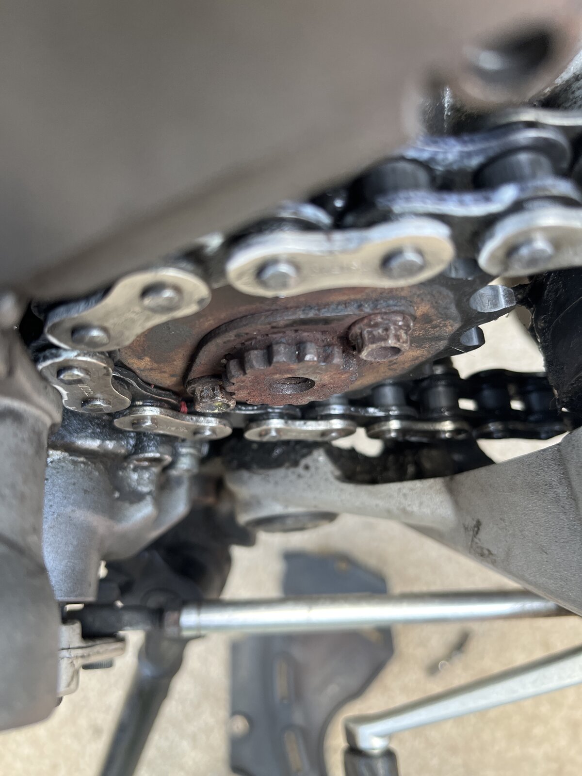

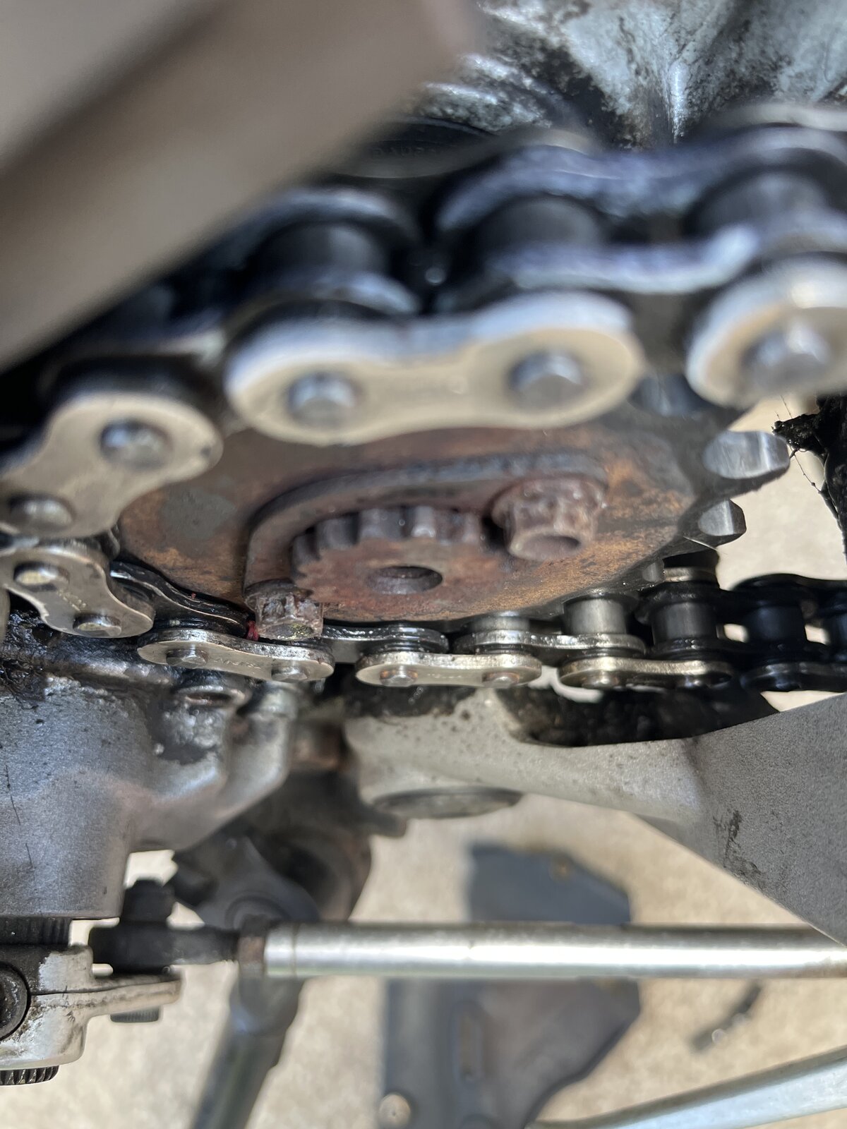

    Could do with some help here. I have a Ducati Monster 696. Should there be much play on the front sprocket.
  2. Pretty normal with that sprocket retainer. Check that it hasn't worn. Best to replace the retainer with every sprocket change.
  3. I'd put moly grease on the spline when the sprockets off. Any movement will cause fretting (= wear) if unlubricated.
  4. Thanks all for your help. I was concerned about the sprocket and been able to move it.
