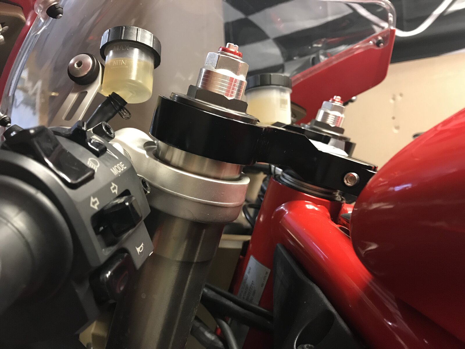

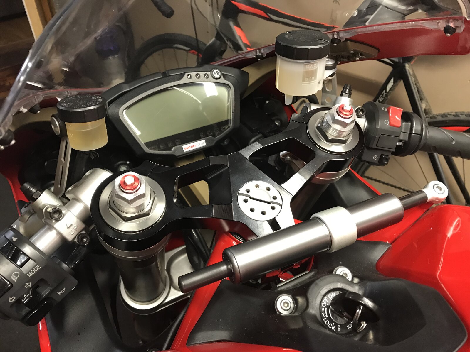

    I went through a series of things to try and make mine possible to ride for longer blasts and never quite got there. I tried helibars but despite what others say, if you want to use the steering lock you have to set them almost straight like motorcross bars which feels weird, and I tried a speedymoto top clamp which was the best option as it raised the bars by 10mm but kept the positioning the same. It’s expensive but I’d say the best option on the 848, here is the pics
    First pic is how much you can raise the bar height by
    Second is when fitted
