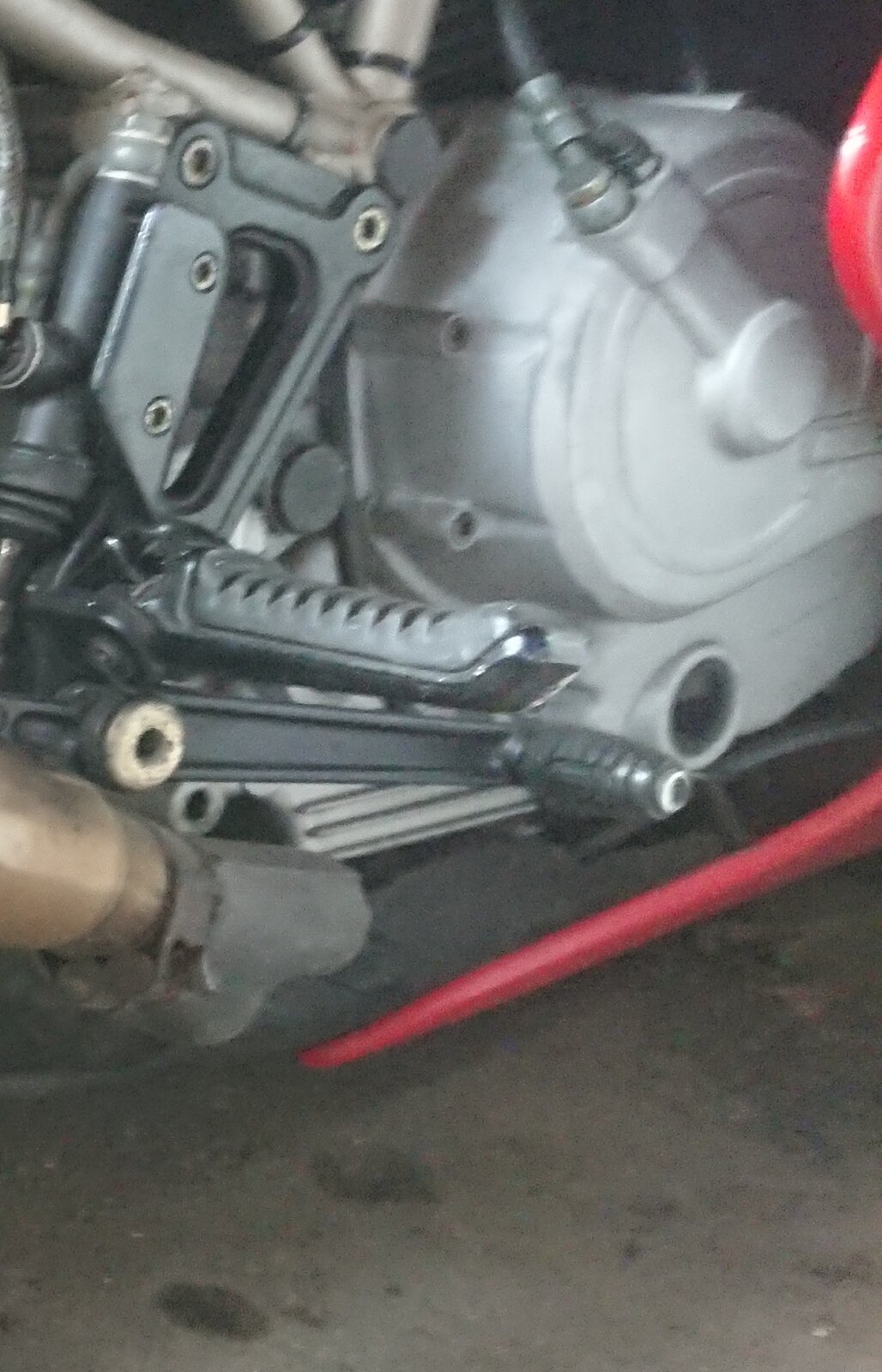

  1. I filled the tank and as I walked to pay realised there was petrol running out of the overflow pipe by the rear brake pedal. Thinking this was just a minor over filling I expected it to stop quickly but it didnt. The fuel was pouring out for about 5 minutes. No key in the ignition so the pump was off.
    I had a pencil in my top pocket so plugged the hose with it and rode home without a problem.
    The bike is new to me and this is only the second time I have filled it - there was no leak last time.
    Any ideas?
  2. maybe some dirt in the carbs stopping the float valve shutting off
  3. The hose the fuel is running out of is one of the three connected to stubs at the back of the tank by the hinge not the drains from the carbs. You can just see it in this pic running down between the frame and the back of the gearbox and ending under the oil sight glass. hose.jpg carbs.
