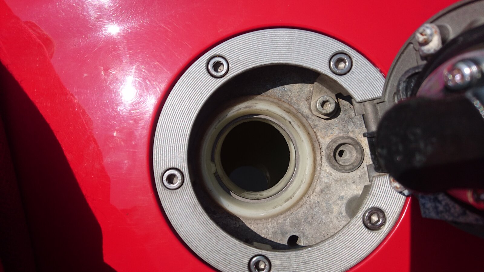

  1. Long ongoing issue on my 848.
    Fuel occasionally leaks from the breathers. If the breathers are blocked it escapes from the edge of the filler cap instead.
    If I blow into the breather tube and cover the outlets at the top I don't get any air escaping elsewhere so I think the internal tank pipes are intact.
    I appear to be missing a rubber nipple that connects one of the holes to the pinhole in the cap.
    Could anyone advise if I'm missing any other gaskets from the filler area? Might a blockage within the cap itself cause this?

  2. There is a valve in the cap for breathing. It could be blocked or assembled wrong. It shouldn't make fuel come out anywhere though.
  3. Solved -
    So after further investigation it appears there was some leaking through the breather pipe inside the tank. Maybe increased ethanol related? at any rate blocking the breather and allowing it to vent through the overflow line instead seems to have worked fine.
