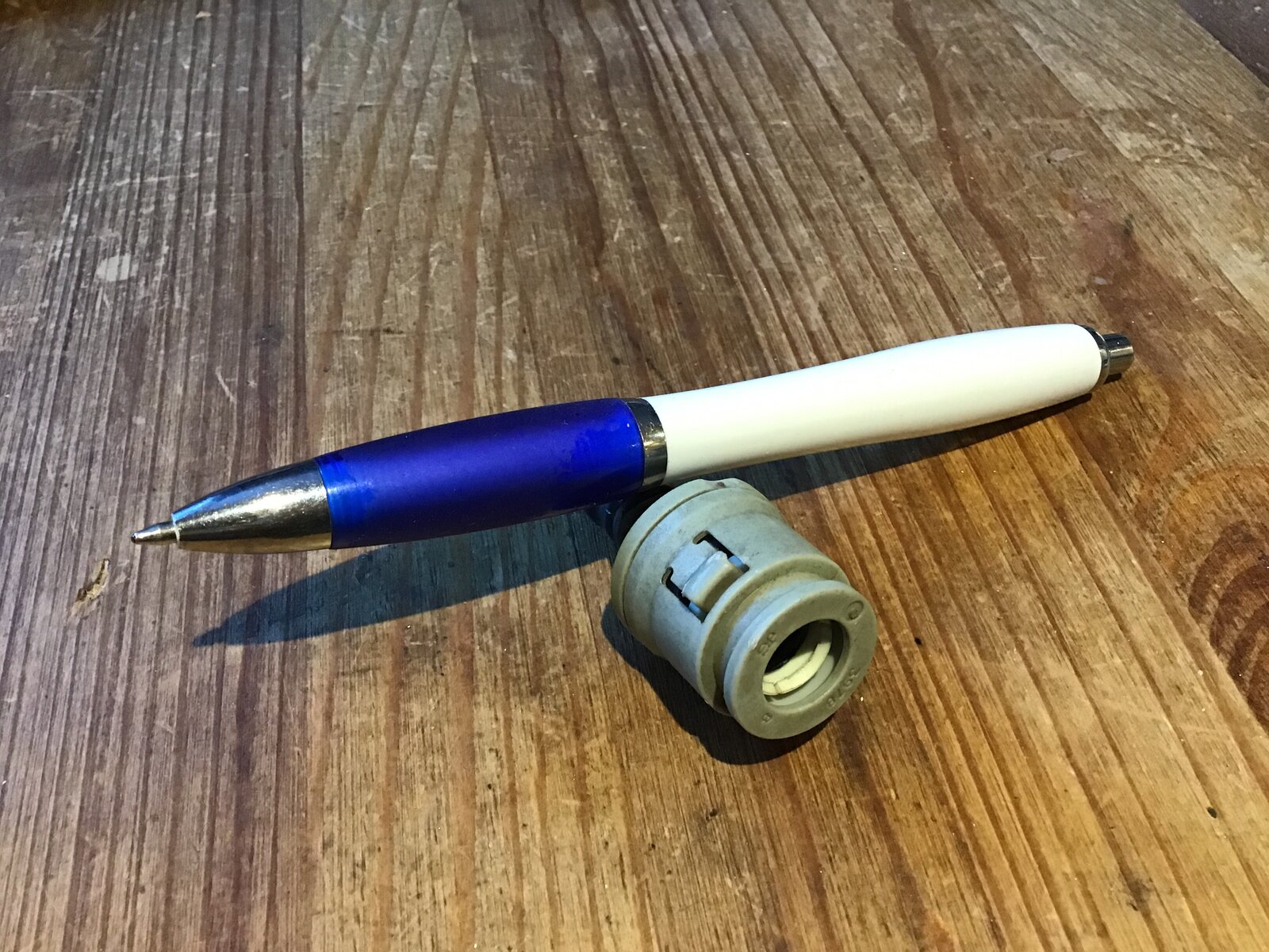

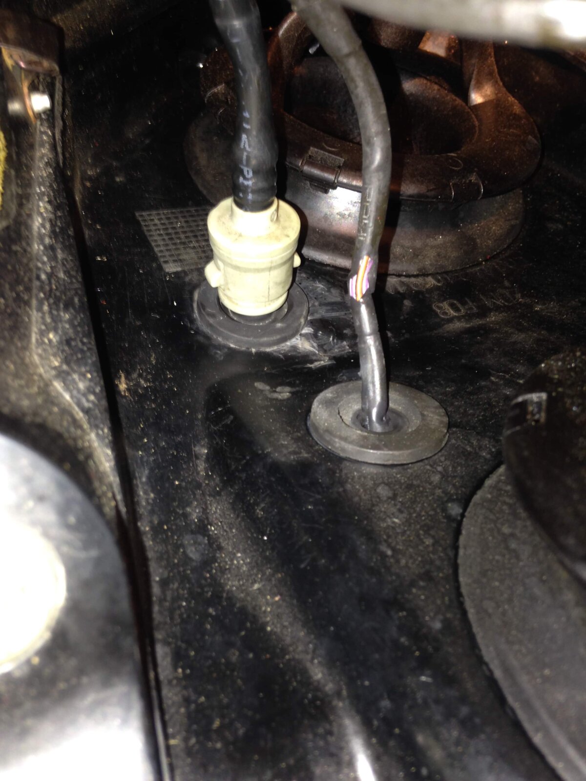

  1. 8CFD22F7-5602-4243-96A9-63F7F47B8BA6.jpeg 988AD631-F7ED-4280-8051-57F5E1035BAD.jpeg Since I’ve recommissioned my 998 I have noticed a fuel smell and today investigated and found the following weep under the airbox when the fuel pump is primed (see pics). Would anyone know if this part (little white barrel) is available or is it a job for the garage as the pipes leading from it are heat shrunk?
    It looks undamaged inside and fits with a satisfactory click but something in clearly amiss and the drip lands square on the horizontal cylinder head with potential inflammatory consequences!

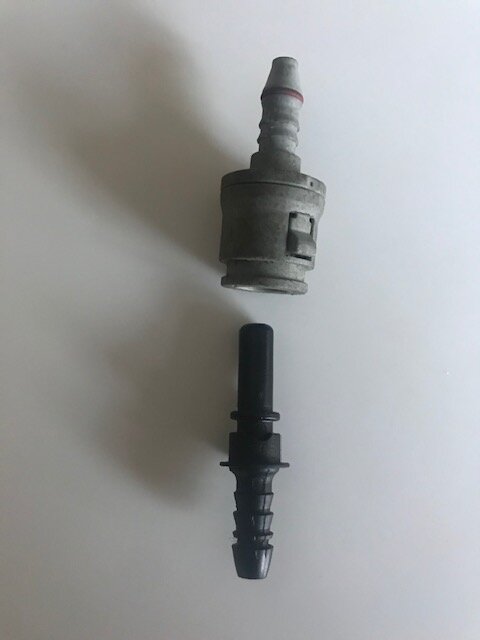

  2. its a connector male and female so there is a little green o ring on the connector squeeze the sticky out bits and they will come apart
    if its the pipe, junk that and replace with h/pressure rubber hose and oettinger clips

    I don’t see any way to take it apart? Also I have no O ring, I’m guessing it would sit inside the little barrel at the female end, in the visible channel between the white push fit interior and the beige outer casing?

  6. I know. I knew how to get the two different parts apart, I figured you were inferring this piece came apart to allow the O ring to be replaced?
    In any case, it seem logical simply to bypass this part and join a new fuel line directly to the brass ‘male’ end?

  8. heres that connector with the correct other end...an o ring sits in that waisted bit.

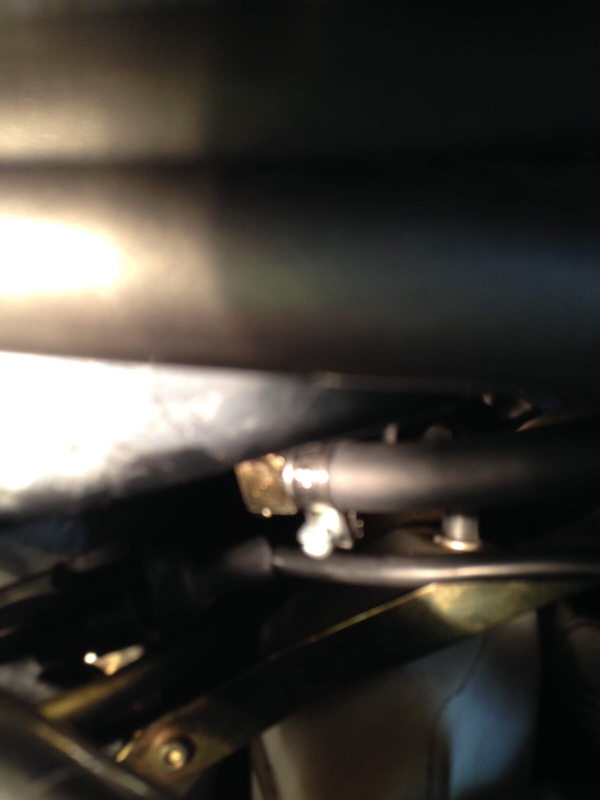

  10. Mine has the brass fitting on the fuel lines. Maybe the 748-996 were different?
    Shit photo but you can just make it out.
  11. Ah ha, mine is different, it is metal but exactly the same shape (maybe upgraded for 998 or non OEM). You can see the base of it in my first picture. I have no O ring but I have an idea there was one originally, oops.
    Gonna just bypass the whole thing with a new fuel line!
