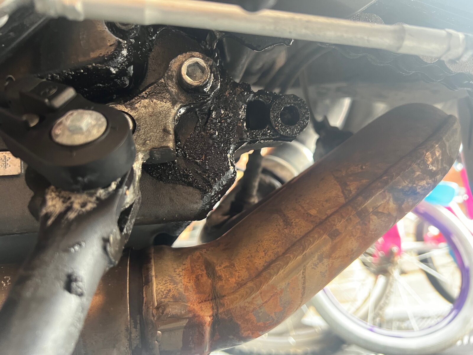

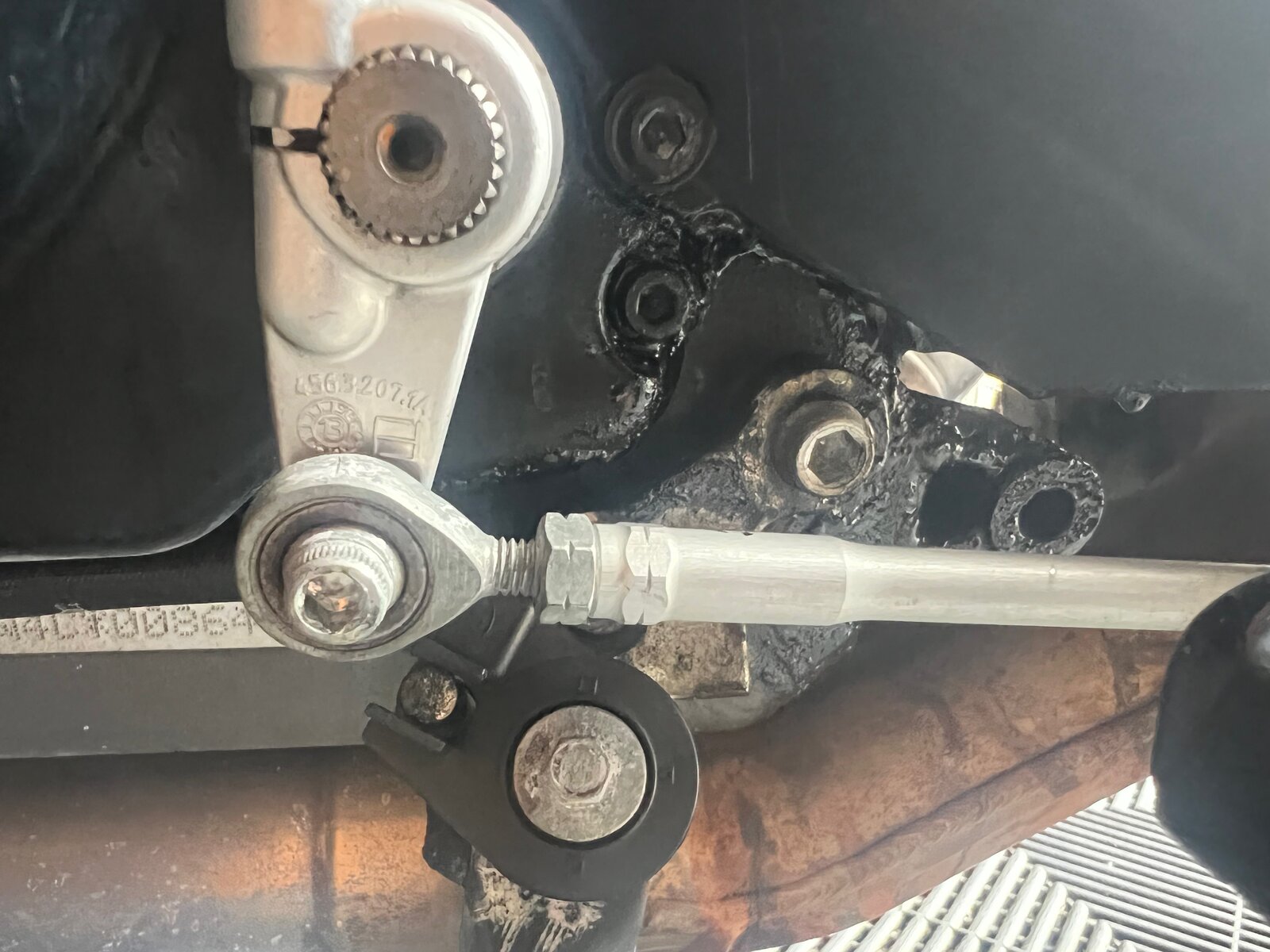

    was on my bike ducati streetfighter 848 when suddenly had loss of power. there was leak at the bottom of the bike smelt like fuel had after further inspection looks like its leaked oil. where the oil level is on the glass looks like it may of mixed with fuel.
    is it the end of the bike ? only had it for 7 months i have extended warranty..

  2. Without a closer inspection/more photos, it’s impossible to tell. That area gets covered with oil fling and crud from the chain as it goes around the front sprocket. I’d remove the front sprocket cover, thoroughly clean the entire area then look and see if there’s an oil leak.
    Its unlikely an oil leak from the engine would cause a sudden loss of power. A long running slow leak or a sudden massive loss of oil could/would cause an engine seizure if not acted upon quickly, but you’d notice that and it’s different to a loss of power.

  3. Looks like fling to me, and probably coincidence.
    Get it back to the dealer to check it over. Use the warranty mate.

  4. I agree, looks like chain fling. I am guilty of over oiling my chain. Mine is worse than above until I periodically clean the area.

    That’s not likely an oil leak - too gloopy, def chain oil running out the front guard.

  6. thanks, so i called the company who i have taken extended warranty may be a burst. the AA mechanic removed the tank could not find the pipe so had to transport it over to a mechanic. i spoke to the the dealer said most likely a dirty oil in the oil sight glass .. will see what the mechanics to see if they fix the issue.

    I'd give the chain and covers a clean and re-lube, get the oil changed and ask the dealer to establish the cause of power loss, which IME is usually down to fuelling, electrics or the engines ability to breathe.

  9. I reckon it’s the clutch slave leaking and washing out the chain gloop to form what appears to be an oil leak.
  10. That’s chain lube that’s ran down. Get a picture of your sight glass if you can.

  14. The o-ring in teh clutch slave has worn allowing clutch fluid to leak. It mixes with the chain fling and drips. Its a common problem. Its happened on my 916 and my 1198. I replaced the oem clutch slave on my 1299 almost immediately I got it.

  16. Isn't a sign of this the clutch fluid in the reservoir going black? Happened on my 916, fluid slowly goes black then no clutch, could be confusing with master cylinder failure
  17. Fluid can go darker over time. This is usually when I replace mine, when it approaches the colour of your morning pee.
    Ive had this twice. The 1st sign I got, that I'd noticed, was when the lever came back to the bar. Fortunately not far from home and I'd get home with no clutch. Jumping the odd red light.
    As I tend to over lube my chain, I'd not noticed amongst the muck that it was dilute with clutch fluid. I guess it all depends.
  18. There’s also a pair of o-rings on the clutch pushrod which seal oil into an oil galley the pushrod goes through. If one of these fails, or is damaged when the pushrod is inserted it will allow engine oil to migrate along the pushrod and exit, albeit in tiny tiny quantities, but over time ….
