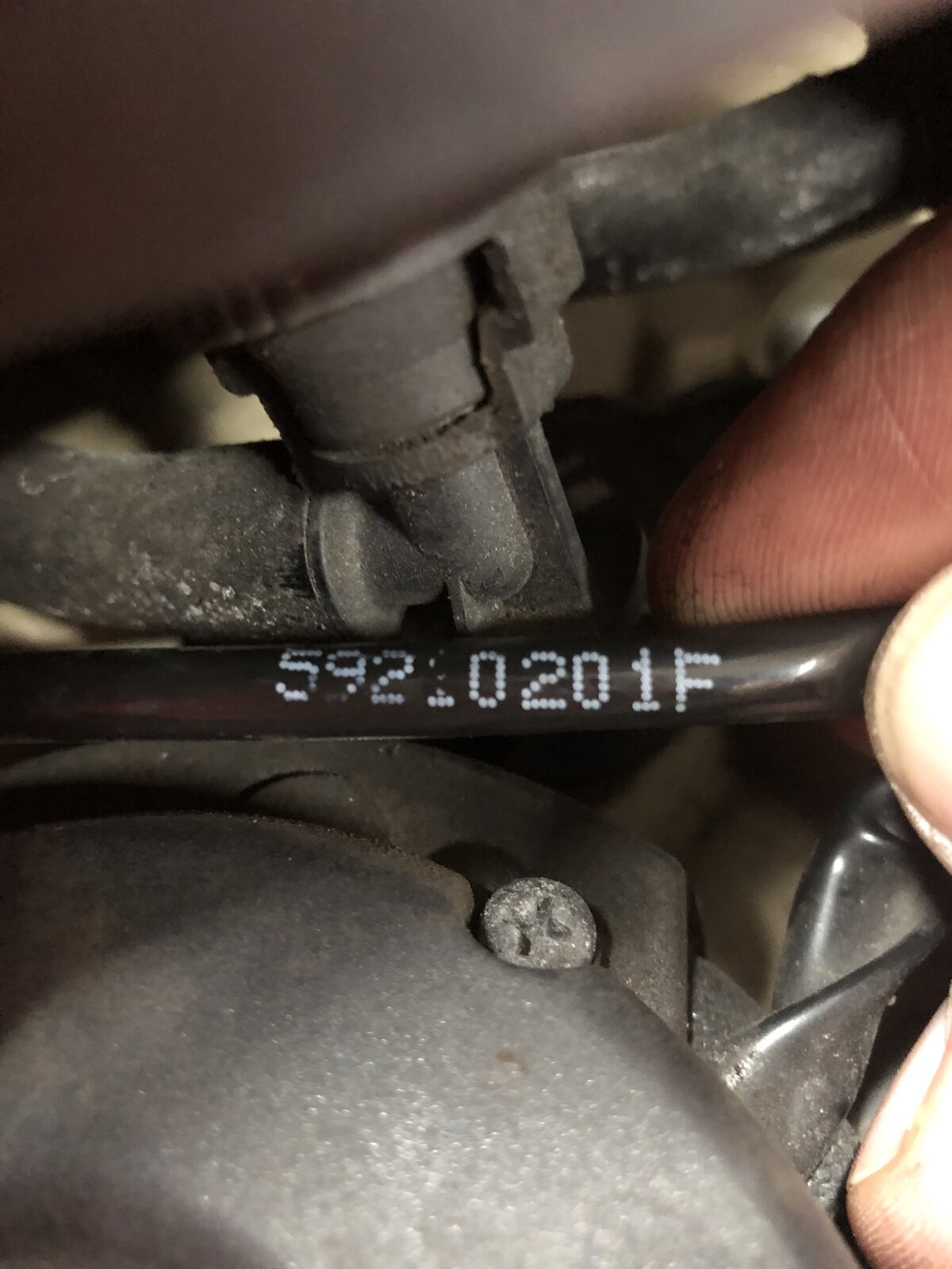

  3. Thanks for all the help. Picture of sensor code
  4. Looks like an old code, Sod’s Law it’s an old sender.how much will it cost to get the update??
  5. Yes, that's the original sender... Must be one of the last in existence LOL
    It'll need the firmware update to work with the later senders. Update shouldn't cost anything, but that might just be me ;)
    It's only a 10 minute job with the diagnostics.
