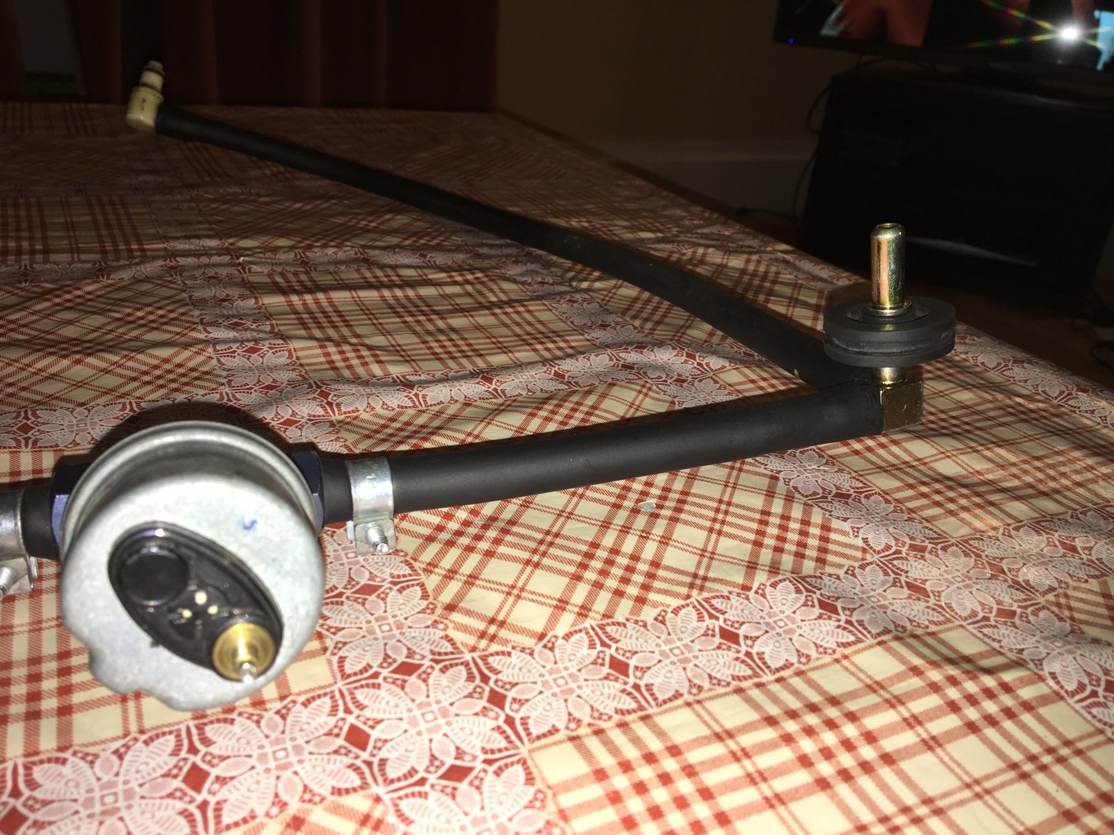

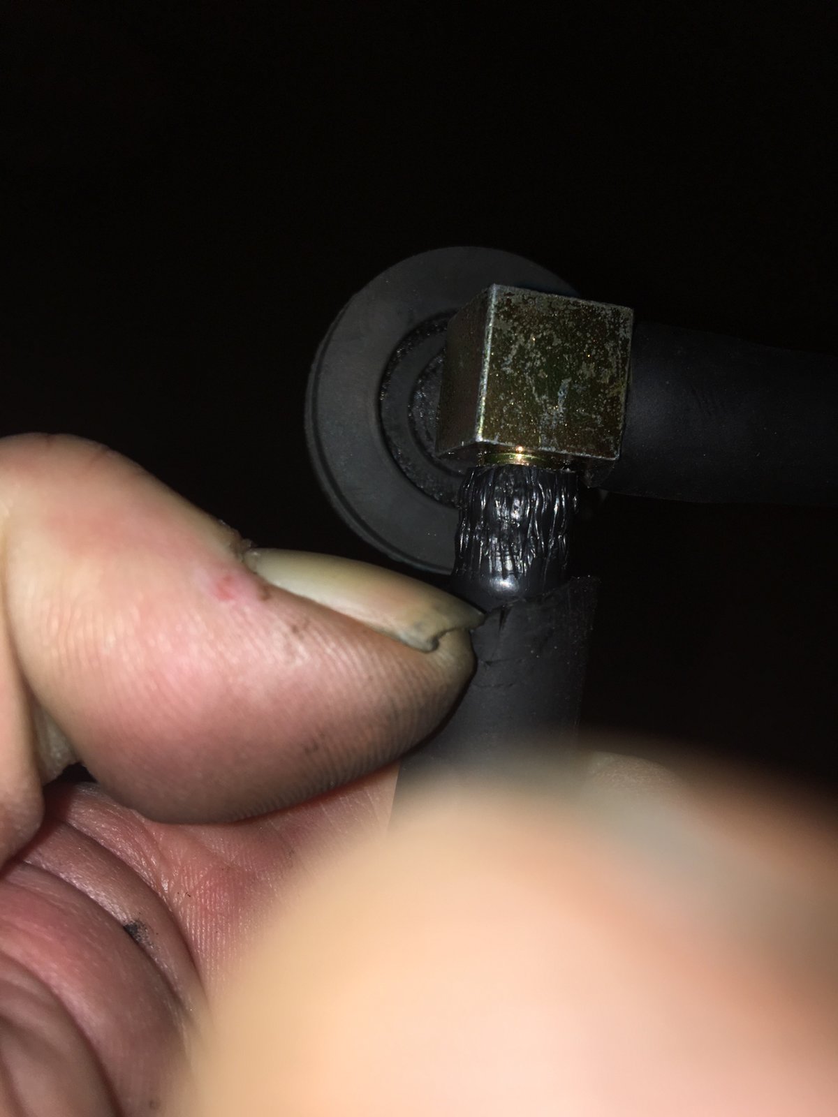

    I'm trying to fit a fuel pressure sensor in one of the fuel lines between the pump and T piece to the Airbox. Is there a trick to refitting the tight inner pipe back onto the T piece or do I need to take it to a fuel,injection specialist to have it refitted?
    Cheers, ian
  2. Try warming it up with a hair drier and put a very light smear of Vaseline on the T piece
  3. Cheers, denzil. Will do. Tried with hot water but couldn't get it past the 2nd ridge on the T piece. I'll have a go now.

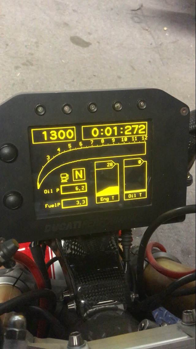

  4. Job jobbed. Cheers mate. :upyeah:
