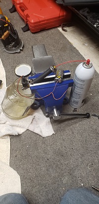

  9. just pulled the fuel module and checked the regulator. I submerged the regulator in fuel and supplied air pressure until the regulator released pressure. It released a 40psi, no leak until then.so it seams to be fine. I checked the fuel pump it maxes out at 50psi. Now i dont know if this is high enough has anyone checked this ? I have a feeling this is also good so am i looking at injectors ????

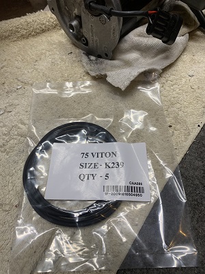

  10. Im trying to install the fuel module and i cannot get it back in. Does the seal swell making it a one time use? I didnt have any issues before but it was a new seal. Been trying for over a hour and when i thought it had gone in it leaked and also ive scratched the tank right on the top so im steaming right now.
  11. So this is what ive found out or should i say not found out.
    I had some new fuel tank module seals sent overnight, they were not ducati seals so i got 5 seals for less that the cost of one ducati seal. The module just pushed in !!!!!! 5 seconds to install. SO i will never TRY and reuse a tank seal again!!,,
