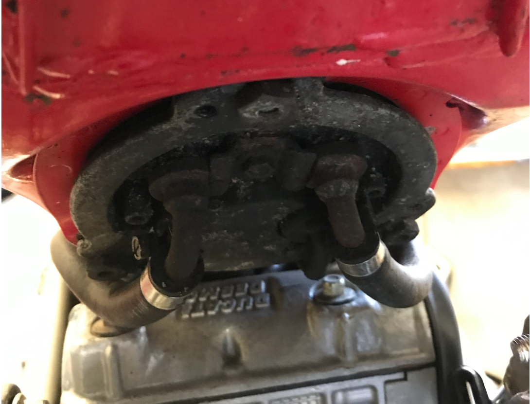

  1. Today I went to take off the tank and according to the Workshop manual it states remove the quick connections. Mine hasn't got them, do the early (2003)749 have normal jubilee connections?
    thanks in advance

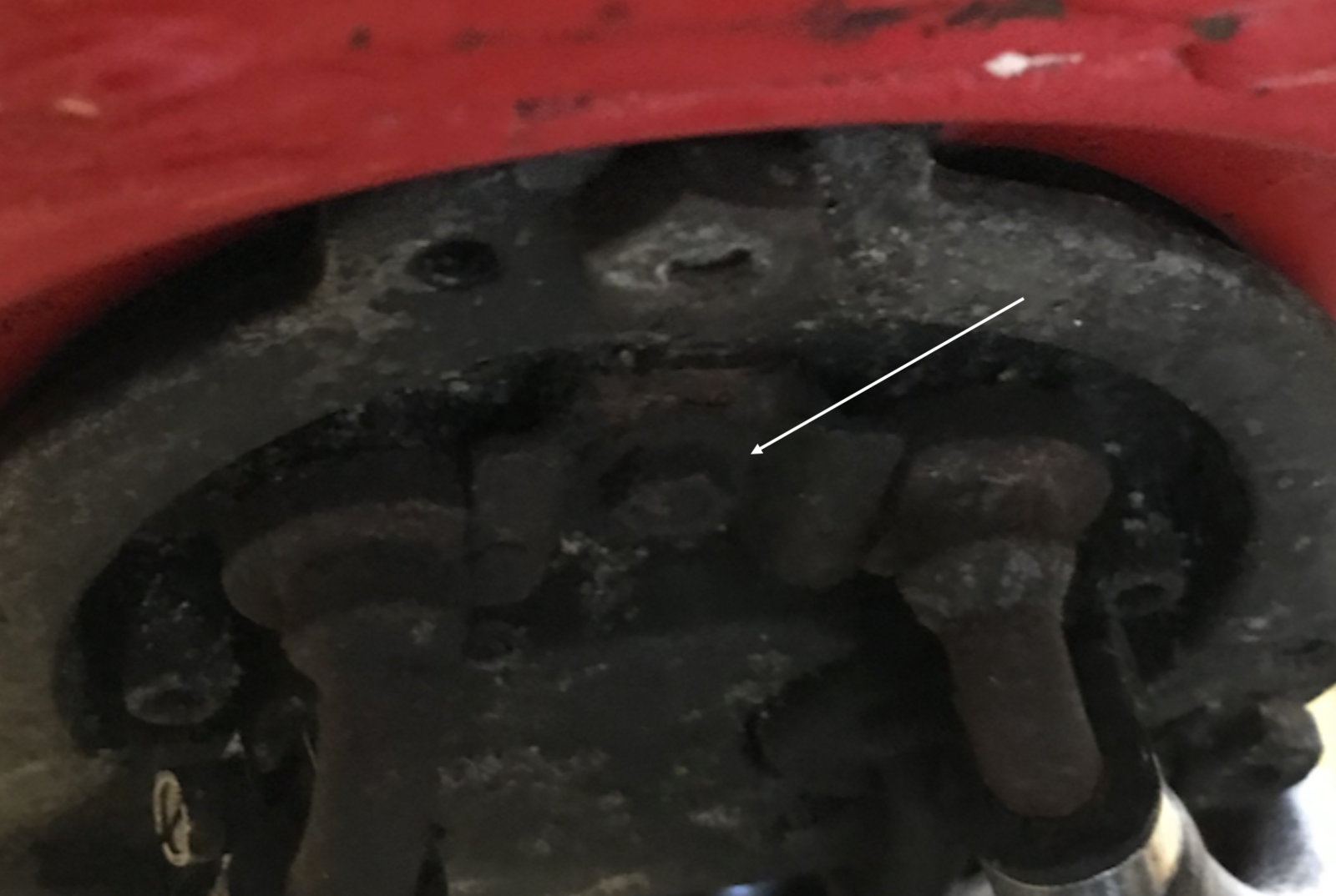

  2. that bolt there.....and remove the metal bracket underneath it
  3. Undo the central bolt. The fuel lines will then pull out. They are push fit with O rings.
  4. yes spotted that thanks, was expecting squeeze and push connectors.
  5. thanks, so it's just an early version then I guess
