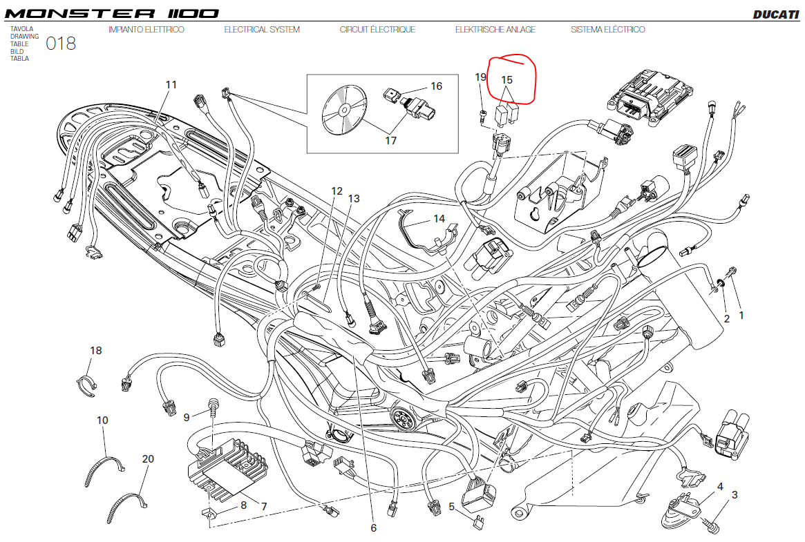

  4. There is no "fuel pump" relay on the M1100S..the only relays listed in the workshop manual are "Injection System" relays so I reckon they do the same sort of thing.
    Part number is 541.4.007.1A - can somebody point me to a suitable alternative off that there internet please.
  5. The injection relay powers the fuel pump. It's the one with brown/brown&white cables connected to it.
    Genuine relays are about a fiver, there may be a link on here to ebay or such like? They're pretty universal across the bikes now. Same one as the infamous 749/999 injection relay.
