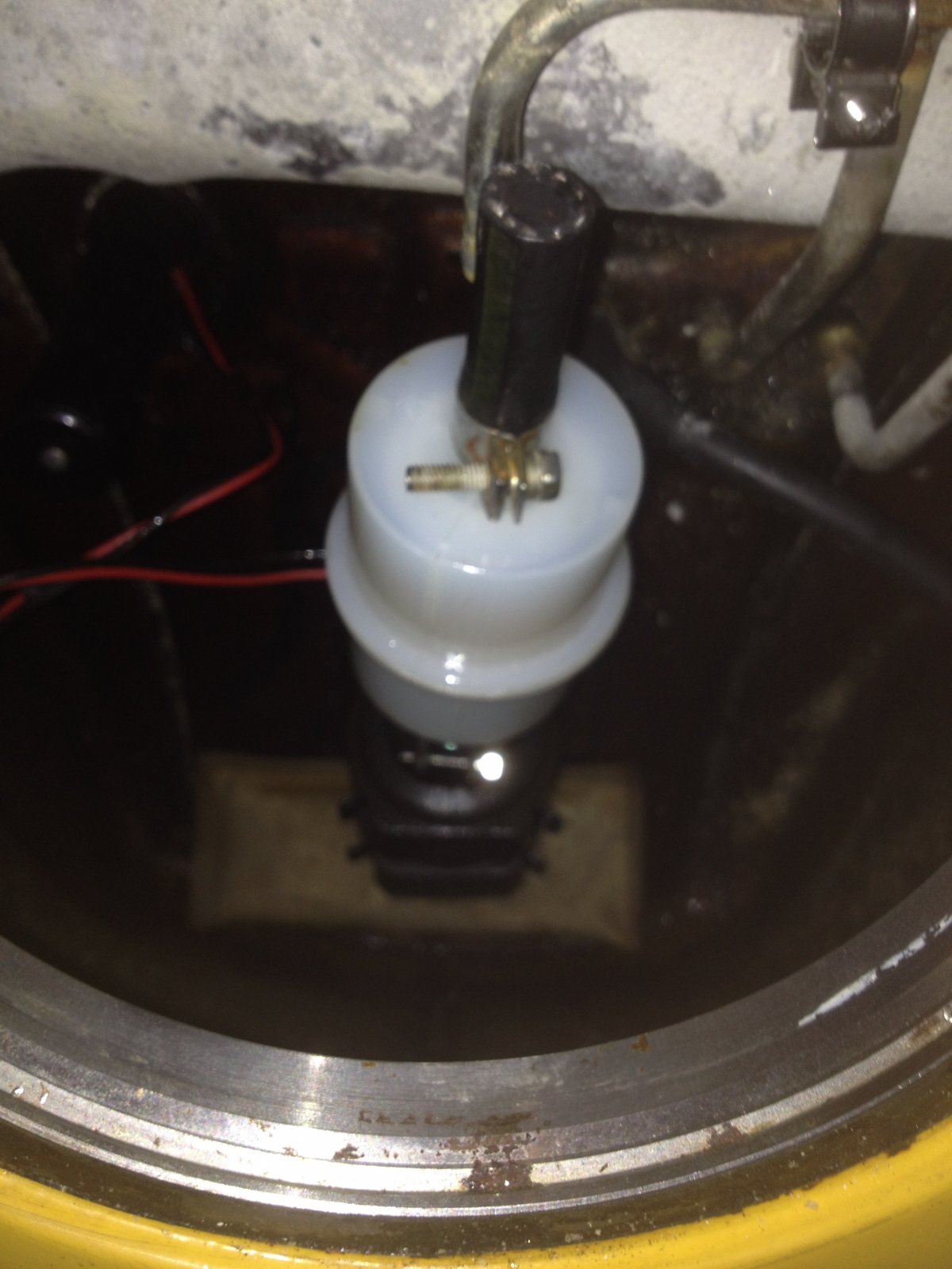

  5. image.jpeg It does sound like fuel starvation. When you check the fuel filter after the pump, make sure you also check the teabag filter that's attached to the input of the pump as dependIng on how murky the inside of the tank is, this can also get blocked and no amount of changing the pump output filter will solve this.

  11. Update: So I finally got around to taking the fuel pump out this arvo and having a look at the filters and the hoses.
    Hoses were fine with no splits or leaks in them, both the tea bag filter and the clear plastic filter were nice and clean, the tank internally also nice and clean.
    Ran the pump with the last of the hoses detached from the solid fuel line and was plenty of fuel and pressure no problem.
