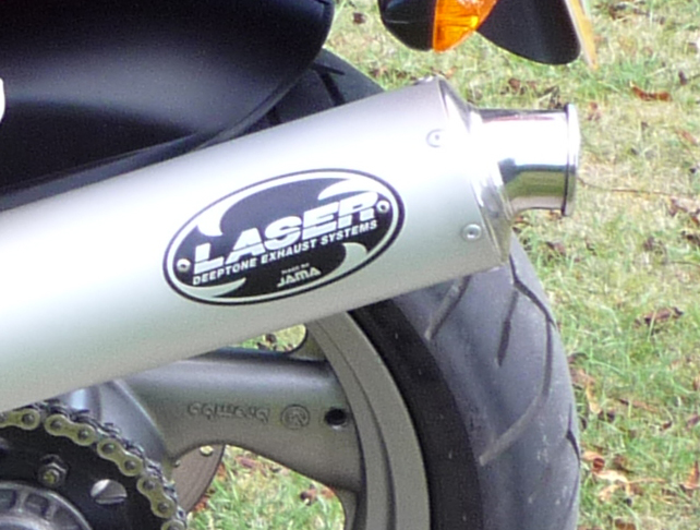

    The cans on this bike are actually LASER cans, I took the foil logos off and will see what method I can find to renew the CF look. There is a LASER logo etched into the can outlet.

  15. I think I still have a pair of proper Lazer curved aluminium oval logos which have a heat resistant adhesive on the back, but usually they are riveted on as well.
    I'm not sure if they have been used (I had two pairs for my Lazer cans) but they should be in good condition. I will dig them out today and see just what they are like.
    I may even have a pair of the foil ones - definitely unused.
    And a pair of the black and yellow ones!
    AL
  16. I'd love to see what the Laser logo's look like. I tried "googling" how to get carbon fibre looking good again and couldn't find any useful info. It appears that 2 pac clear will not tolerate heat so that method is out and that was my first go-to idea!!

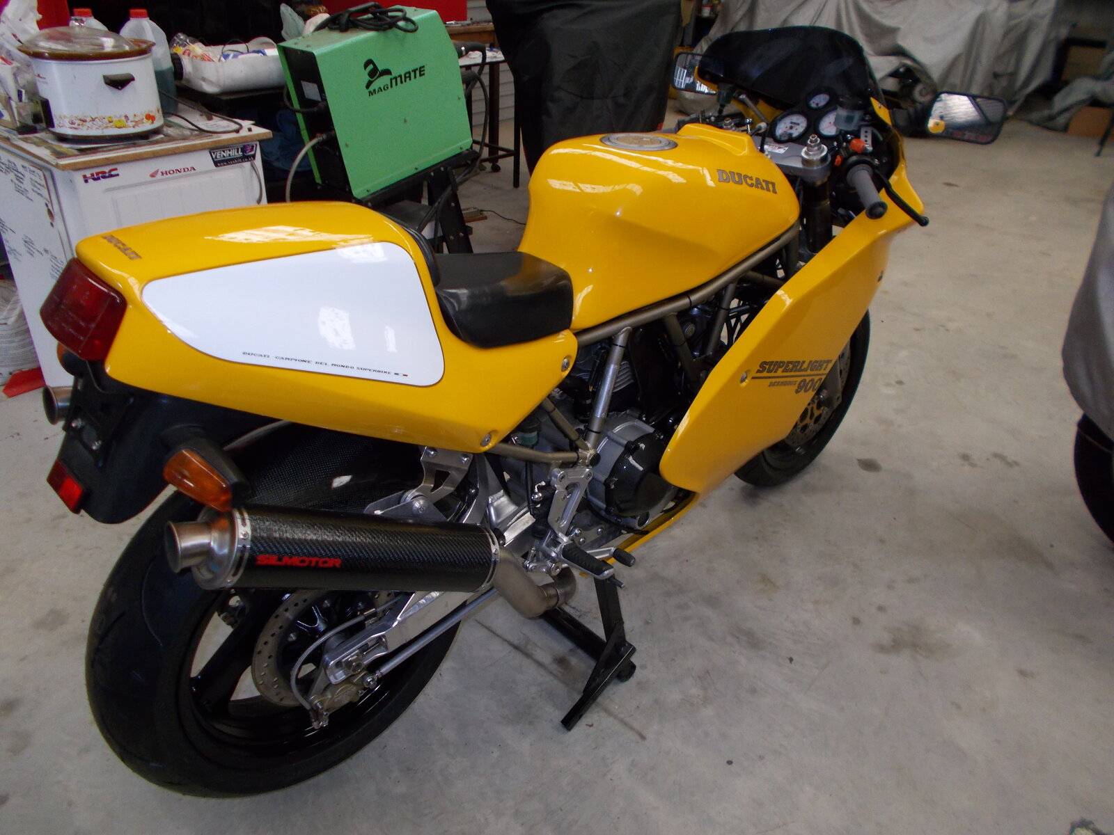

  17. The bike is rebuilt and has been on the road for about 10 months. The Fuel pump was dry stored while I restored the bike and it worked perfectly when the bike was started again. So good result!! DSCN2174.JPG DSCN2172.JPG DSCN2173.JPG
