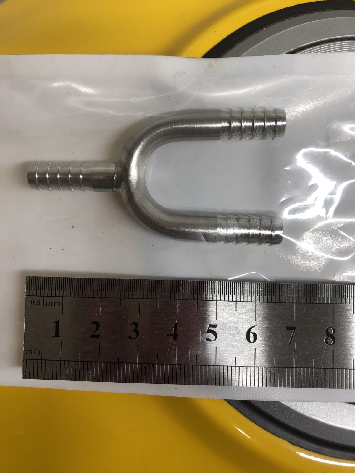

  5. If you use something like I used to replace the standard plastic “Y” piece, you could just compress the return outlet by a mm. upload_2021-8-30_8-45-46.jpeg
  6. I was wondering whether it was worth replacing the 30 year old plastic Y piece before it broke. Might not be a bad idea to to get a metal Y and crimp one side.
    Where did you get your Y piece from?

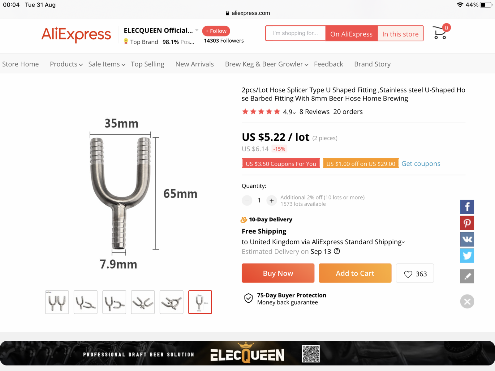

  7. I got it from Aliexpress a couple of years ago - something like £3.50 for 2 at the time.
    I think they are designed for aquarium plumbing so you might find them locally at a pet supplies place. i would recommend anyone with a carb SS to replace the plastic Y piece as mine was as brittle as glass, and I doubt they will be ethanol proof so now is a good time to change it.

  13. You did well finding that fitting. There are lots of Y type fittings but not many with narrow angles and nothing that looks as suitable as the ones you've purchased.
  14. I think these look the same but couldn’t guarantee it

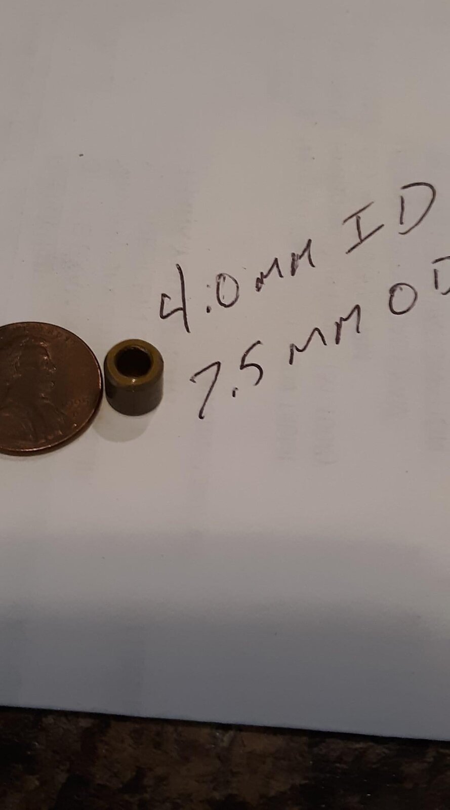

  16. Yes same dimensions 4x7.5x7.5
  17. Great i'll get some bought. Tried looking for these all last night with no success. Goes to show it's still not easy to find stuff without having the proper search terms.
  18. Thanks for confirming restrictor dimensions Paul
