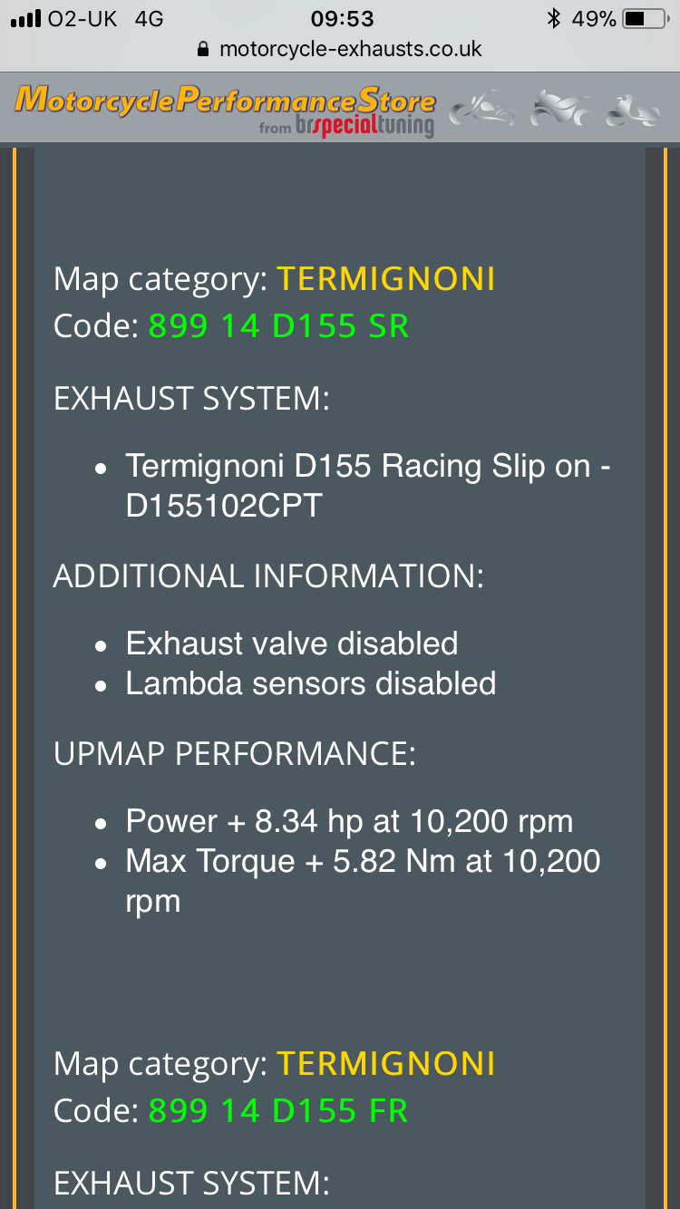

    Note the exhaust and lambda sensors being disabled.
