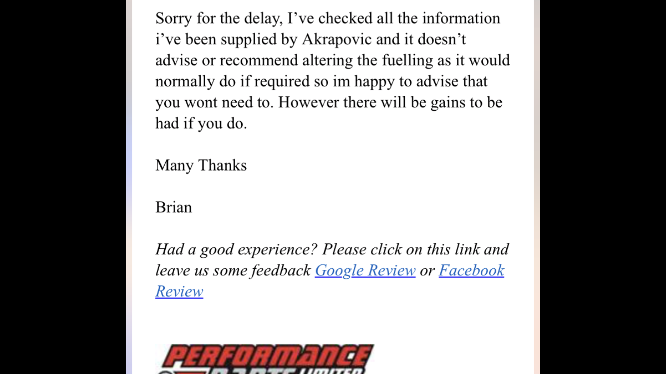

  8. Just looking at their web site and only the end can states plug and play. The headers are not EU compliant and annoyingly there is no detail if you buy both. Andy

  12. Latest email from the UK supplier. F3401EA2-84DC-41FB-ADA8-7C85AB65D409.png
  13. I had the full Akra system on my 2015 DVT for 5000 miles which included a 3000 mile European trip, and there were no issues with fuelling, it sounded and looked beautiful, far superior to the Termi system IMO. I purchased the DucEE to solve the exhaust valve being missing, although there is a solution supplied with the system. There are a lot of people making assumptions and "guessing" whether a remap is required, it isn't. I think the "upmap" supplied with the Termi simply does away with the exhaust valve, and does nothing to the performance, as dyno runs have proved.

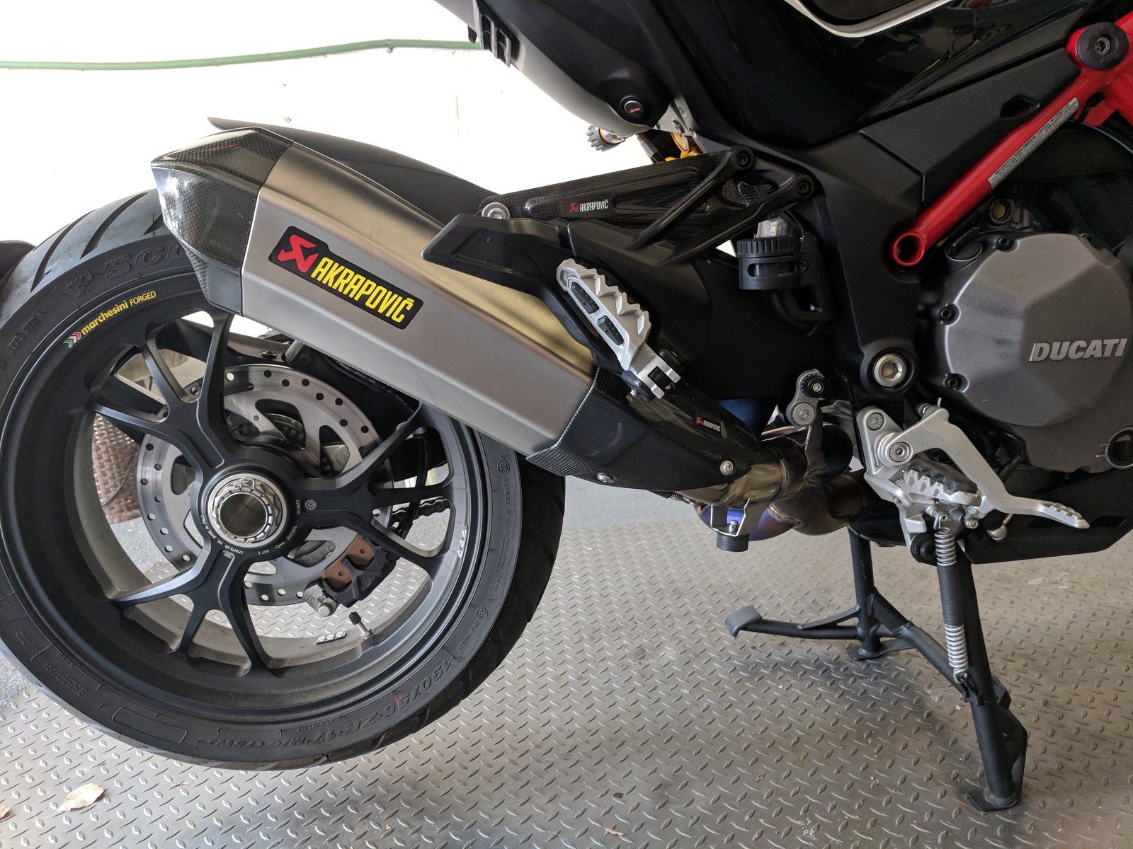

  15. I have Akra headers and Akra Trapezoidal slip-on on 1260 PP for 3,000 km now. Don't feel that the bike needs any remapping, runs great! I have no doubts that it would benefit from a proper mapping, but that applies to all bikes, with or without full exhaust.
    I bought DucEE, hoping I could get rid of an exhaust valve motor completely, but apparently it's impossible without disassembling the whole rear frame of the bike. So I ended up just using Akra solution (aluminum sleeve over the end of the cable). Very simple and works perfectly.
  16. Any photos of the exhaust fitted? Also do you experience and lean deceleration pops??

    Here's a couple of pics, I'll upload better ones when I take the bike out
