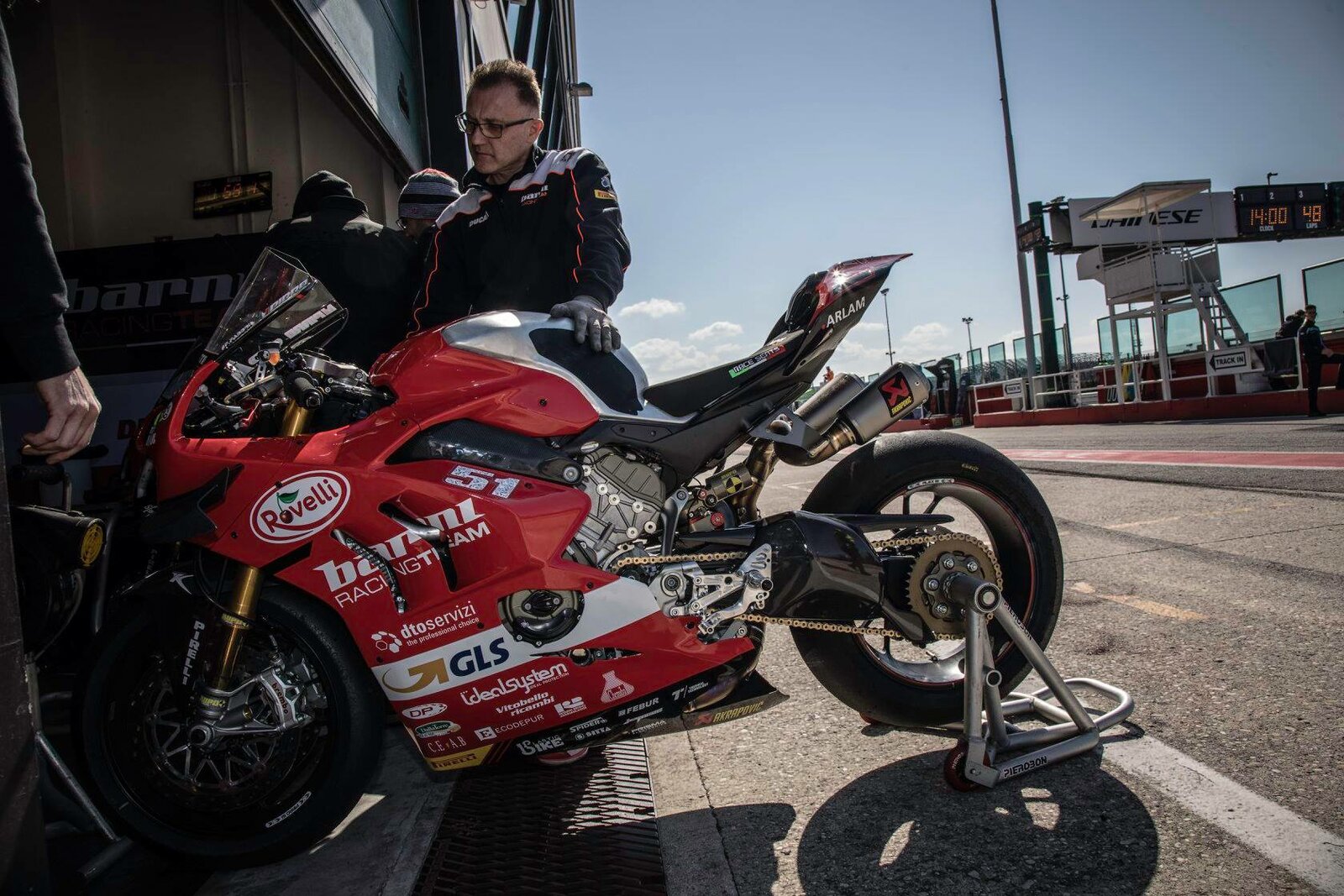

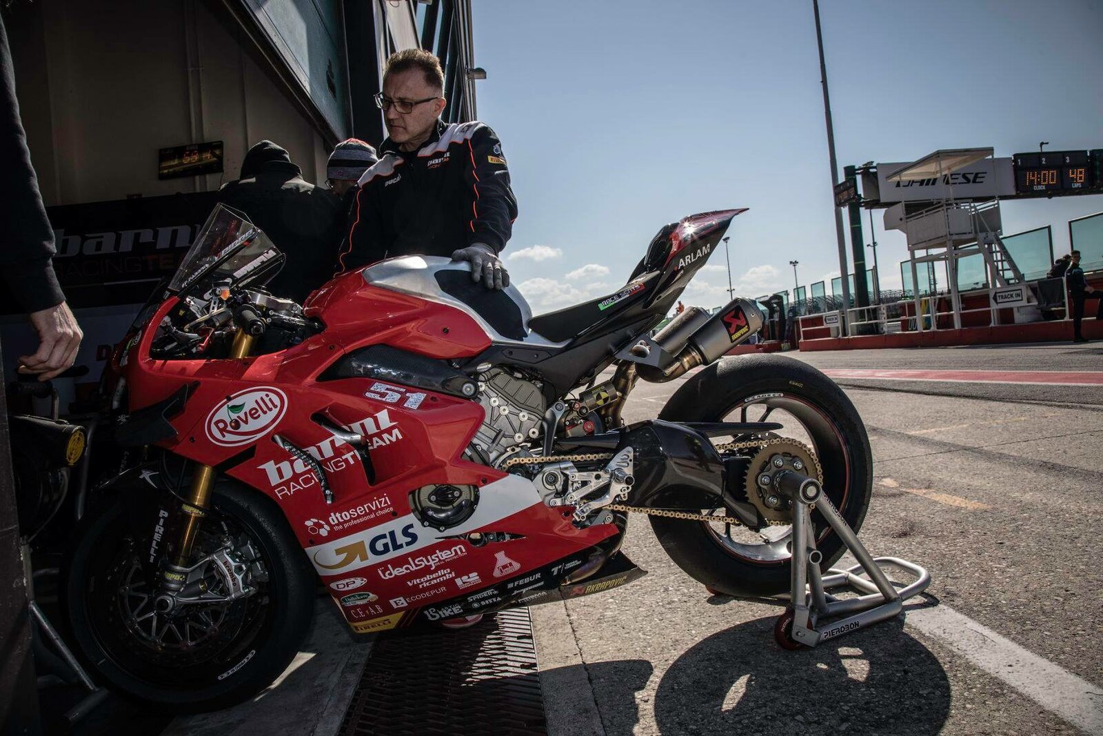

  18. These were on Michele Pirro's bike at the weekend in Misano. The wheelbarrow is back!
  19. Like that a lot :upyeah:
    Wonder if it will become available with an UpMap??
