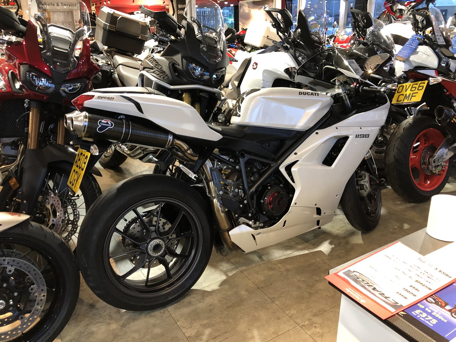

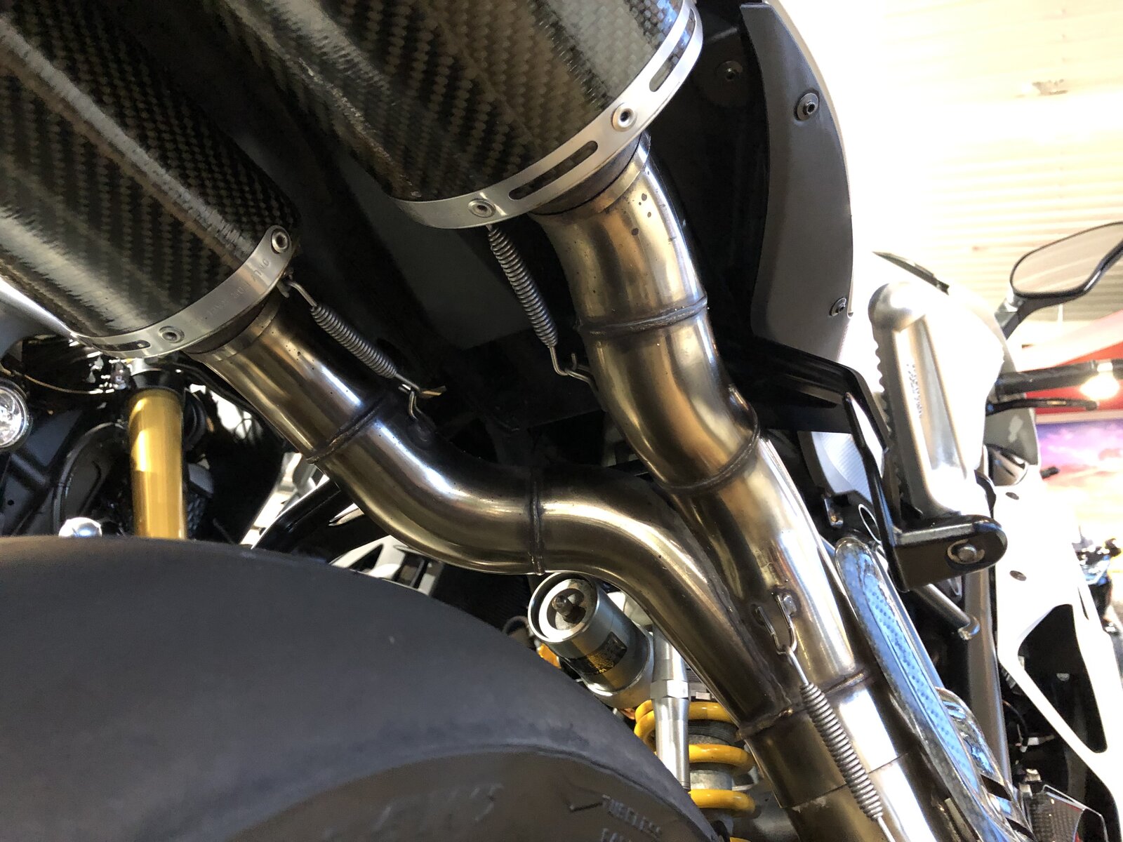

  1. as above so the 1198 has a full system but the dash display does not say racing from memory the 848 I had did say racing, any thoughts? It wouldn’t run properly with a standard ecu would it?
    Ta
  2. Depends, if it has the DP chip it does, or if you have had it custome mapped the mapper can pit whatever you want on the dash.
  3. My 848 ran fine without the map, then had it mapped and runs better, but also now has ‘racing’ come up on the dash.

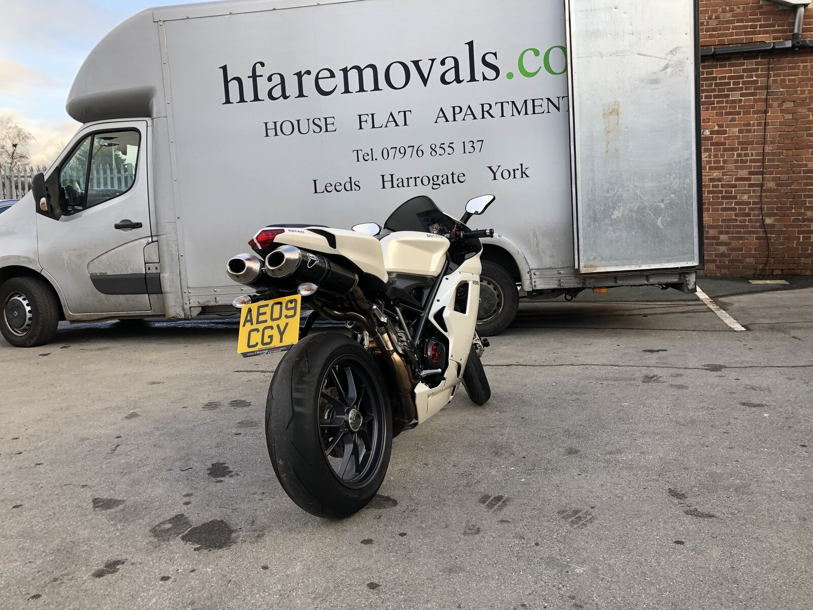

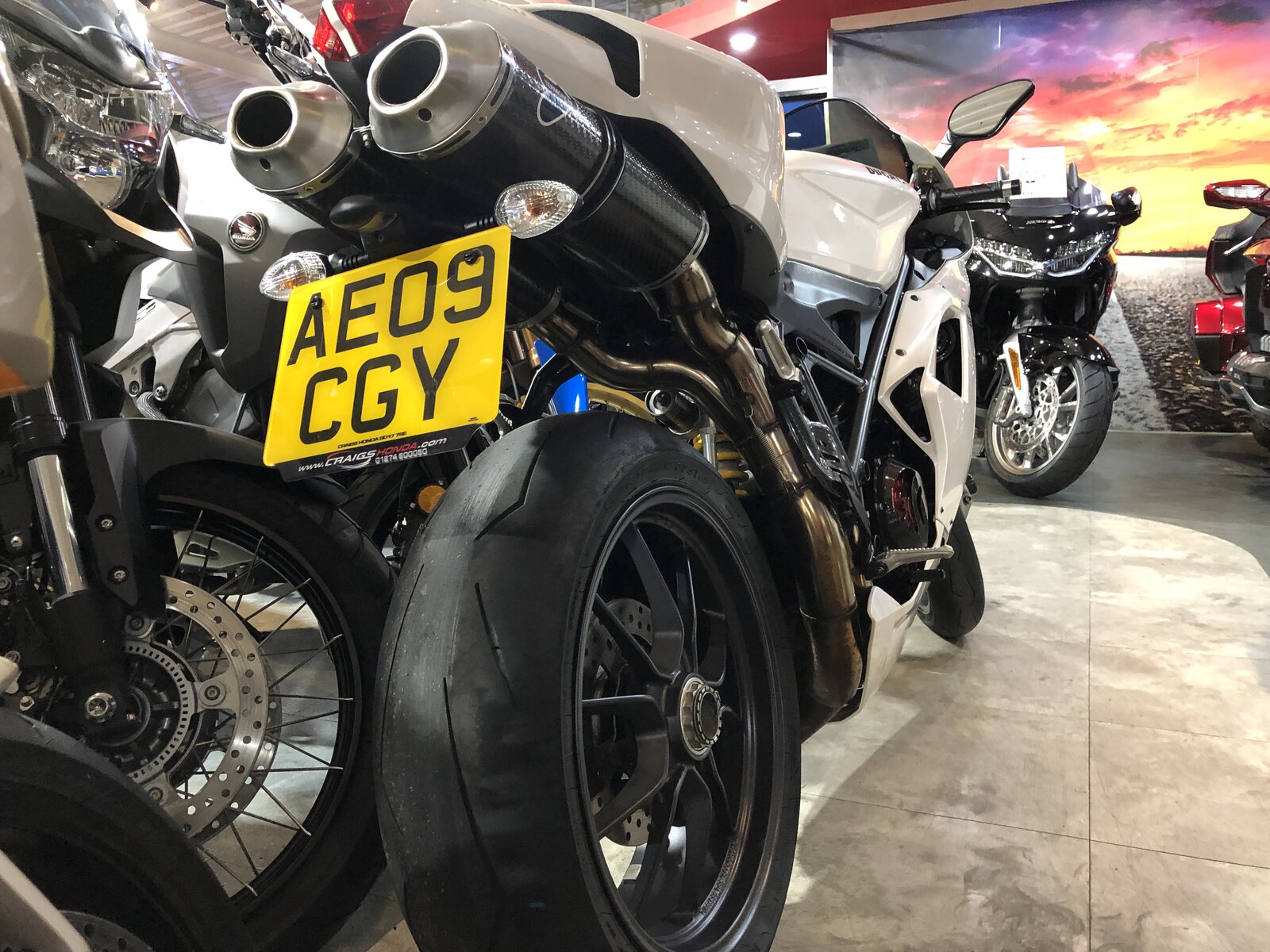

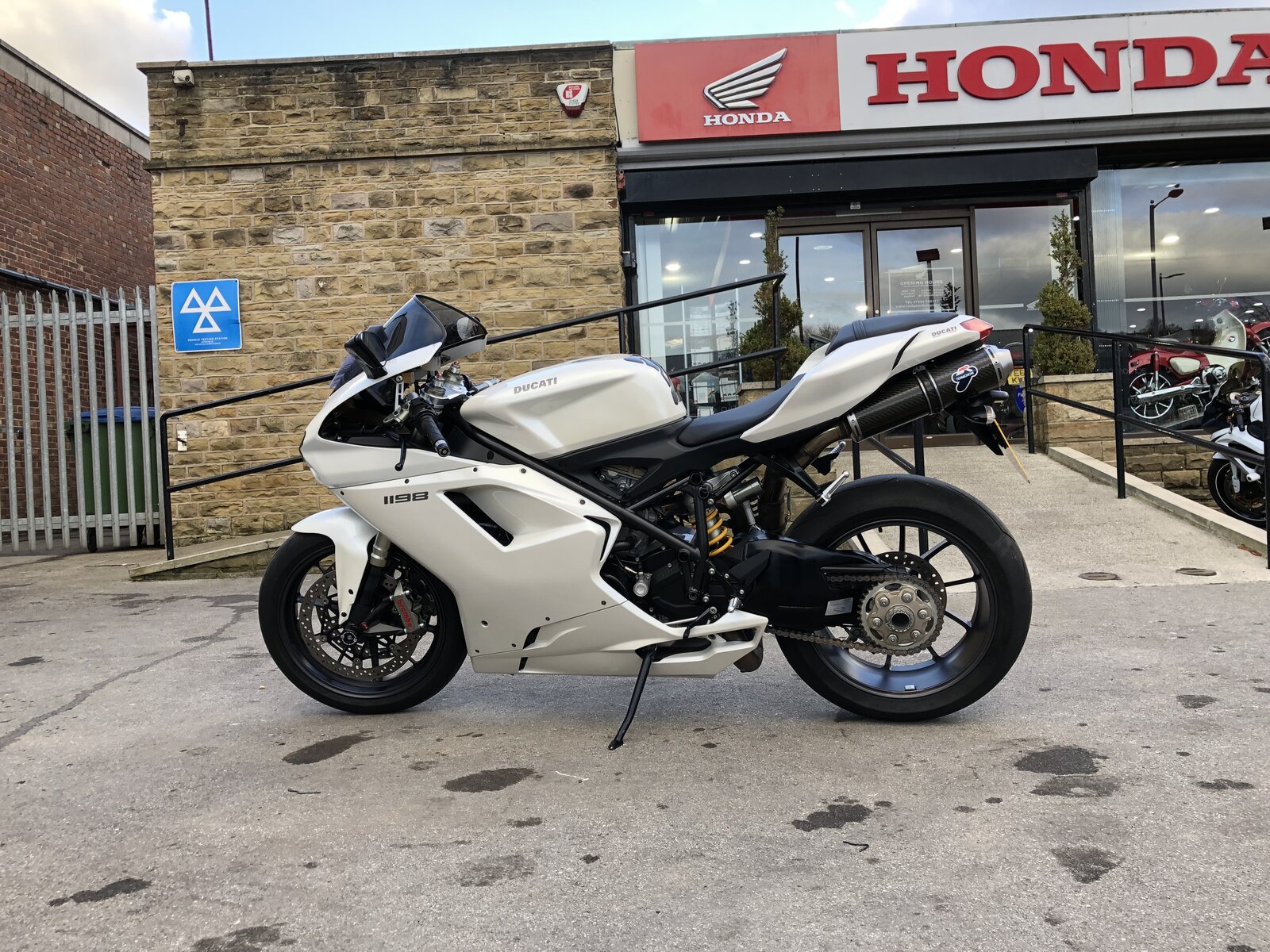

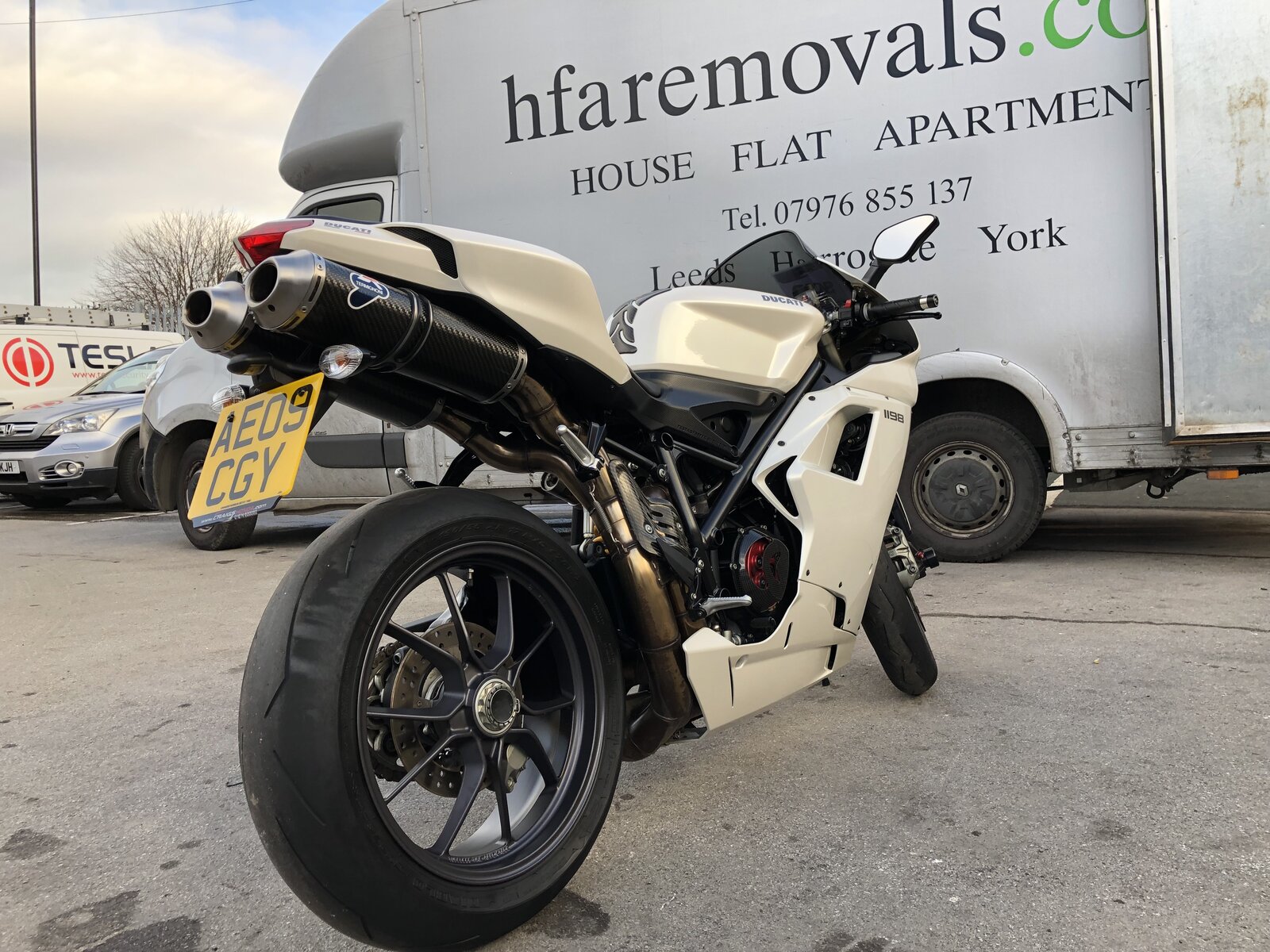

  4. Is that the system? Are those pipes 70mm?
  5. I’d say so yes bloody thick
  6. Look like slip ons to me. o_O
  7. I was wondering, photo is a funny angle but the link pipes don’t look like Hulk Hogans arms as I have seen in the flesh

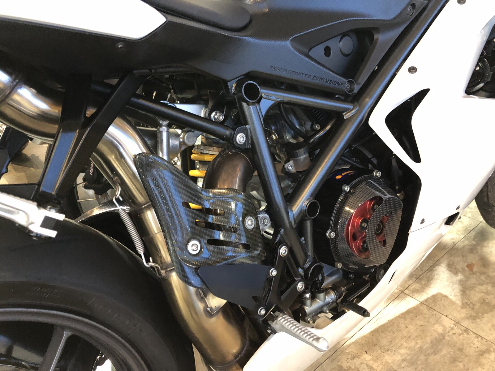

  8. Can't see properly but that heat shield looks like the one on a full system. Should say 'Racing Evo' if it has the full system with a Ducati Performance ECU. As above though if the ECUs been reflashed it can be programmed to say anything or nothing. Have a look at the ECU for the part numbers on it. :)
  9. You'll know if the mapping isn't right because it'll run like a sack of shit!:confused:
  10. No I have had a 70mm system before it looks like one
  11. Yep defo full system!
  12. Ask @chrisw if he can flash it for you.

  13. No Craig’s Honda shiply some really good stock in
  14. Yep, full system, you can tell by the bend just before the end can. I couldn't see it in the original pics with the rear foot pegs. :upyeah:

  17. Dash should say 1198 Race EVO for full system
