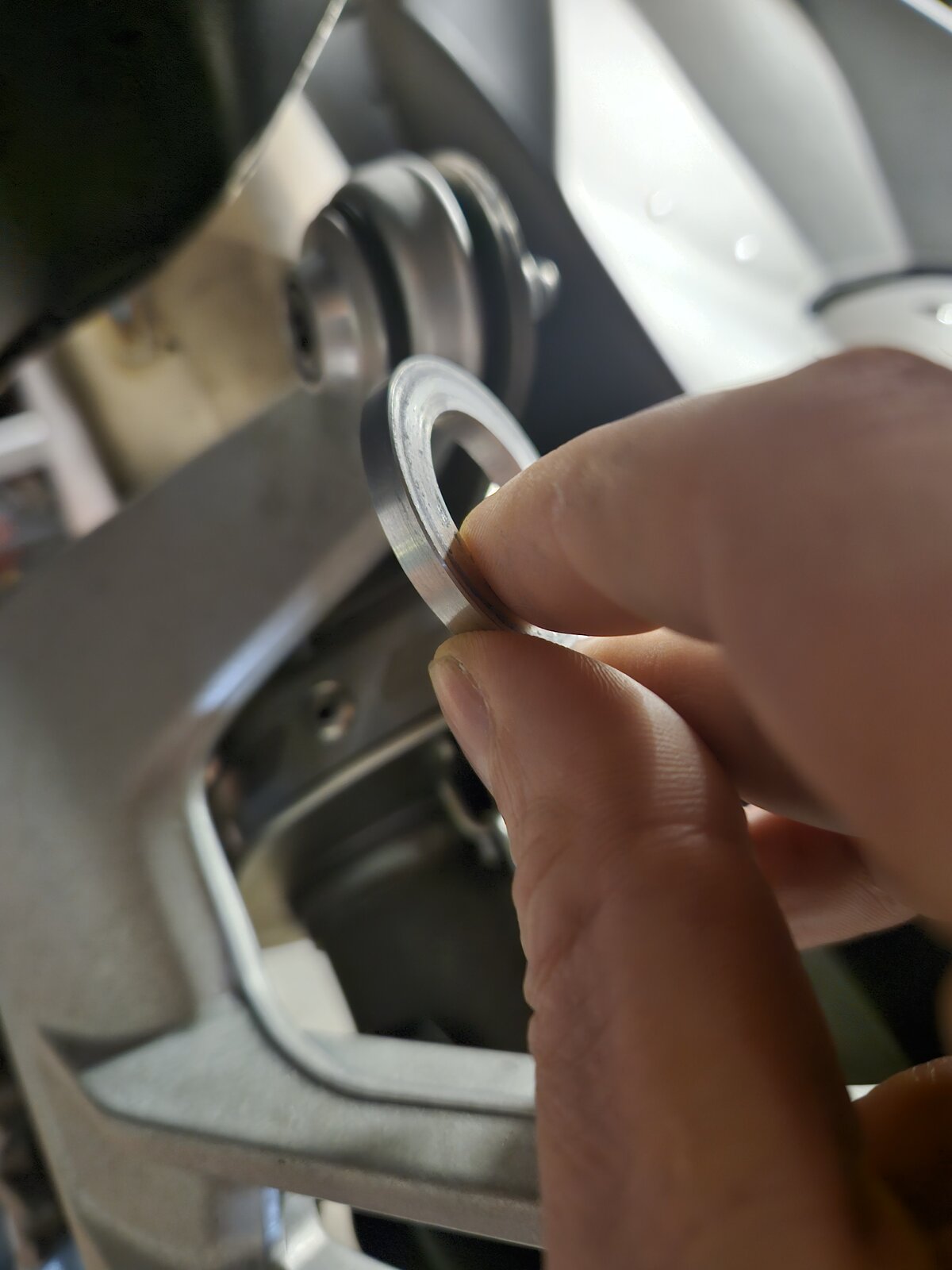

  1. Has anyone got a full termi and can tell me where the aluminium ring goes amongst the two rubber grommets, spacer, bolt, nut and washer for the pillion RH peg mounting?
    As far as I can see, it doesn't, but clearly it came from there as I took it off :D

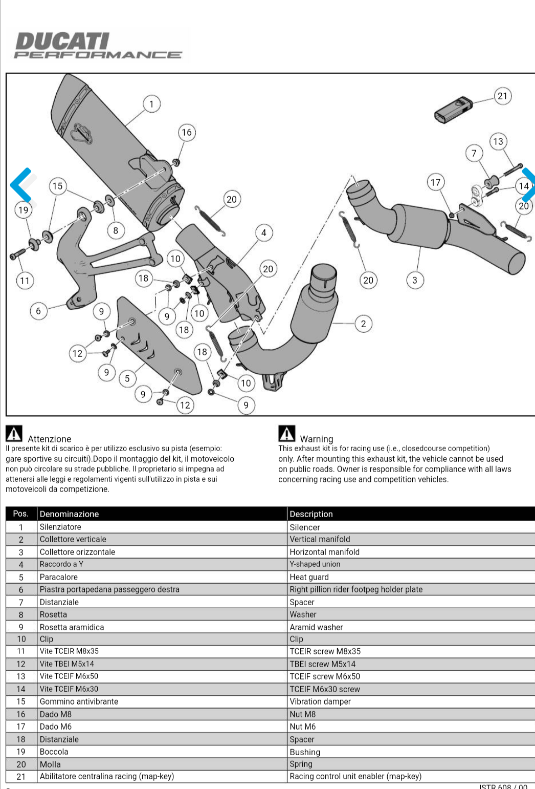

  2. Search some images, but I’m sure it’s just a nut on the rear of the hanger and the bolt sits in a cup at the ‘front’ and has a washer separating it from the pipe.
    So, bolt, cup, washer, pipe then nut.
    Does that make sense?
  3. I don’t know if this contradicts my post:
  4. Then yes, the part I'm curious about isn't shown... Spare parts box it goes then.
    I have nut and washer on the backside of the exhaust mount and rubber, footpeg, rubber, collar, bolt on the outer side of said mount.
