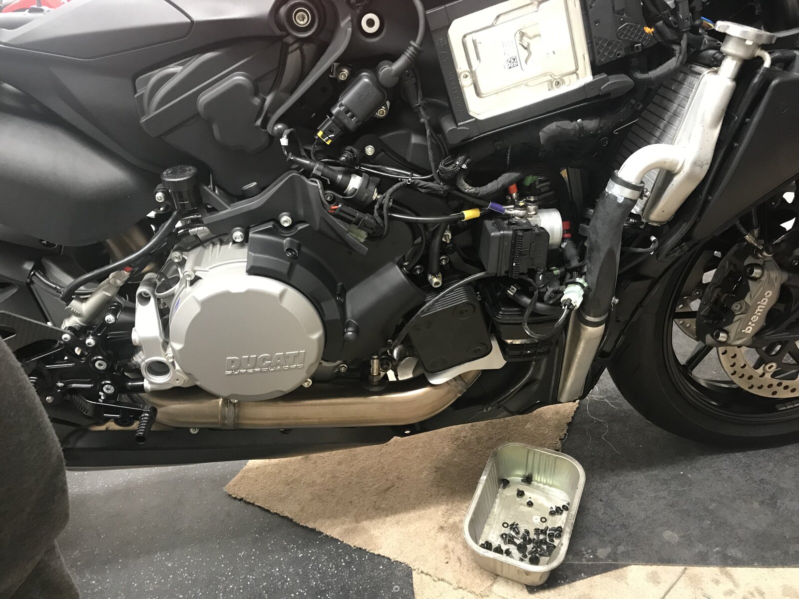

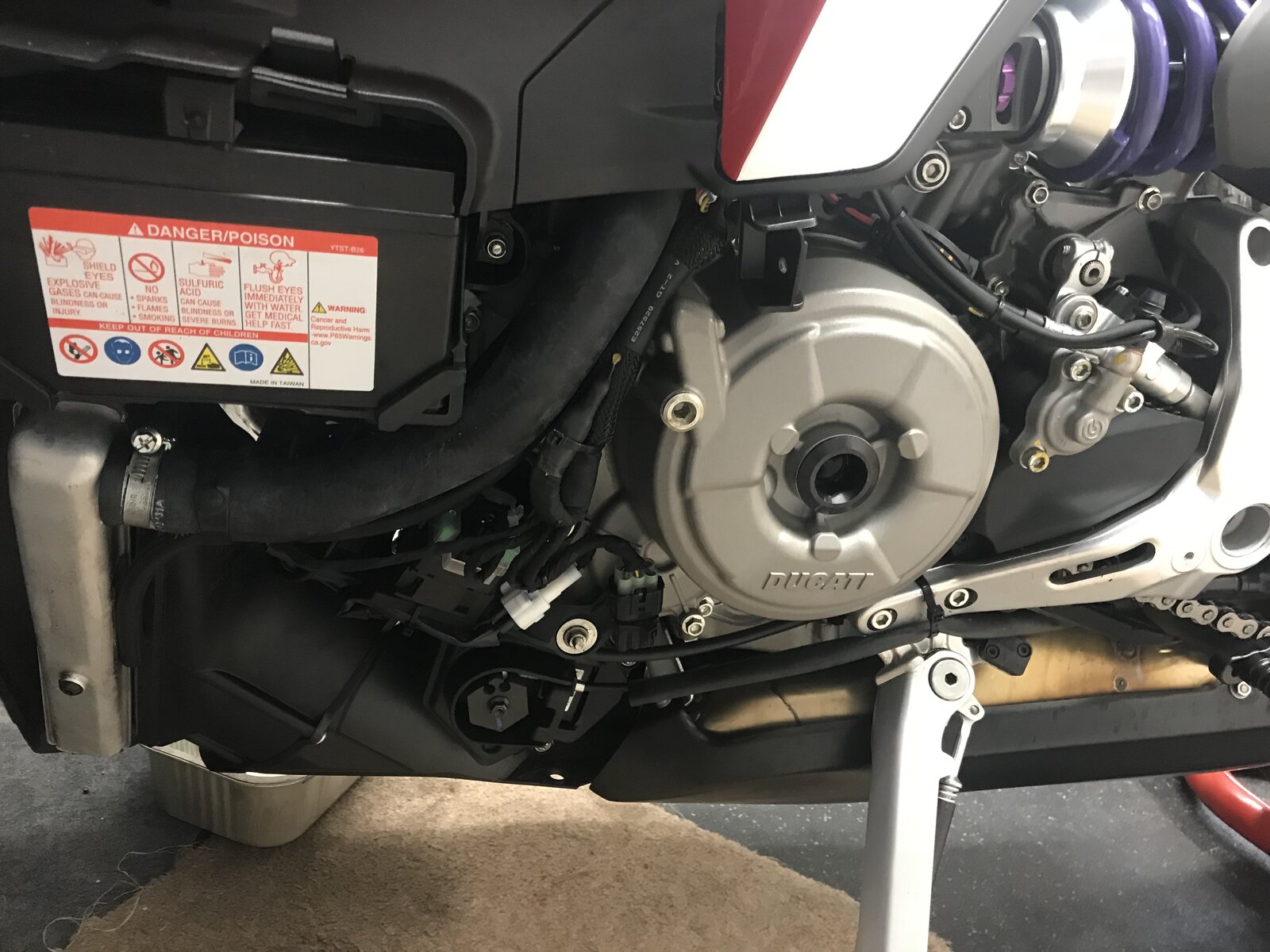

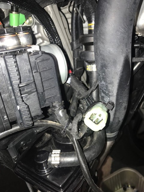

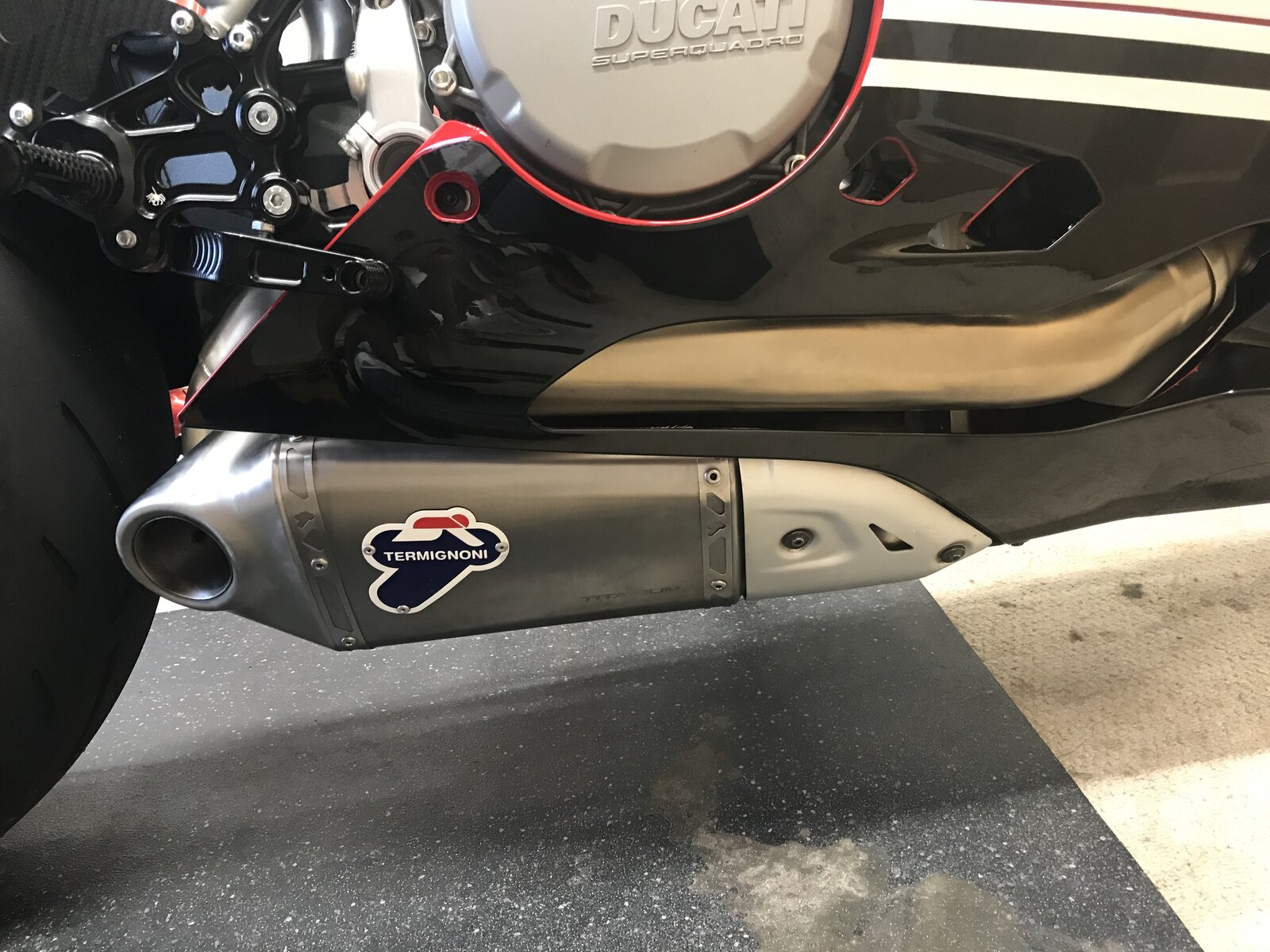

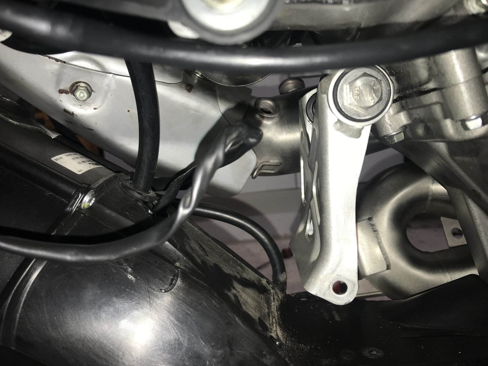

  1. For those that aren't in the know the full 70mm termignoni system from the 1199 and 1299 with no modifications necessary. The job is a pain in the backside though and you do need a very good selection of tools.

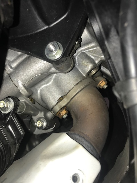

    After I removed all of the fairings other than the headlight fairing I started gaining access to the original exhaust. The left hand foot hanger needs to be removed to access the bolt holding the silencer on. Be careful as the angle onto the bolt is slightly off and it could be easy to damage the hex on the socket cap bolt.
    The evap filter bracket needs to be removed and the filter pushed over to access the bolt for the lower rad fan housing plus you need to remove the lower bolt too and this allows the housing to be swung slightly to give access to the header bolts for the horizontal cylinder.
    The rear cylinder header bolts aren't too bad to access though
    The exhaust servo and housing needs to be removed for the forward bracket
    Assembling the system was fairly straight forward compared to removing the standard exhaust

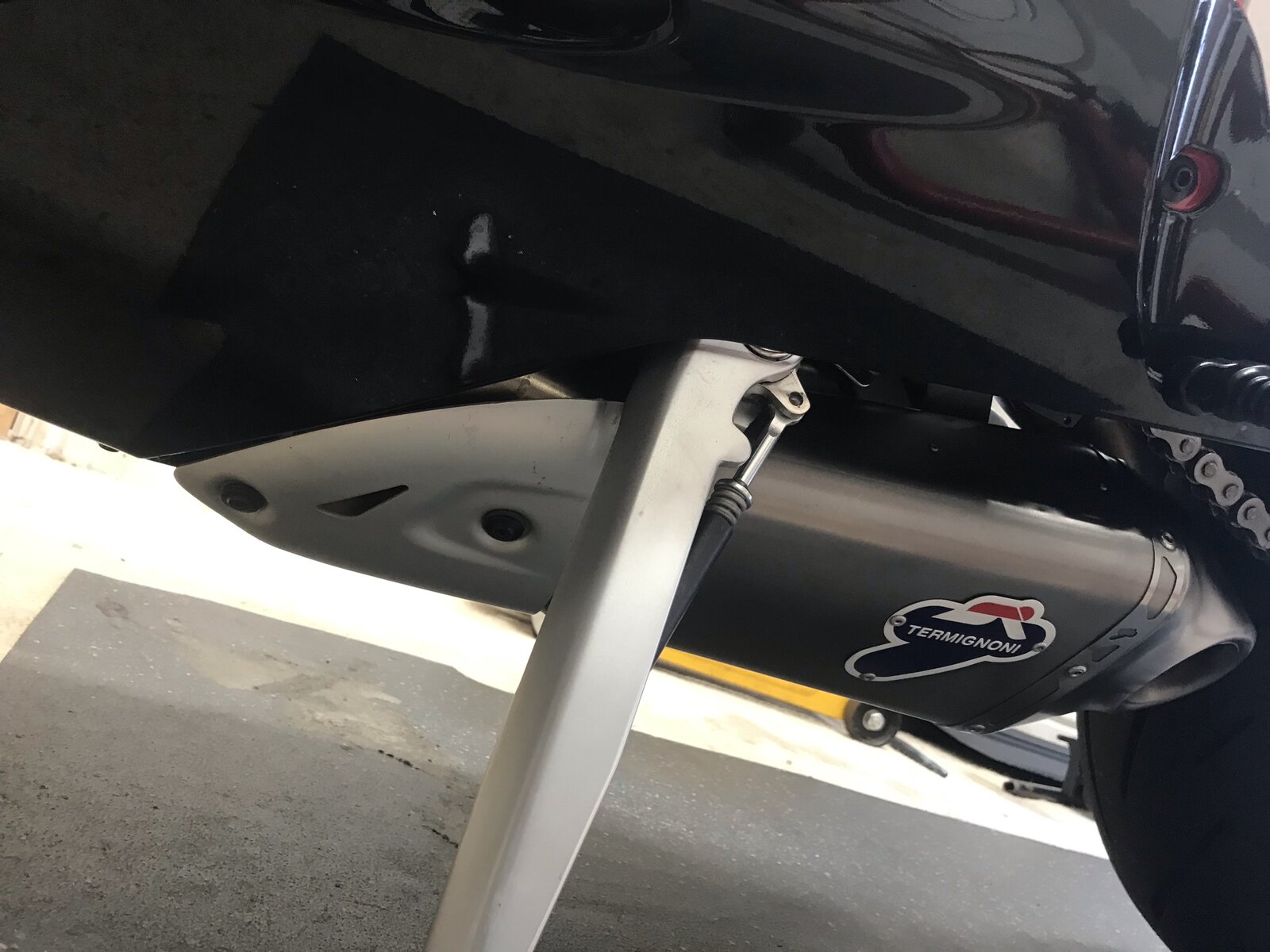

    I had to make up some spacers for the heat shield as the second hand exhaust I bought didn't include them and was missing a few of the correct fasteners.
    I've ordered the upmap kit and will load up one of their maps once it arrives.

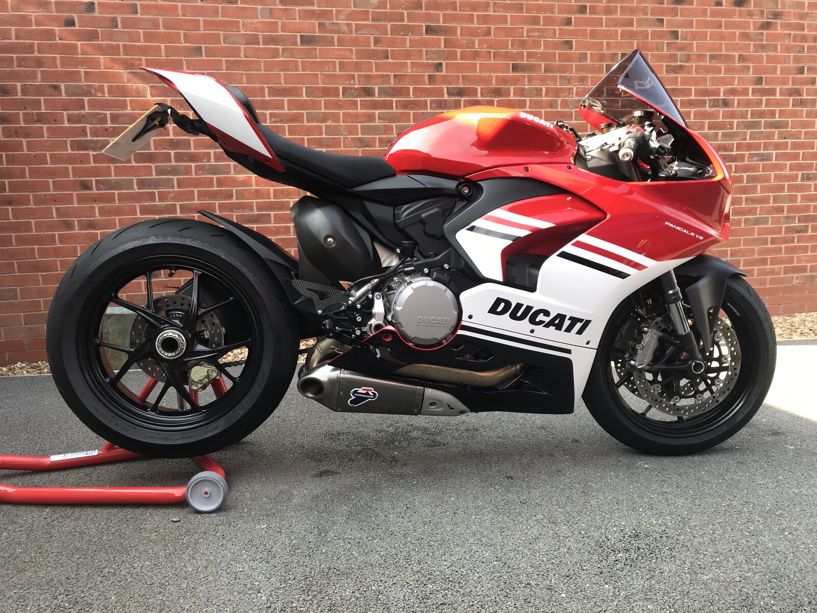

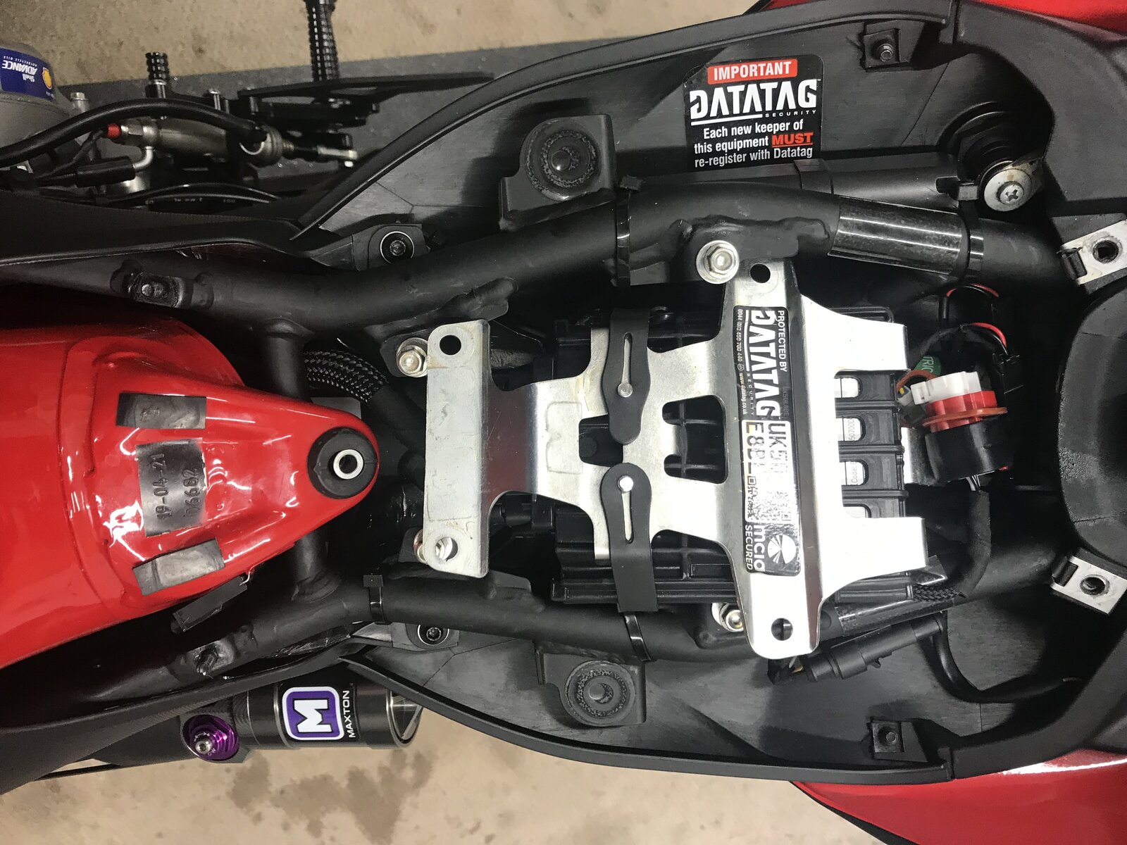

  2. I received my T800+ and lead today and uploaded the correct map for the system. The user guide is very helpful as I couldn’t change the language on the app from Italian to English. After the upload I took the bike for a very quick spin. On start up I now get racing evo on the screen plus I have an additional map setting(sport). On the ride I instantly felt the bike pick up much much better at low revs when setting off. The mid range feels stronger too. Very pleased with the upgrade and it only cost me just over £1000 E8C958E9-C79D-4F37-AC27-2A7DD5FFF138.jpeg 39188FC7-1C89-4192-BF24-BA0DABC6ACD3.jpeg 3DF0316B-4EF7-40AE-8939-5E1D8C6B651F.jpeg

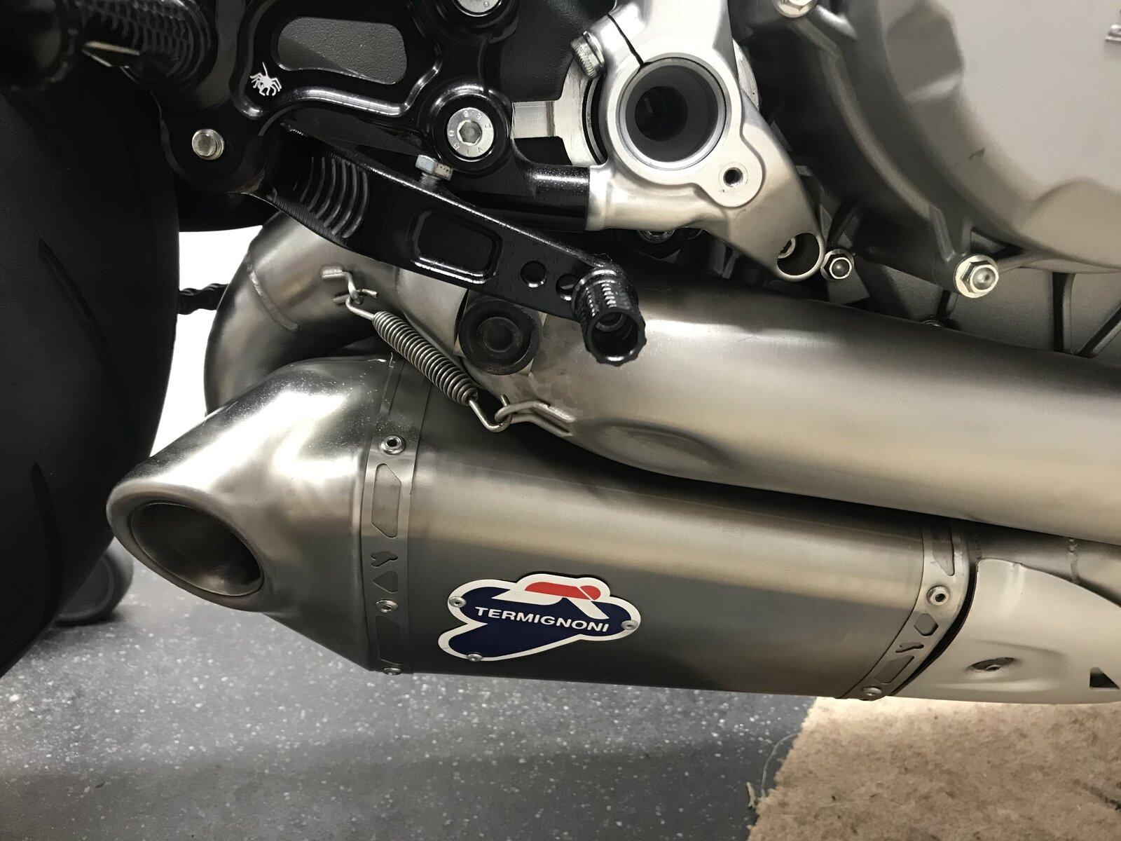

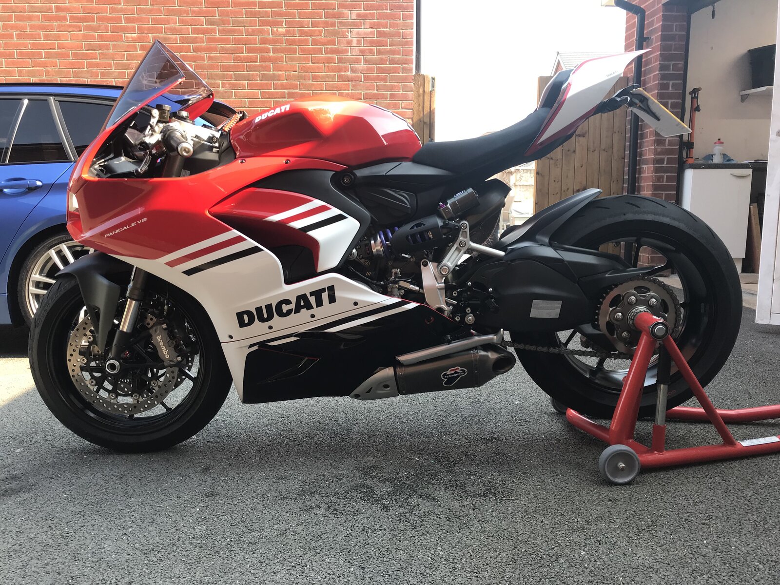

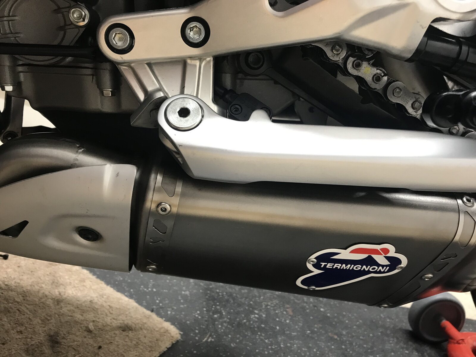

  5. Good to learn the 899/1199 fits the V2. Fitted the full system to my 959.
  6. Nice bike. The fairings work so much better on the v2 than the gen1 v4.
