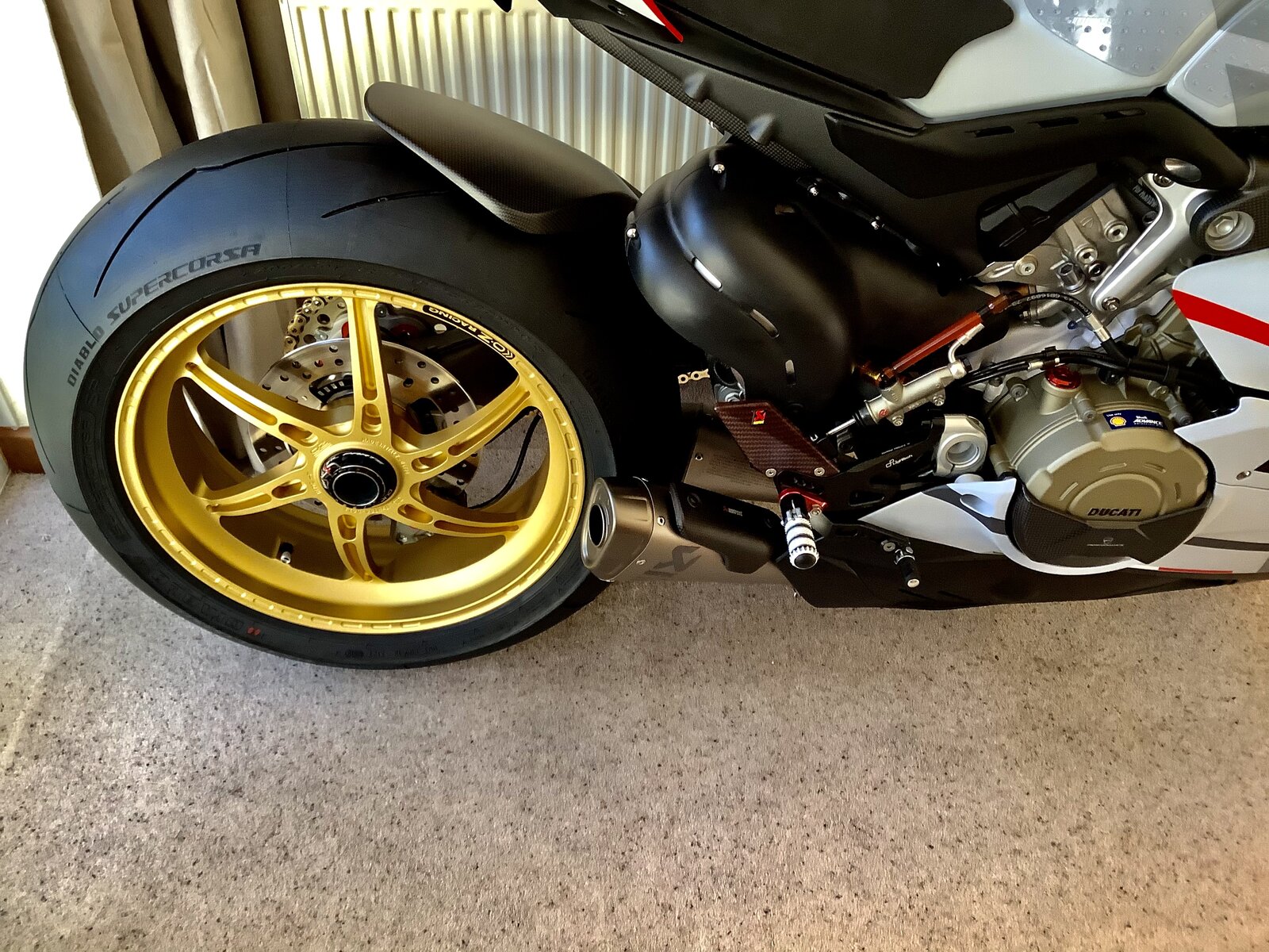

  2. Yep, I fitted one last year but have since removed since I upgraded to the full akra. It’s not a simple install. Tank had to come off, all four subframe bolts removed. Wiring loom loosened by snipping zip ties so that the subframe could be ‘folded’ over to rest upside down on the bike. OEM inner heat shield was assembled inside the FullSix cover and bolted to subframe before ‘folding’ subframe back into position and refitting (bearing in mind that the subframe bolts are single use). I also found I had to remove the right rearset iirc this was in order to be able to reposition the subframe with exhaust cover attached.

  8. Thanks James, the missing link must be removing the subframe!

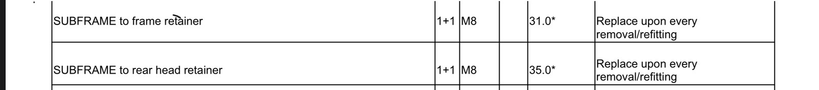

  9. Thanks James, all clear now but the subframe bolts don't seem to be single use as steel?
  10. replacement is recommended (below taken from 2018 Panigale V4 torque specs document)
  11. Thanks James, where did you find that?
  12. Thanks again, I just received this that would have been very helpful in advance!
