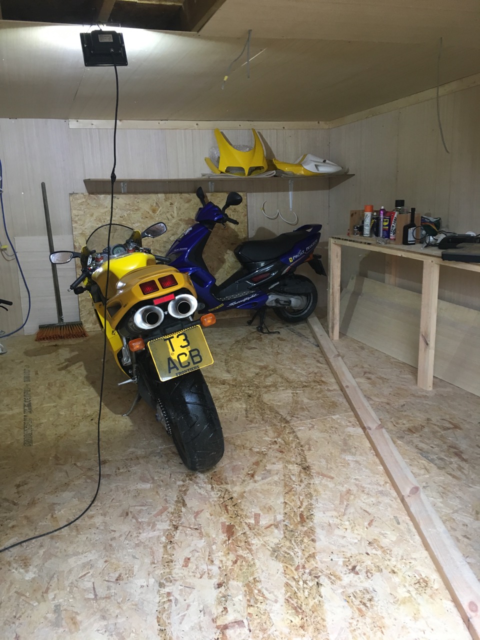

  1. Over the past few weeks I built myself a garage to store the bikes, present & future, in and in which I can work on them regardless of the weather outside, which here in Ireland is :splat::splat::splat: over the winter months. The 748 needs a complete strip down and refurb complete with all those OEM nuts/bolts/screws being replaced with s/steel or Ti. I put a raised floor in the garage, even though there is a DPC under the concrete pad I laid, as I didn't want the cold coming through the floor to affect them, or me :).
    So the question is, and the advice which I seek, what's the best way to cover the OSB board on the floor? Same with the workbench tops which are marine ply at present. All suggestions/advice from those in the know is gratefully received.

    I don't find OSB board very good with wear and tear.

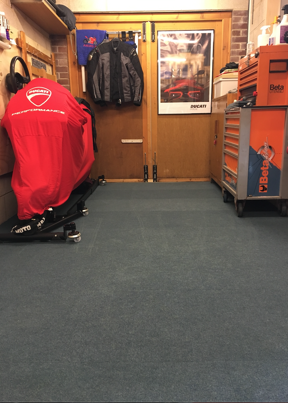

  9. I have Carpet tiles down also. Easy to replace, I haven't stuck them down so they have the tendency to move if I drag anything across the floor, easy enough to correct though.

  15. I'd seal the timber boards with a simple floor varnish, don't know the overall floor construction and how concerned you are with insulation. But as mentioned, a tile would be better, it's not a commercial garage so a contract carpet tile of vinyl tile would suit. Vinyl would be better, non slip type. I wouldn't use a foam or soft product, get mats for lying around the floor or a bike bench, expensive bloody things. If funds are an issue just do a small work area. Your stand etc will beat up the wooden floor

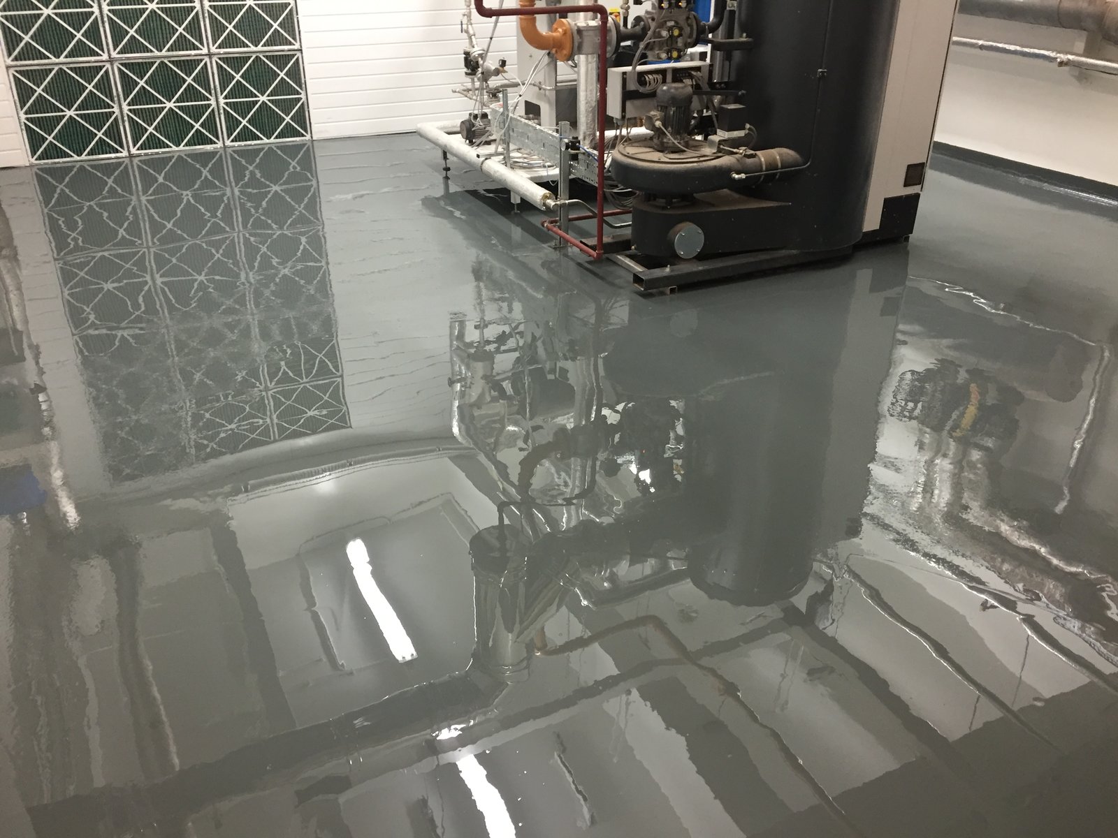

  16. Personally, I'd still seal the OSB with something, even if its a water based varnish or sealant. Its bad for holding water and damp and may eventually peel if left unsealed. What anyone else says for tiles. Concrete floors can look great if they have the right system down, but you'll never stop the damp from condensing on the floor I've noticed particularly in my own garage on an epoxy like below... ADM Boiler House (6).JPG
  17. Get a dehumidifier if you have osb.. hopefully over a plastic membrane or it’s likely to warp
