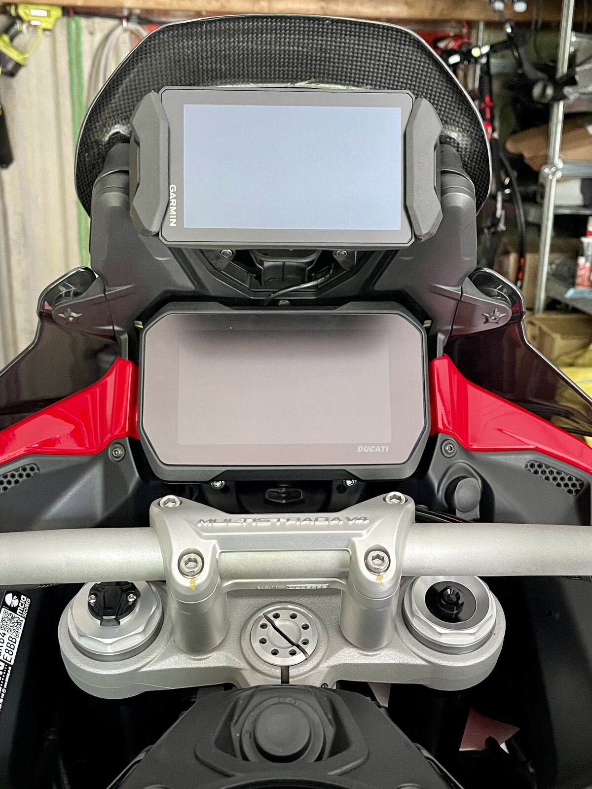

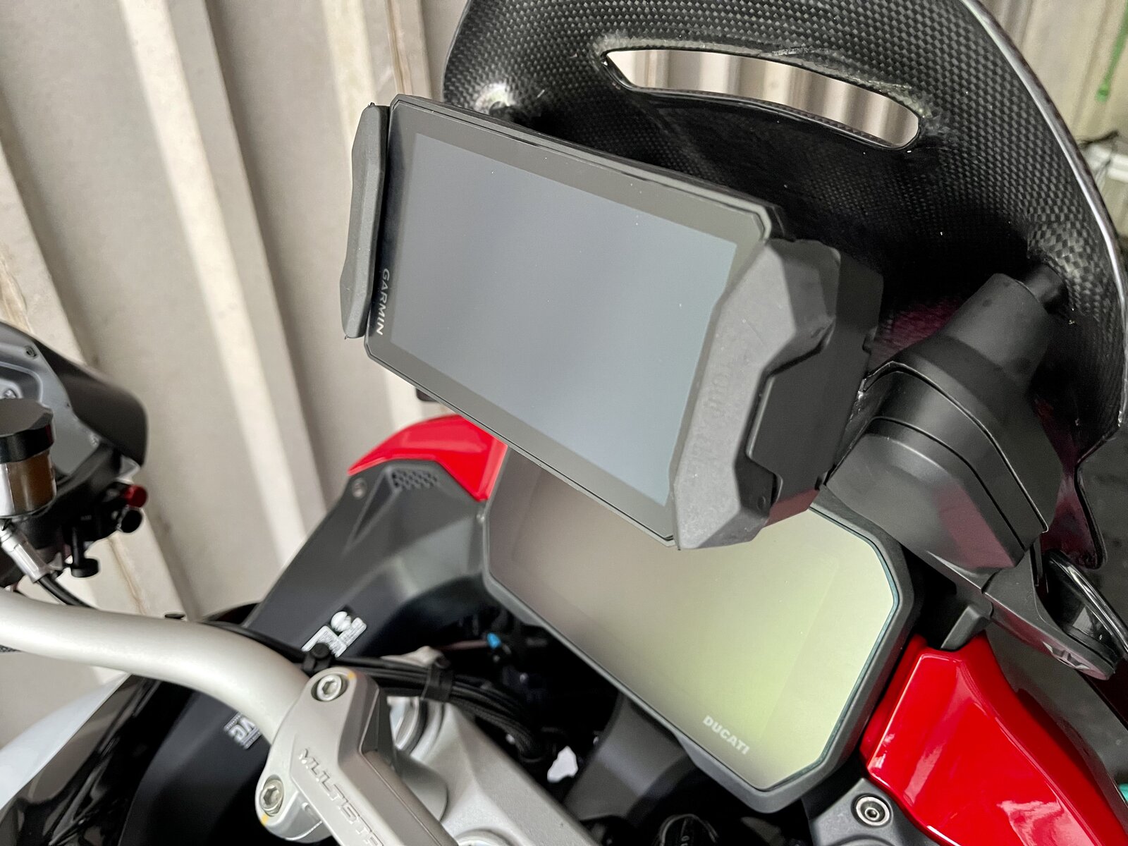

  8. Carefully remove, slice open the small white pre-fitted NAV cable behind the DIN socket cover, solder the Zumo cable to the removed white plug and plug back in to original socket. Cable tie the Zumo cable to the back of the Iconic mounting bracket. The cable automatically tucks itself down the back of the dash TFT when I lower the screen and there is enough slack when raised. Also cable-tied the excess cable and tucked it behind upper fairing where the DIN plug is.
    I also recommend the Touratech lockable Zumo XT mount... saves having to pocket the Zumo each time you get off for and leave it for a few mins. IMG_2172.jpeg IMG_2176.jpeg

  9. that looks very neat, certainly compared with older Touratech lockable mounts, I think I will be off to Rugged Roads to get one, thanks.
  10. It is very neat..not too badly priced…. I got mine from Touratech.co.uk but took a while to be shipped from Germany… worth it though

  16. Today was the first ride with the Xt on the Iconic bracket, it wobbles a bit, hopefully the Touratech lockable won't make that worse.

  18. There is a small amount of wobble but given the type of assembly the Iconic one is there's not much can be done about that. It doesn't bother me tbh.
