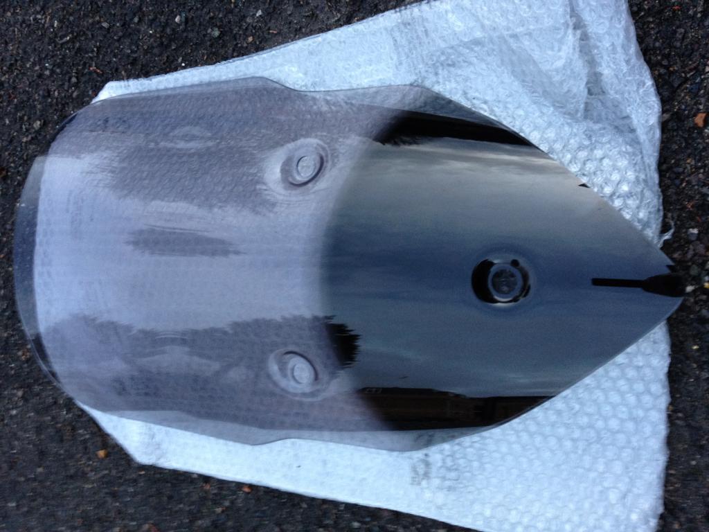

  18. Unfortunately I have time on my hands because in addition to being rough, I can't produce my work and therefore I'm not earning......
    ....so I might have to start selling a few things.......
    .....like this for example......(approx 750mm x 500mm)
    AL
