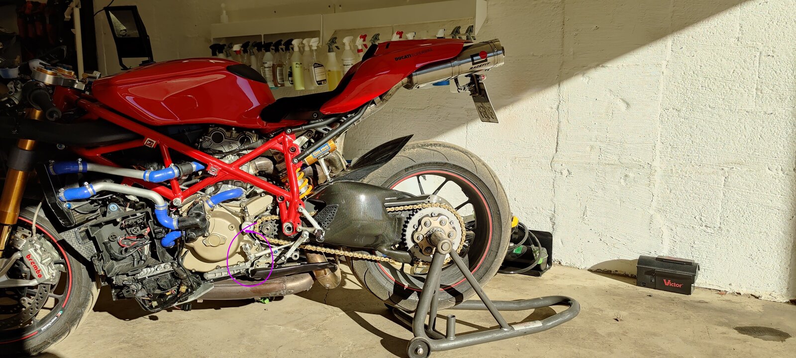

  4. Make sure the linkage is at a 90 degree angle on the linkage arm after the adjustments.
  5. Is that front ( gearbox end) and back (lever end)?
  6. You want a 90 degree angle here:
