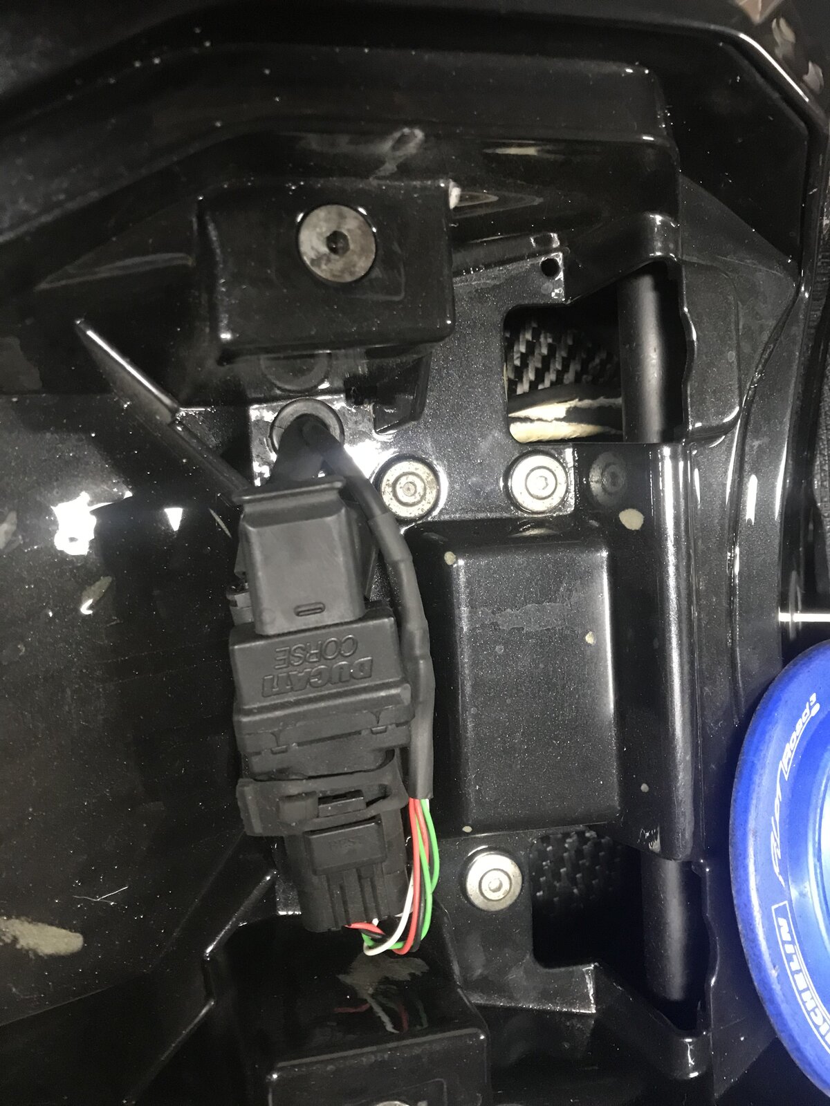

    Note if you are connecting to the plug under the seat, the plug on the heal tech device is too big to thread through the hole for the wires.
    I had to cut the wires & rejoin them. The system works ok with connectors in the wiring though

  5. I just fitted my Healtech gear indicator to my 1198s and there is no need to cut and join any wires at all.The holes under the seat cowl are plenty large enough to pass the plugs through.If you cut wires your warranty is out the door.
  6. Yep, perfect, I've just fitted mine and it's really amazing

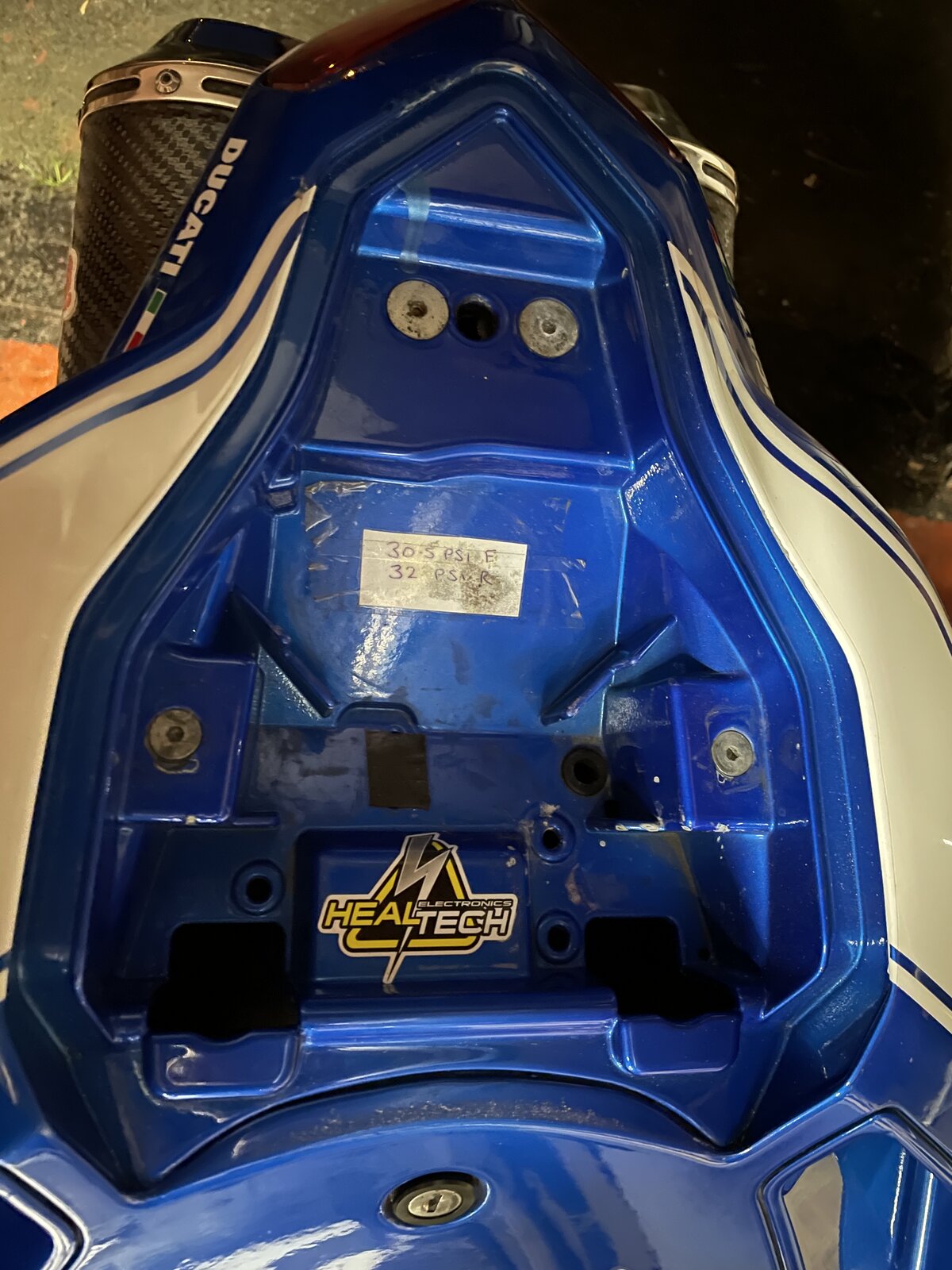

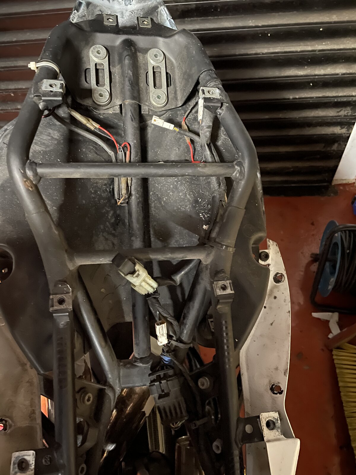

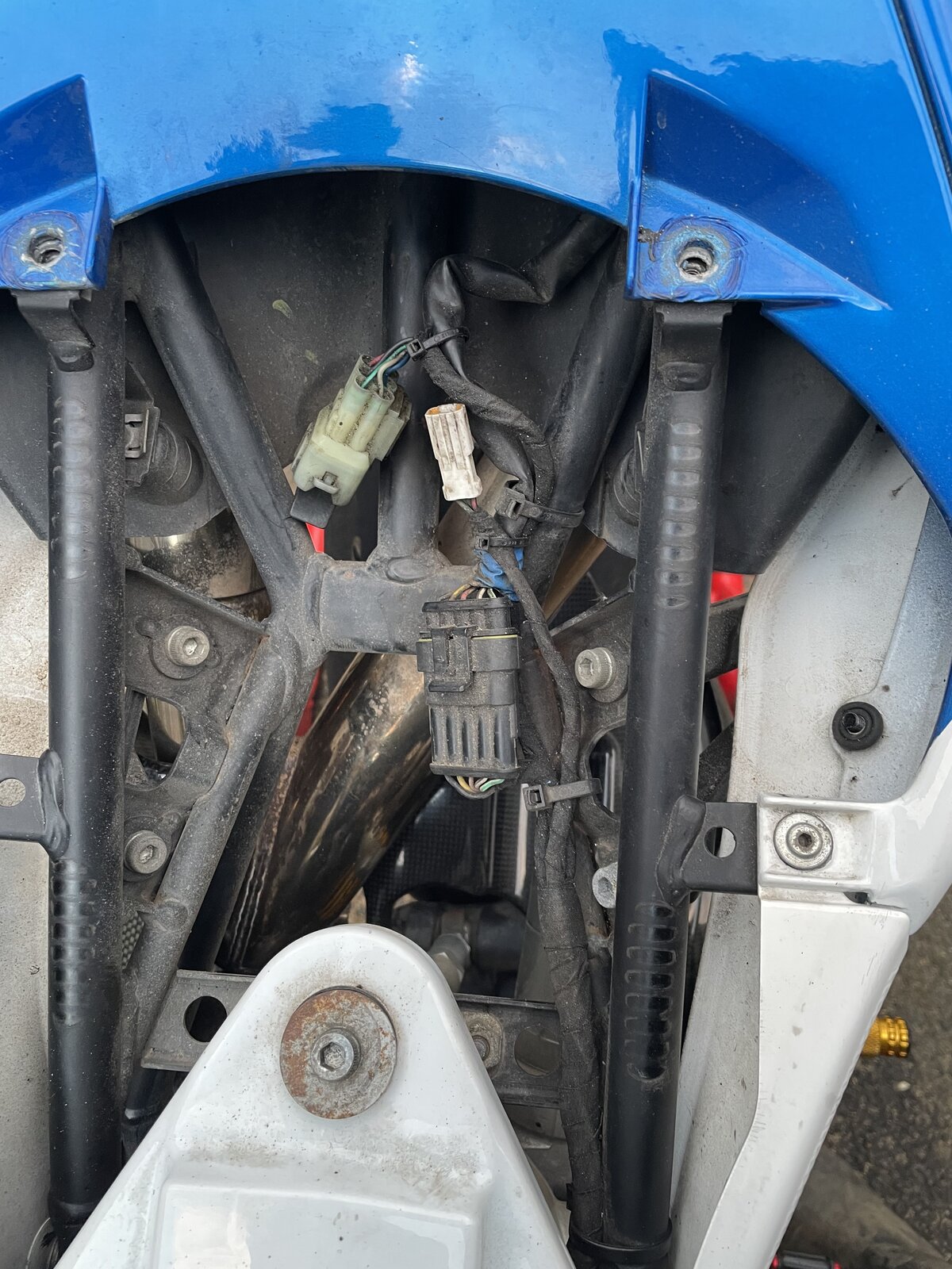

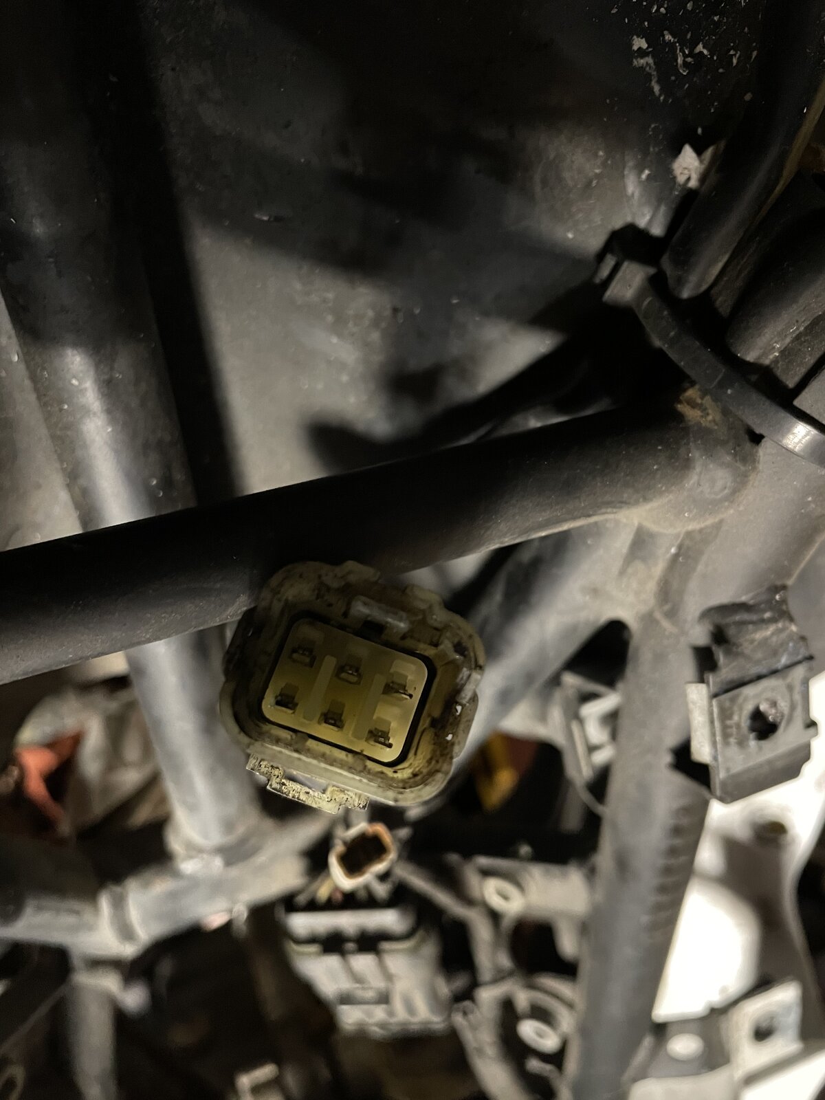

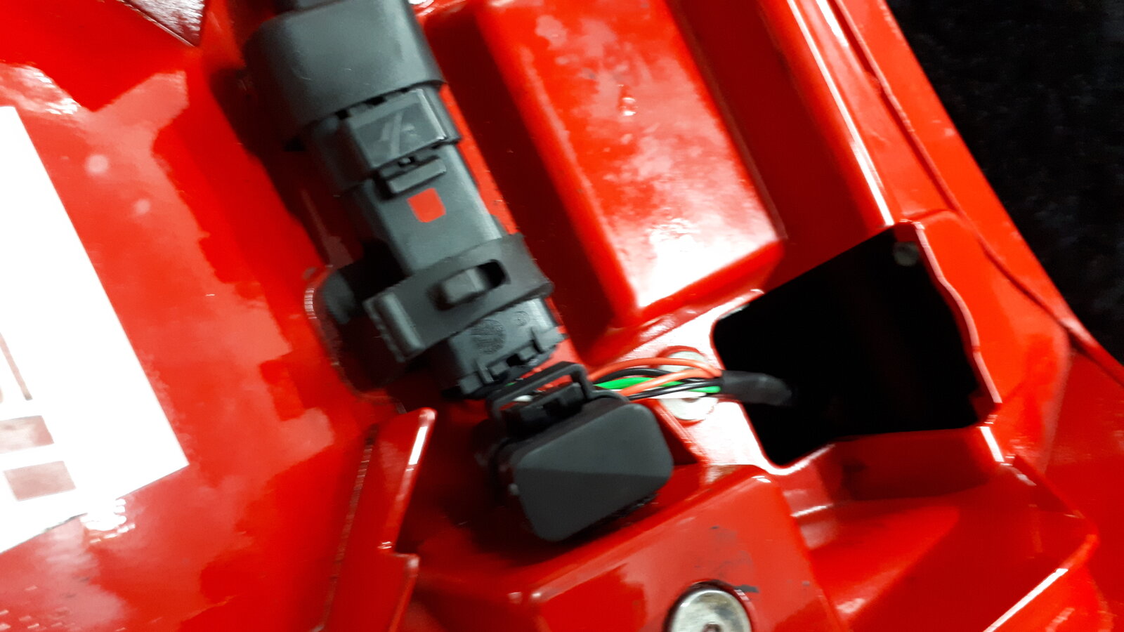

  18. I bought a healtech gear indicator for my 2009 1198, seemed easy I thought - but no, connector not under the seat, so I removed the rear cowl (needed a good clean and polish so not an entirely wasted effort)
    There is the 6 pin connector (the clear plug with a blank in)
    so am at a bit of a loss at the moment - Healtech have been very helpful so far in a couple of emails
    Couple of pictures - mine is the blue bodywork, the read is what I should have
