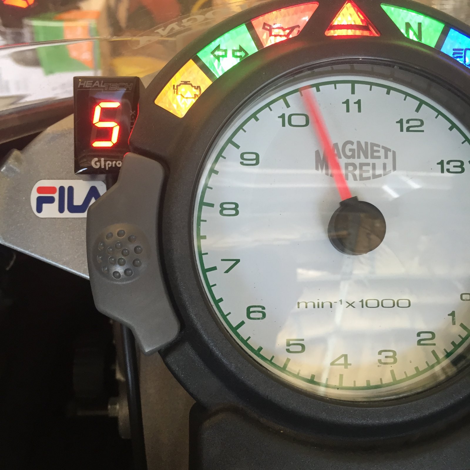

  10. pic of how you positioned the display???
  11. this is where i put mine
