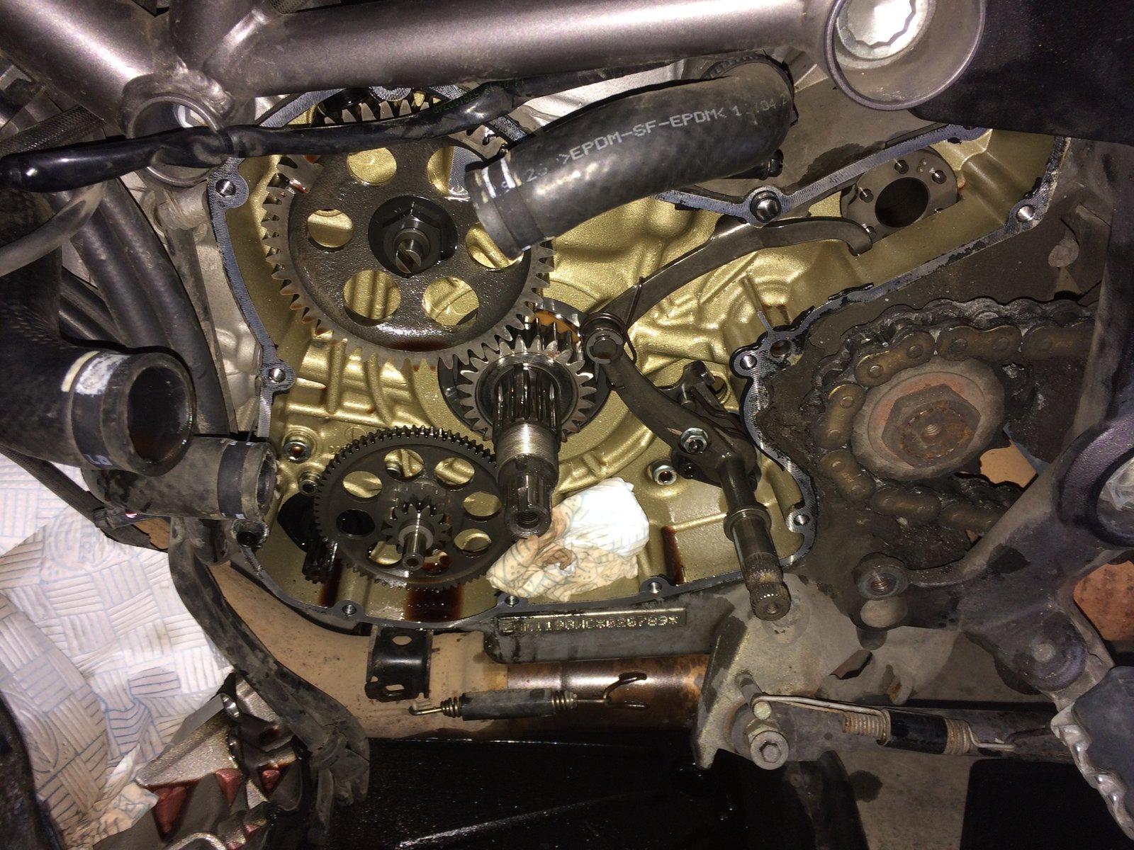

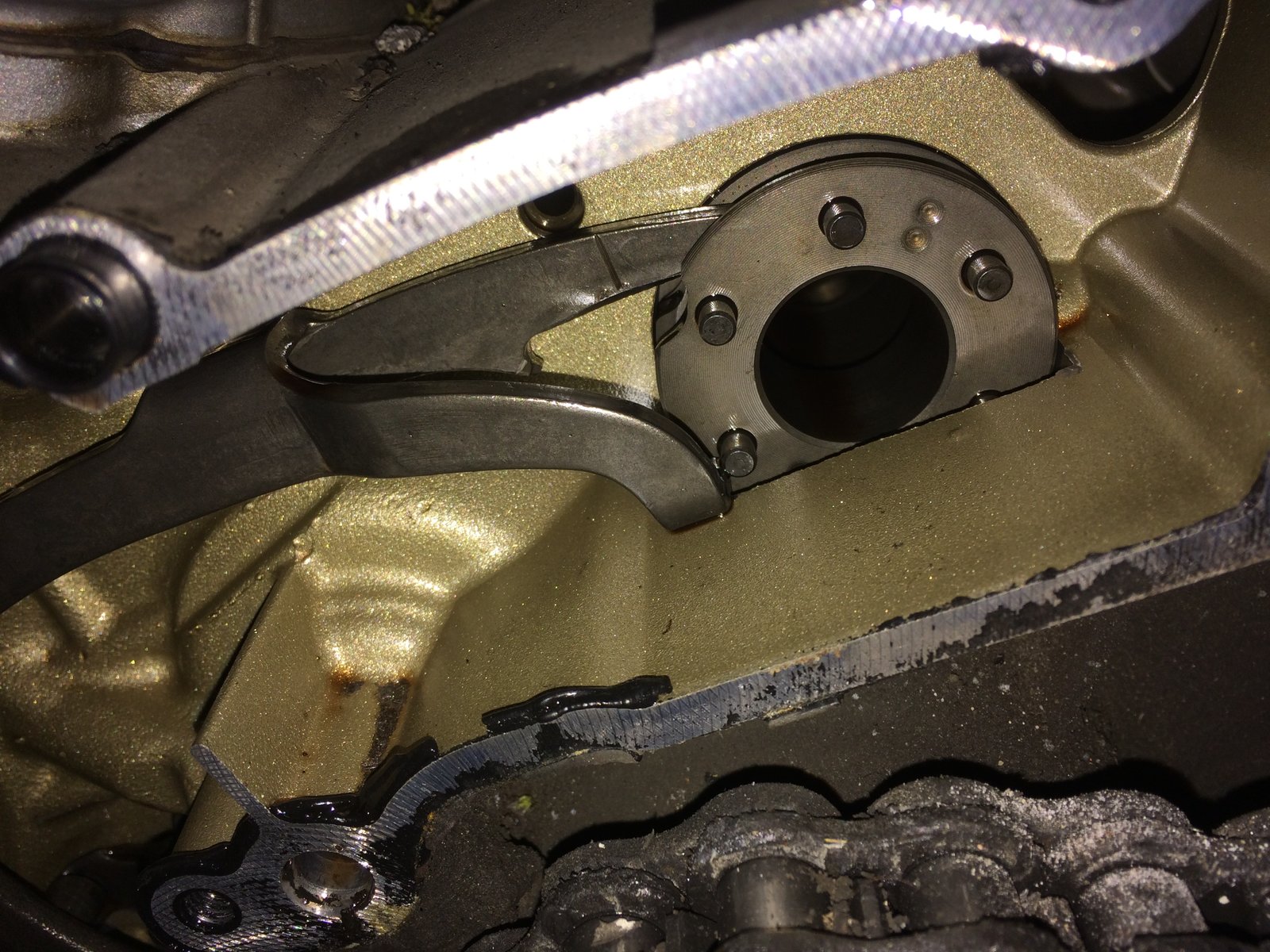

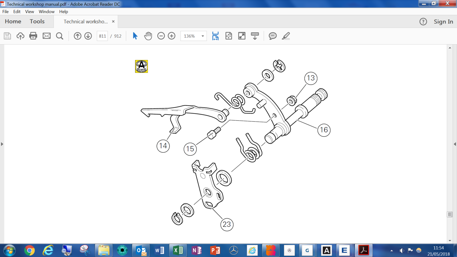

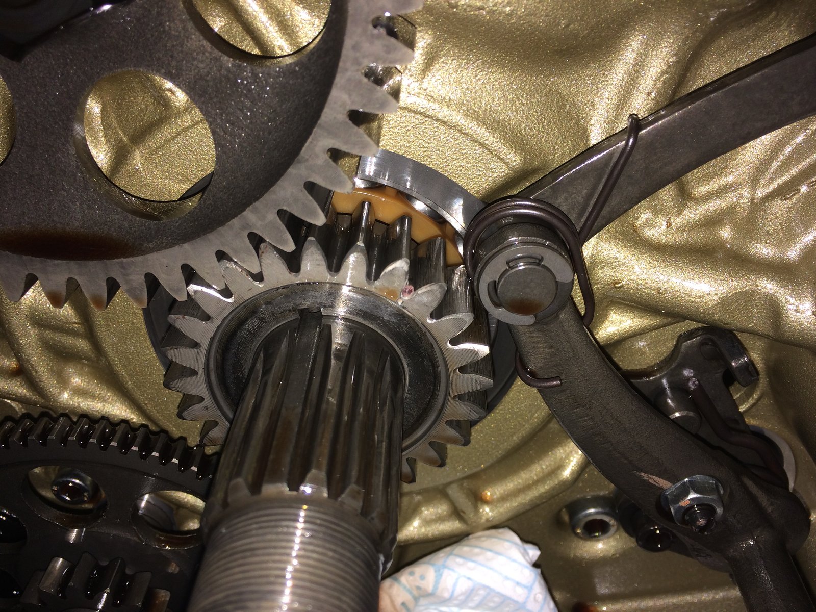

    Anyway, no broken springs, the selector arm was jammed between the gear & selector drum pin. Removed it and reset it and all is well.
    So what caused this:
    I adjusted the gear lever lower to where it worked best for me (standard position was seeing me get a lot of false neutrals on up shift). On a trip in France last year, I was being a bit spirited on a roundabout and the lever dragged on the floor-this caused it to flip 180 degrees backwards. The force on the shaft must have moved the whole mechanism on the two mounting bolts as it’s mounted via elongated holes to enable adjustment. It must have been pulled forward to max position that it happened to jam when changing gear. I’m just glad it happened here rather in the Dolomites in a fortnights time
    Now, does anyone know how to set up the gear lever mechanism correctly so I don’t have this happen again?

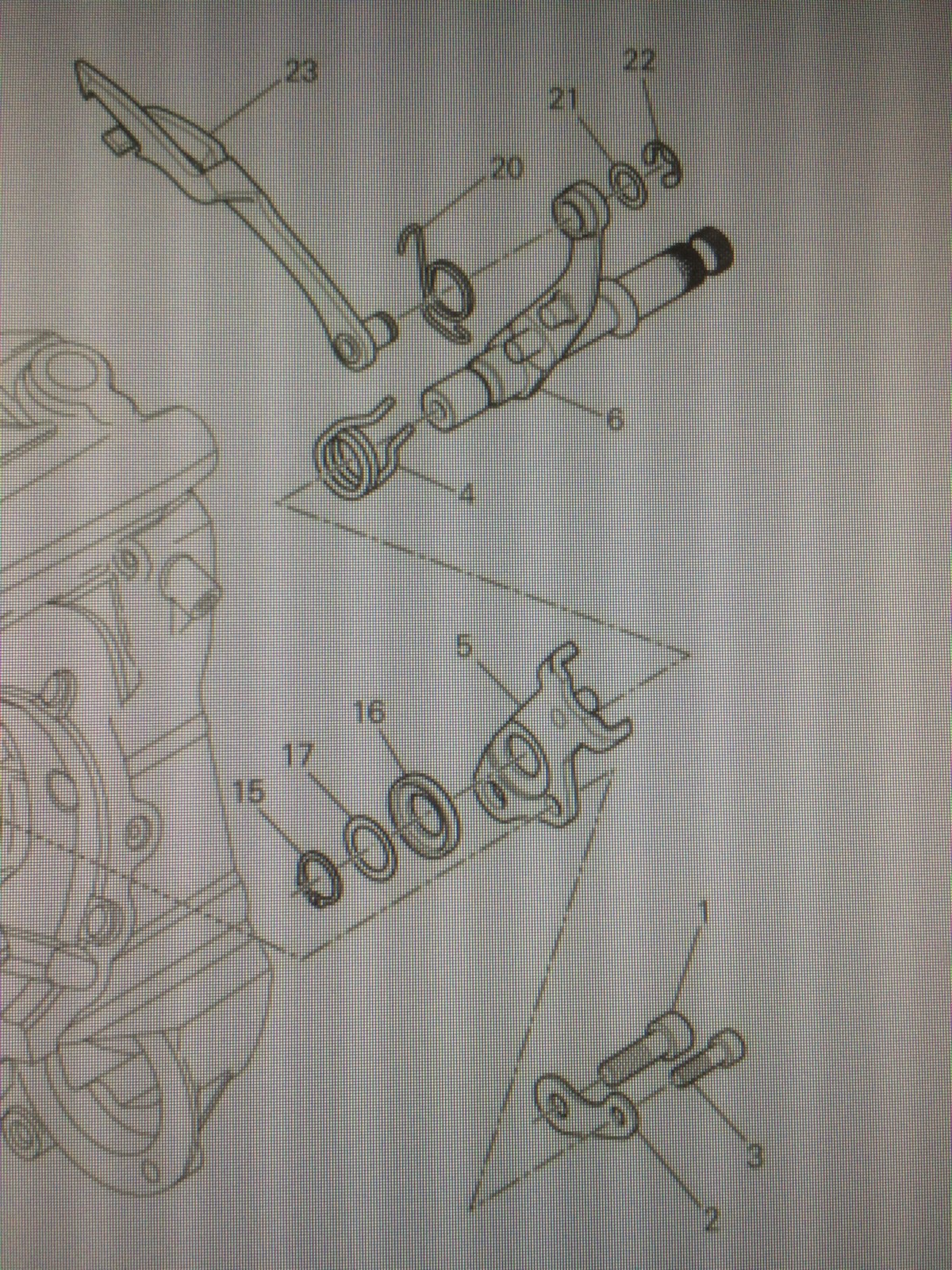

  10. while your at it Beef, make sure bolts 1 and 3 on my attached diagram are not loose (one M8, one M6) as has been known to happen particularly as you 'touched down' on gearlever.
  11. Thanks Chris, they were very tight but I will ensure to torque them correctly.
