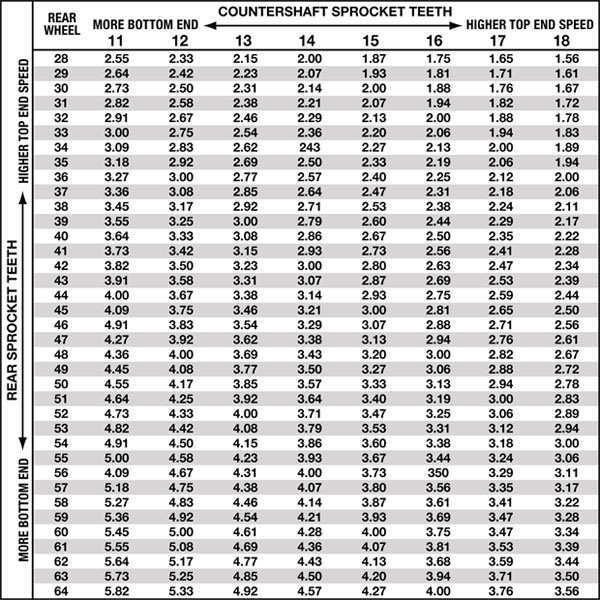

  2. Have a look a this chart. It’s the kind of thing we used whilst I was racing mx.
    Ruffly 1 tooth on the front worth 3 teeth on the back was what we used to go on but careful not to change your wheelbase too much as bike handling characteristics will change

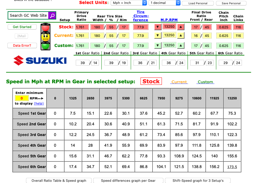

  4. gearingcommander.com
    Go one down on the front, suits out bikes at most tracks.

  6. down one on the front

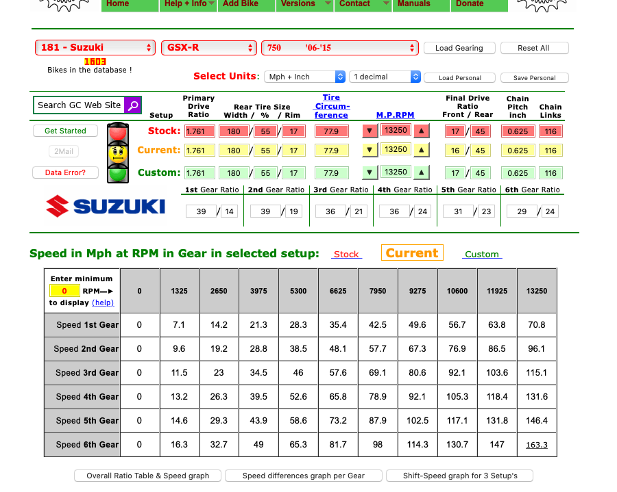

  7. Donny, GSXR 750 k8, dry, fast group (1:46 Donny),
  8. It's a good site, especially as it tells you if you need a longer chain.
  9. And difference with standard. IMHO you gear for the fastest part off the circuit to use almost all the revs in top. Unless its a small, 140mph max circuit, but again shorter gearing can help acceleration. But can get messy when it comes to mid-corner changes, hence most seem to drop one off the front then fine tune with rear cogs
  10. Not necessarily. Most road bikes (Ducatis especially) have sixth gear as a big jump from fifth to get good economy on Motorways. The danger is by changing the gearing (with sprocket variation), is the other gears will be too short. It depends a lot on which track you are thinking of. I would tend to lower the gearing but not worry too much if sixth is hardly used. Depends upon the track.
