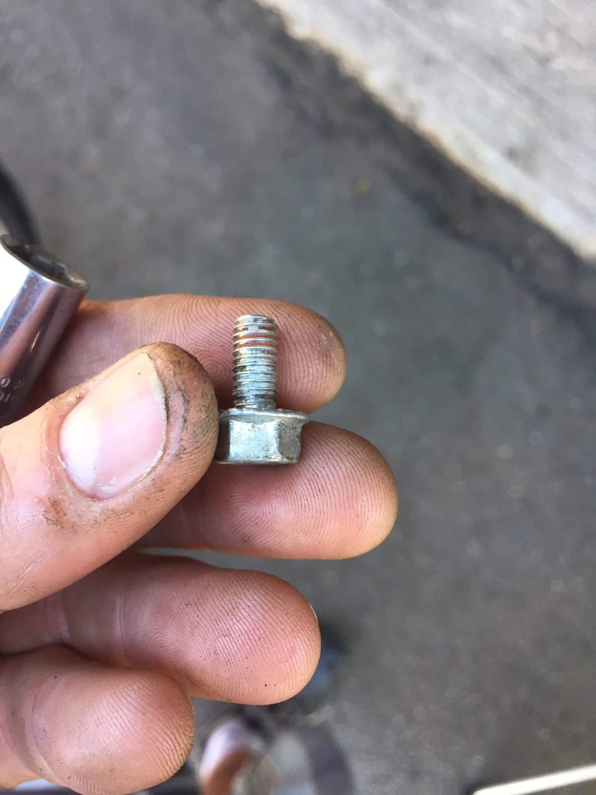

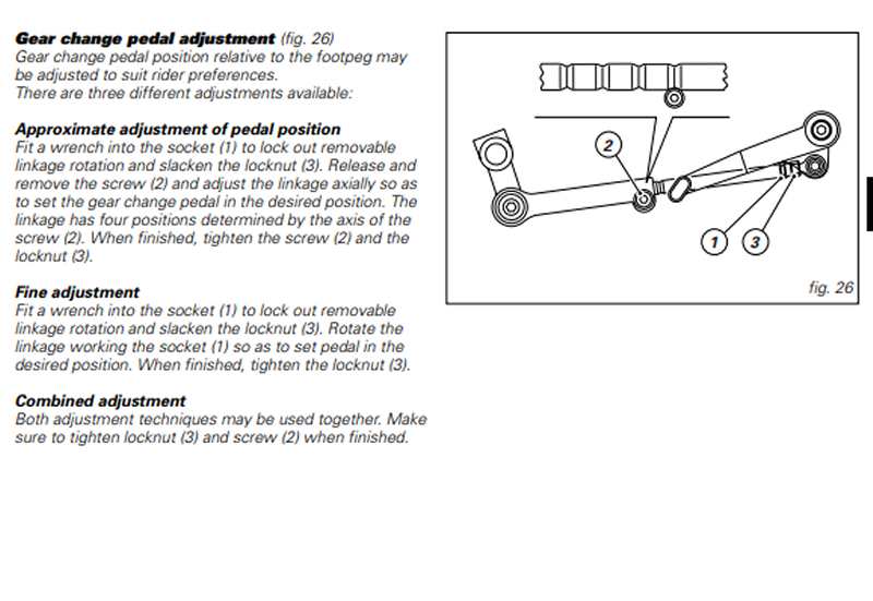

  1. Hi. I’m a week and some hundreds of miles into the ownership experience. Money well spent. I have a good nearly mint 2003 bike with a mono seat. Can anyone help me with some basics please. Is it possible to shorten the throw of the gear selector. I have moved the rod but it seems to keep the same throw but just move the entire thing up or down. I can’t get it to expose more than one of the supposed 4 adjustment points on the rod though even with the screw out. Also how does one get the mirror covers off. I need to respray them. Oh. And how far should it lean on the side stand. Mine has maybe 5mm clerance from the bodywork but the way the bike settles on the stand seems nearly unsafe. Are they all like that? How do I check it’s ok? Thanks so much!!! Ps anyone got a bolt like the picture. 10mm head, thread unknown. used to hold on rear single seat. One dropped out post a service

    I can probably answer 2 of the 3 questions, the tie rod will only adjust the gear lever position you can’t adjust the throw between the gears, maybe different selector forks or something internal. As for the lean angle the plate that the stand bolts onto bends over time, just replace the plate or as some have done at material to the bottom of the sidestand.

  5. You can get a bolt similar to that from Halfords or a fastener shop.
  6. The tie rod for the gear lever has four basic positions but can be used to fine-tune the position of the gear lever using the thread. It is my experience that the somewhat long throw of the gear change can be mitigated by setting the lever in the optimal (for me) position. It is worth getting this right, to avoid missed changes and false neutrals.

  8. if its a 10mm head, there's a good chance that by the look of the photo you're hold ing an m6x12 bolt :)

  14. Have a look at all pivot points and the spherical bearings on the tie rod. Excessive play can lead to longer lever travel.
    Better still, fit a race-shift lever, for direct gear selection.
