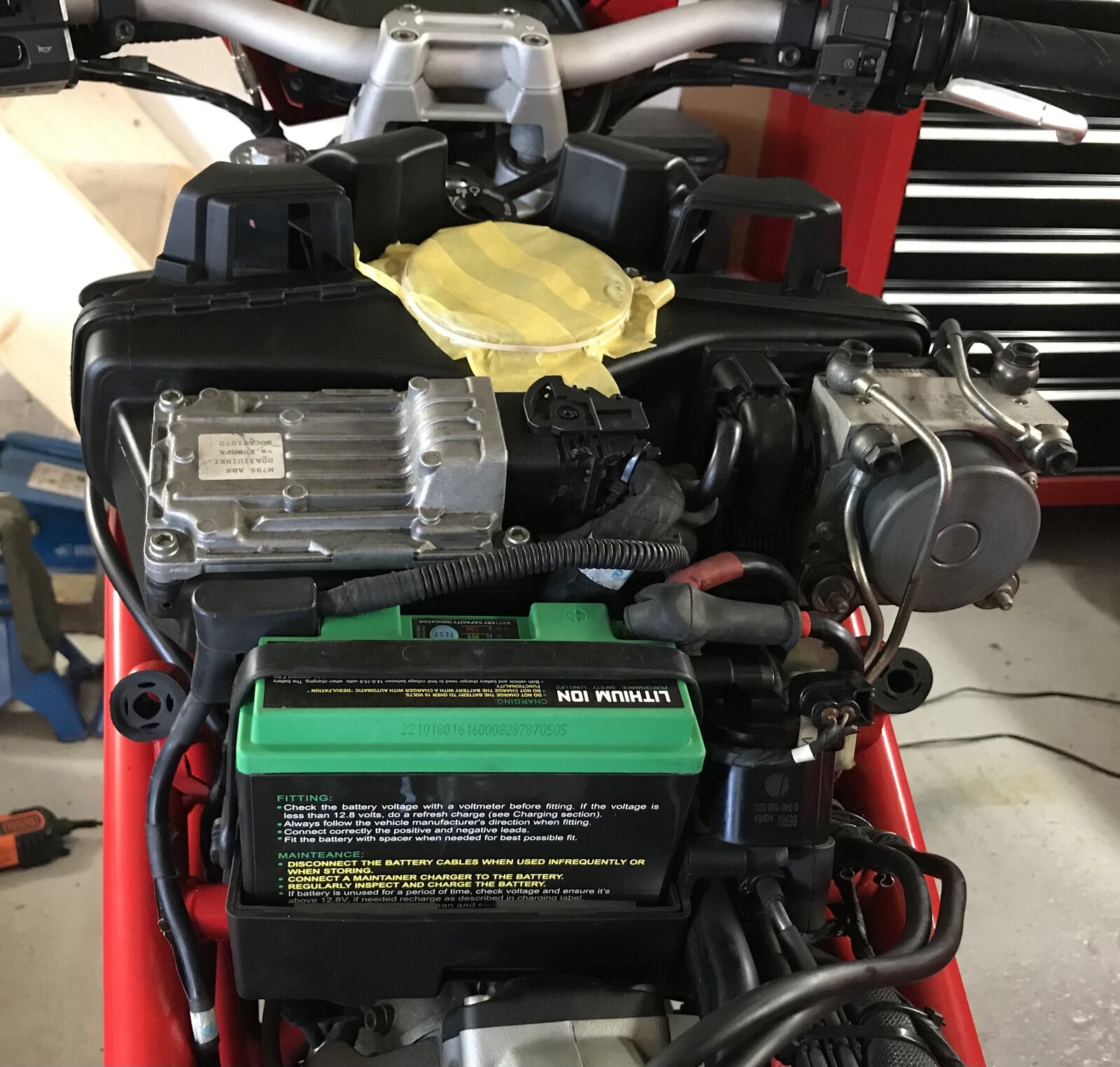

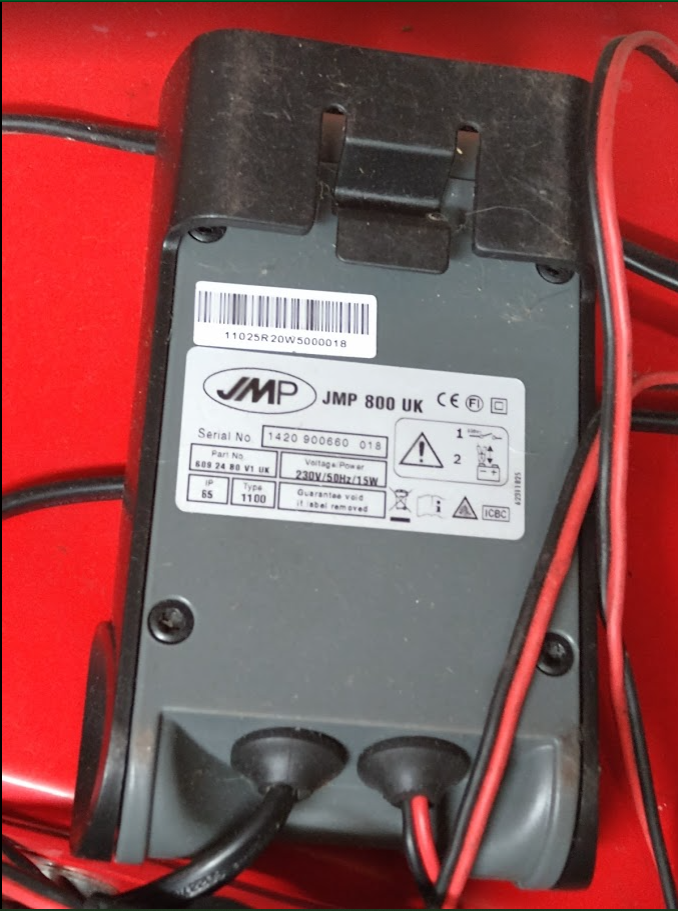

  18. I put a lithium battery on my S4r Monster. I always conne3cted it to a lithium specific charger because the supplier said that they would not warranty it otherwise. And then the bike got smashed up and I've no idea what happened to it. I still have the lithium specific batter charger but just not the bike attachment as that went to bike heaven with the bike. It would be easy to make your own battery attachment, or maybe the supplier could supply a spare. Free to anyone that wants t it if you just refund me the postage.
