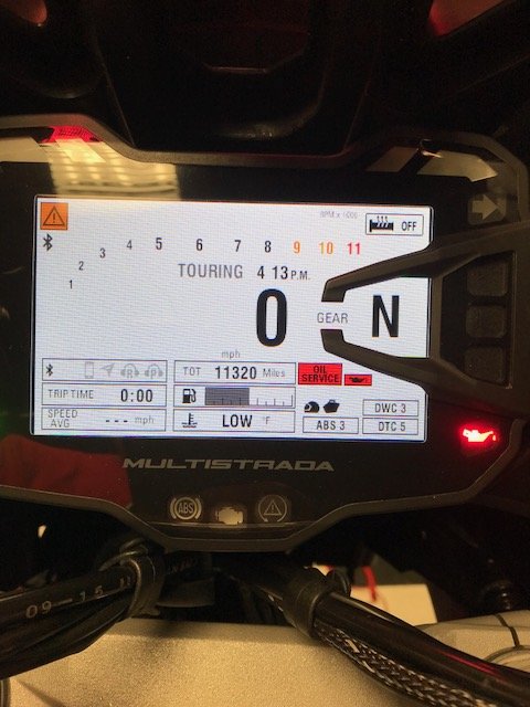

  1. Hi Everyone
    I was out this morning and had done about a 100 miles and I noticed the generic warning light was on (! Warning) in orange at top left of dash - bike was running fine.
    I slowed and pulled over - no other error lights at all on.
    Turned off the power and back on still there.
    Did that a few times - still there.
    Then carried on a mile and stopped and had a coffee in a near by lay by and then restarted bike - still had warning light on - pulled away - still on.
    Rode 2 minutes - tried back break - light went out as I pressed rear brake.
    I know earlier in the ride I had had 2 brake hard twice - (Rabbit and Police) and had had cruise on at one point too.
    So anyone any ideas.
    Light stayed off the last 25 miles home and after a few power on and offs in garage too.

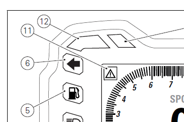

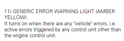

    The warning light was - Item 11
    But I had no other warnings or messages.
    It was not the Hill Hold H indicator..
  4. Looks like it picked up an error but now cleared
    What's the reset procedure?
    The dash is unusual, not saying it's this but I had a battery issue with my key fob, maybe worth changing the battery. I always keep a spare under the seat now, good luck, keep us posted
  5. I spoke to dealer - he did not know - so its booked in for the 20th - earliest date I could do after today.
    He said only way they can tell is plug it in and see history - but neither problem is normal.
  6. My 2015 the dash will power itself down after awhile. If the bike sees an error, it will reset light after so many miles/power cycles if error not seen again.
  7. When I had that, it was a rear brake sensor. Didn't affect performance but meant rear abs (!! like that works anyway ;) ) may not have worked
  8. I have had this a couple of time, it was always crap from the road stuck to the front or rear ABS sensor
  9. Bike has been in garage for just over 2 weeks now for this and a noise and a vibration.
    The warning was either from a front wheel sensor or a rear wheel sensor - both errors were stored in the memory and have cleared.
